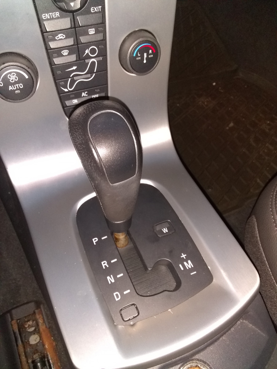

I installed a new shifter gate blind. The original one cracked into three pieces and I was worried that dust and stuff might fall inside the shifter. To replace it, you have to remove the center control panel which covers the shifter also. It was a breeze. There's 2 bolts on top and two just behind the cigarette lighter bezel. The radio display unit just popped right out. The shift knob came off easily; just push the ring on the bottom down and the knob pulls right off. The shifter cover was a little delicate and I was lucky none of the retaining clips broke. Once the shifter cover was off, the blind just lifted right off. It was an easy job: probably took me about 45 minutes.
