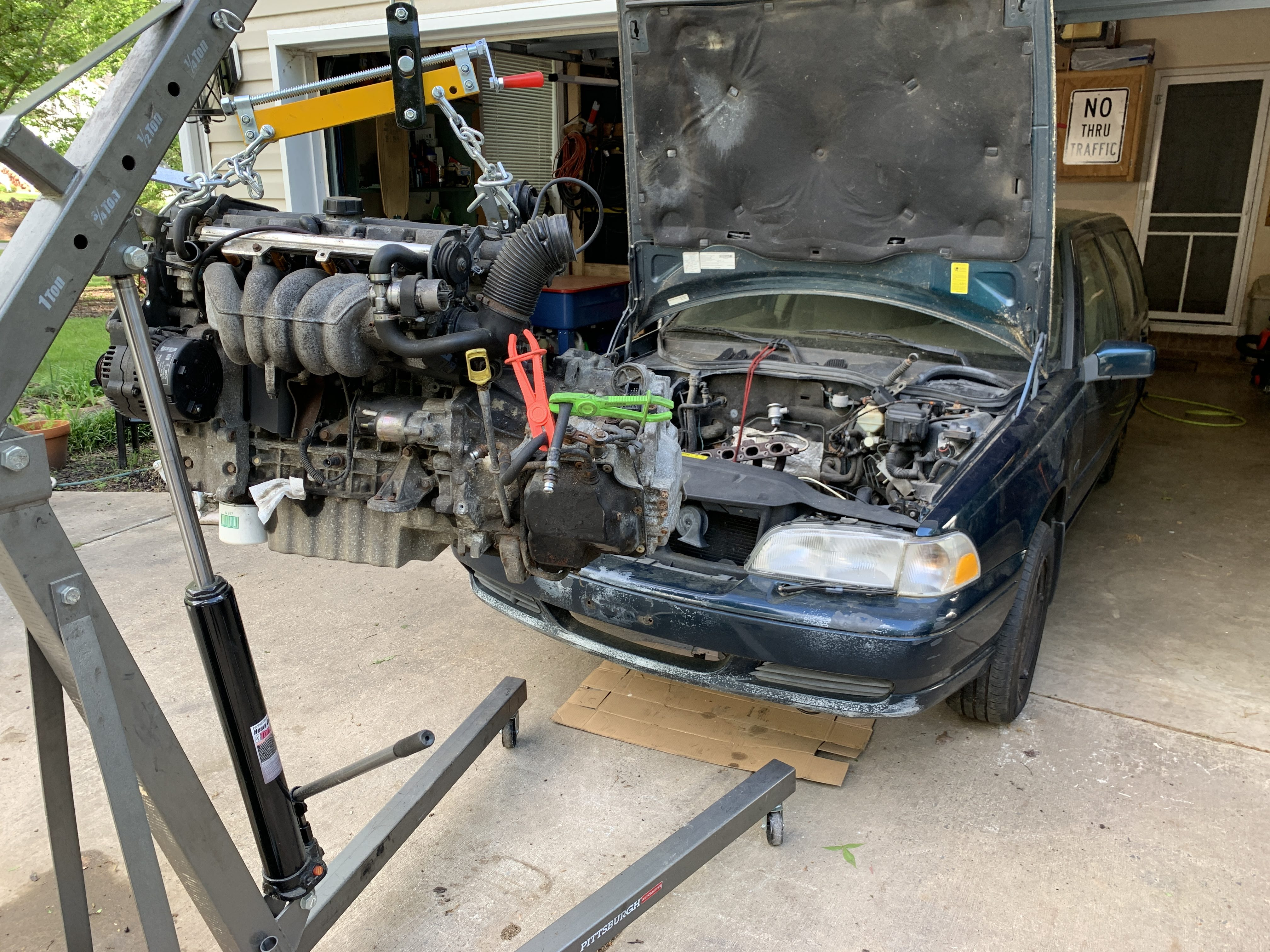

Looking good! Now maybe I can find the time between dropping the engine into the tropic wagon to get my dad's Bavarian money waster figured out!

Dropped the engine and trans back in yesterday, now today I'll get everything back together and hopefully have it running by the end of the day. Maybe I'll also get to putting the new speakers in my 940 and reflashing the ECU on my dad's X3... lots to do!

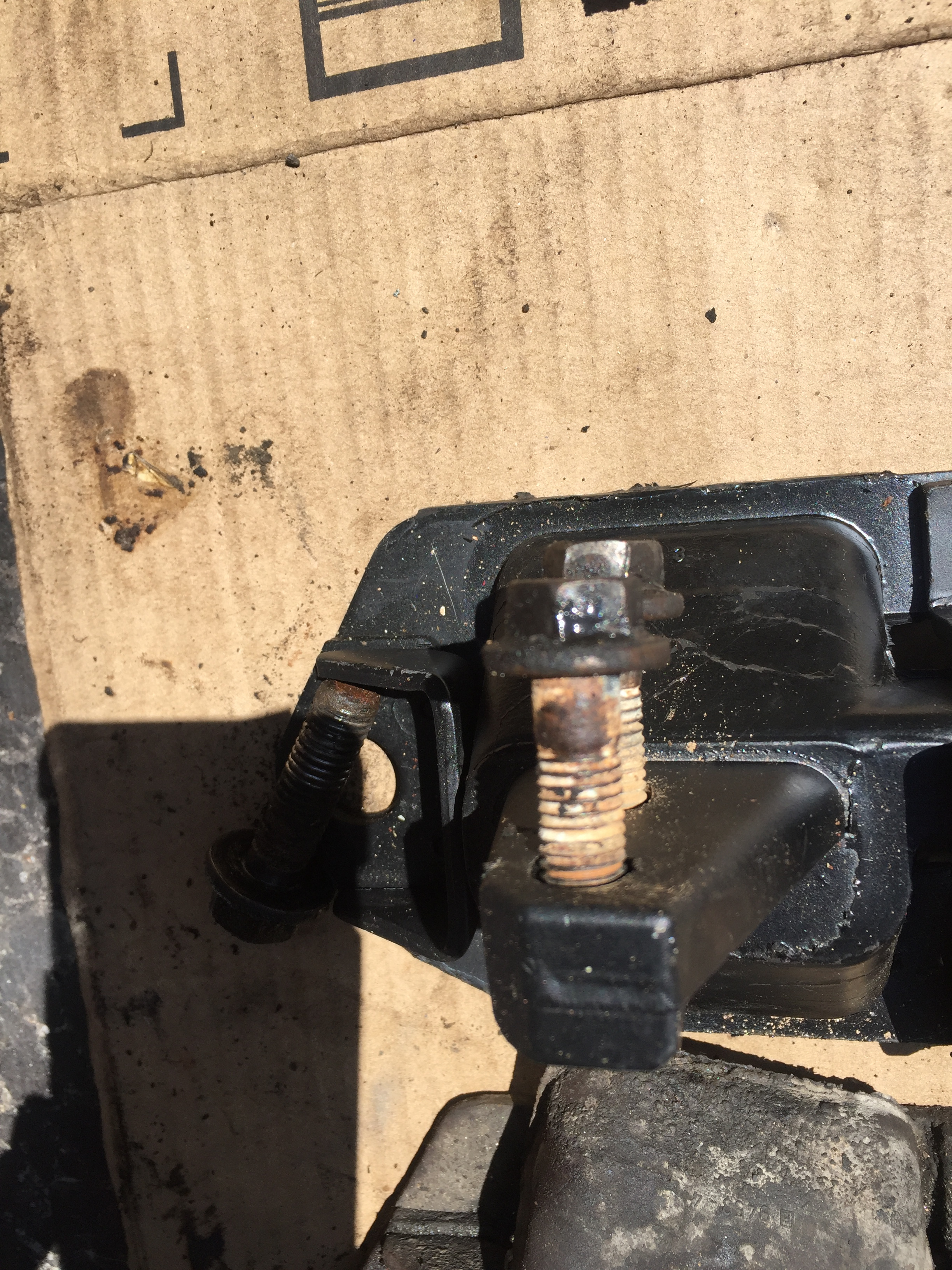

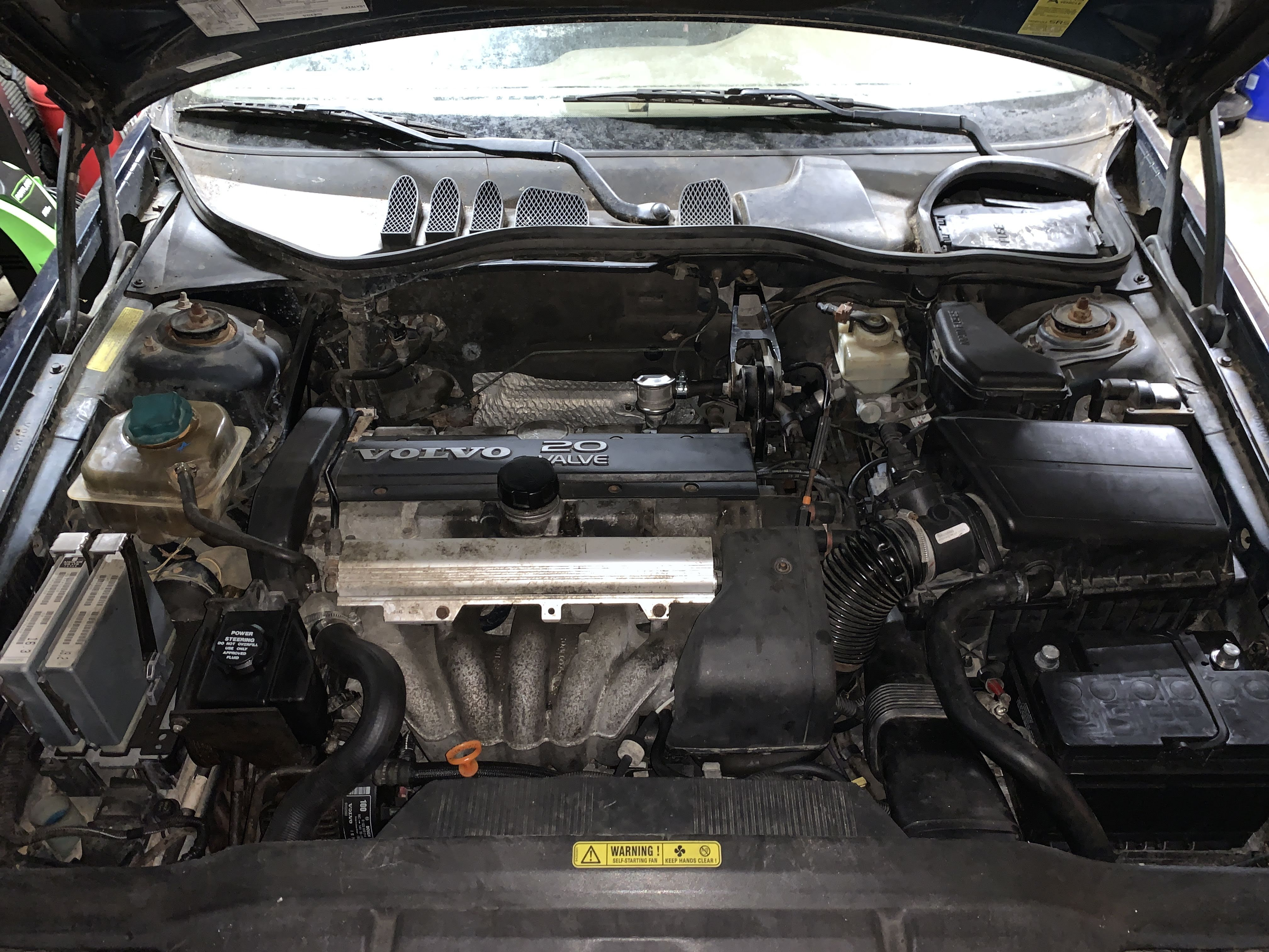

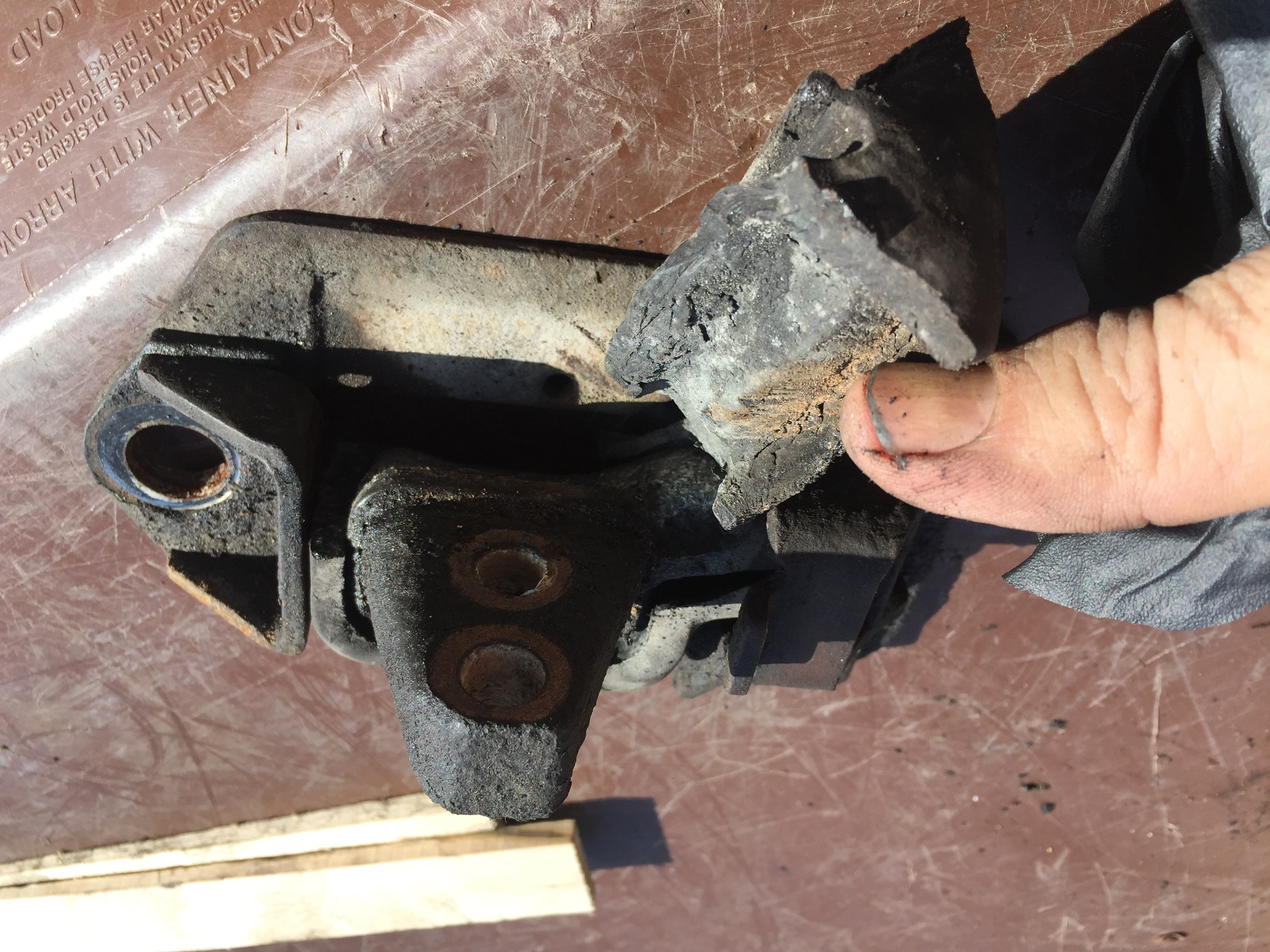

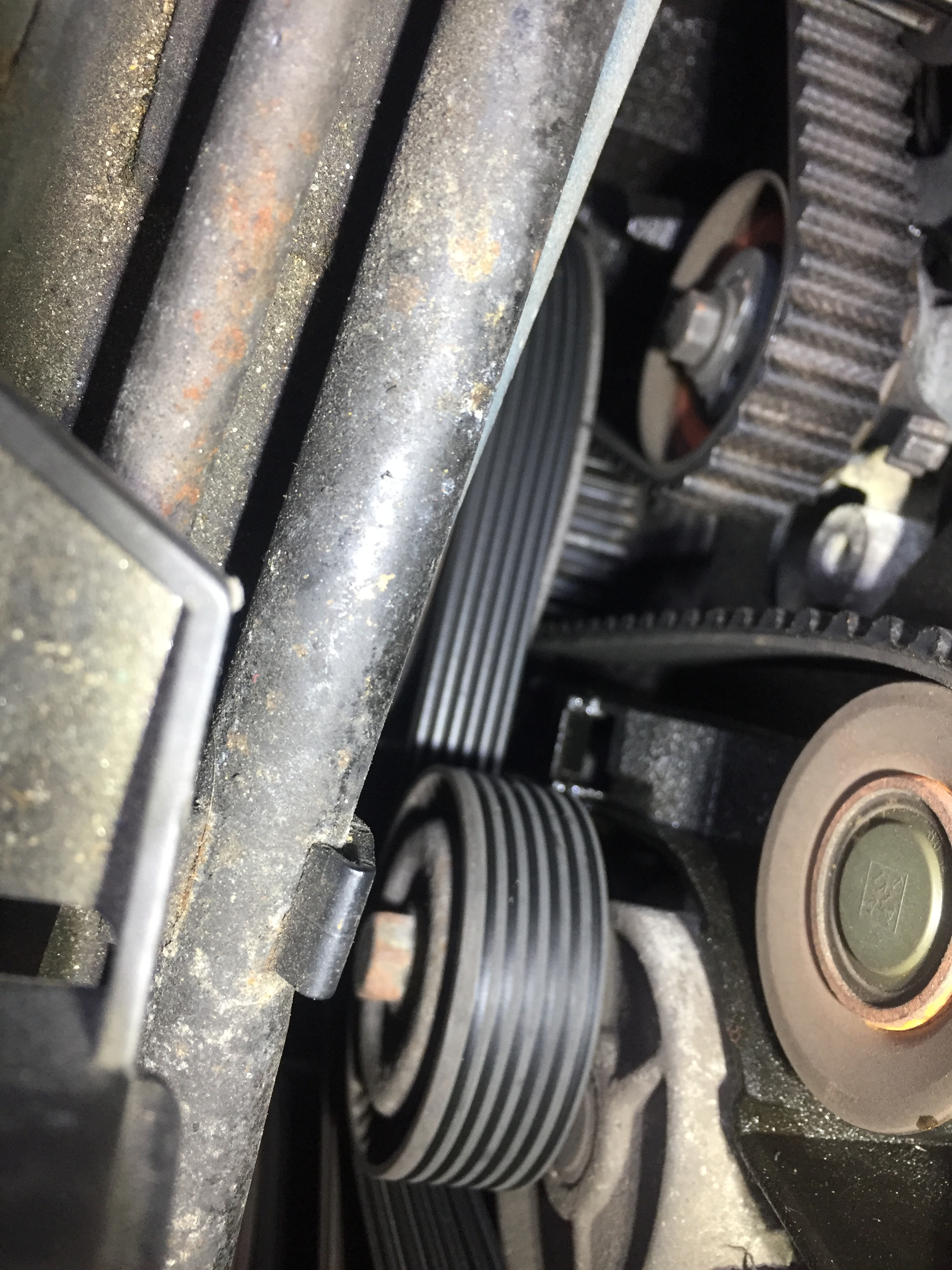

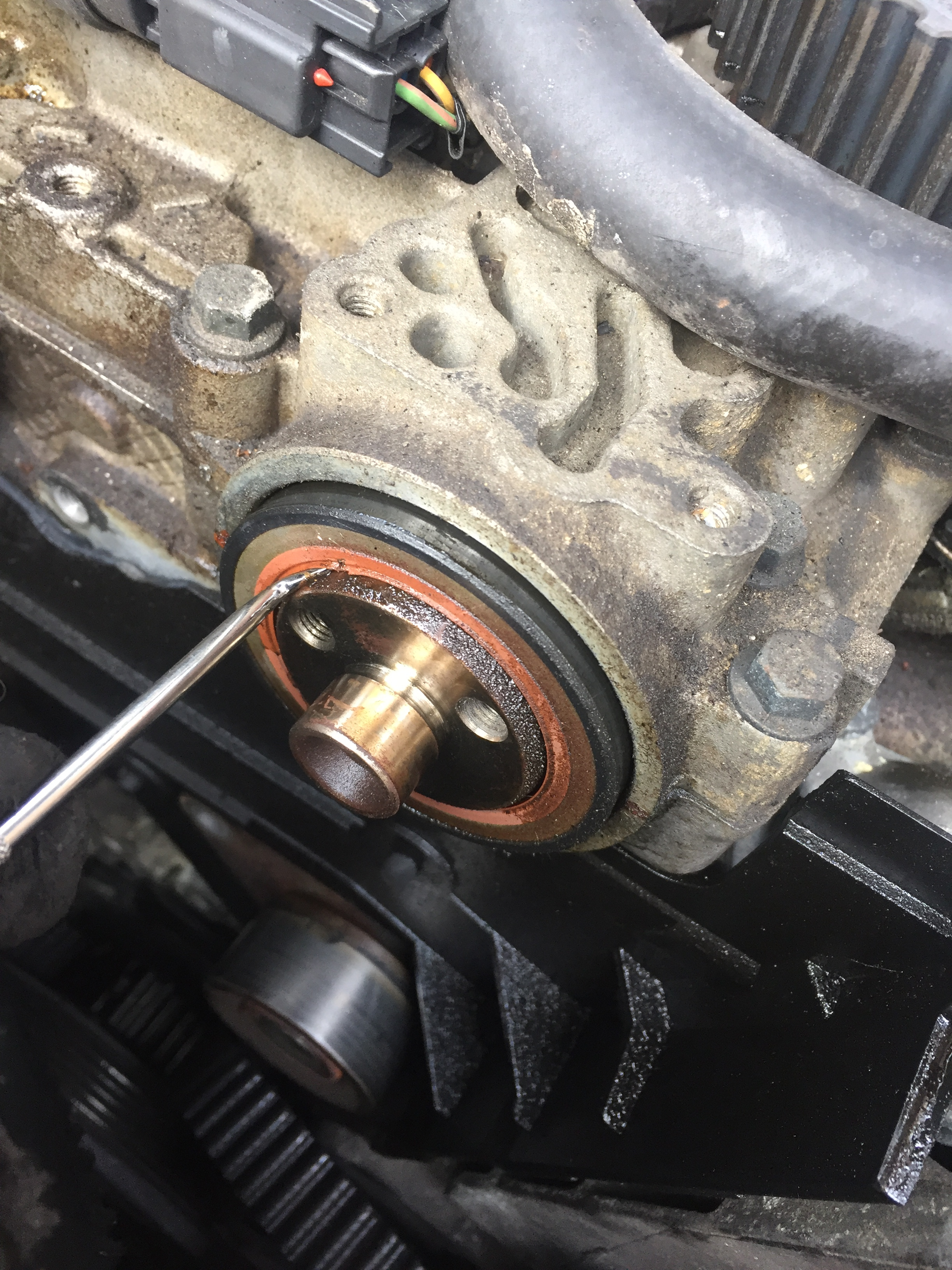

I wrenched on Elizabeth the 1999 T5 all day today. Got all the timing belt off four intake cam seal leaking slightly. By chance I had ordered a spare for Elvita as she has a slight seep too
Found a broken front motor mount and had that instock too!! Four bolts were horribly frozen and they took three hours to get out.

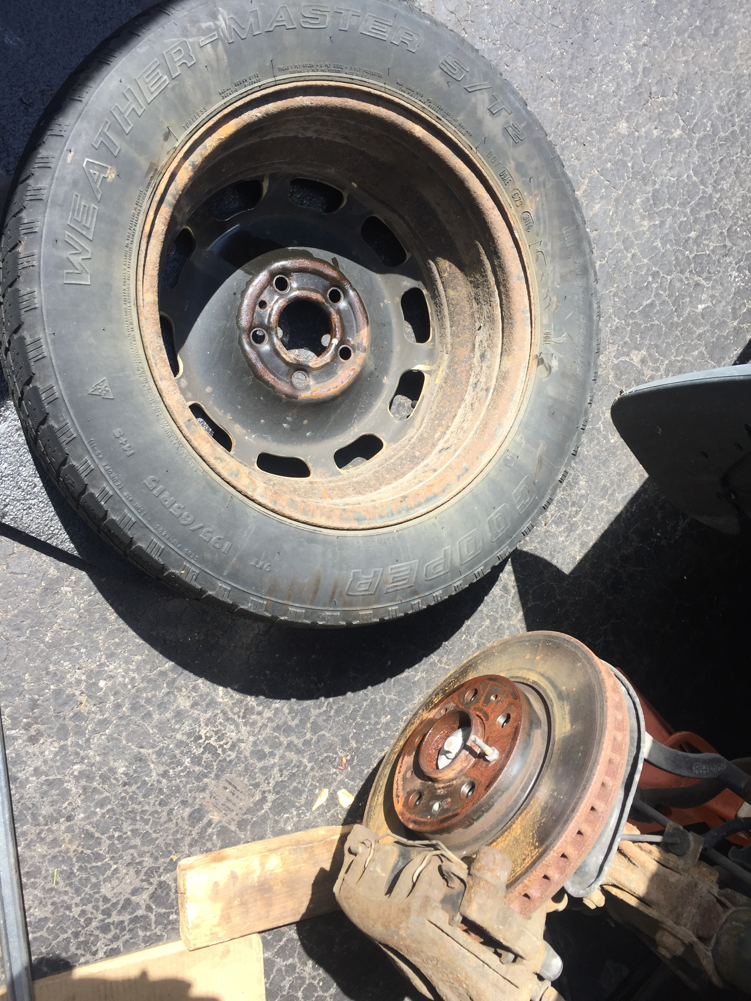

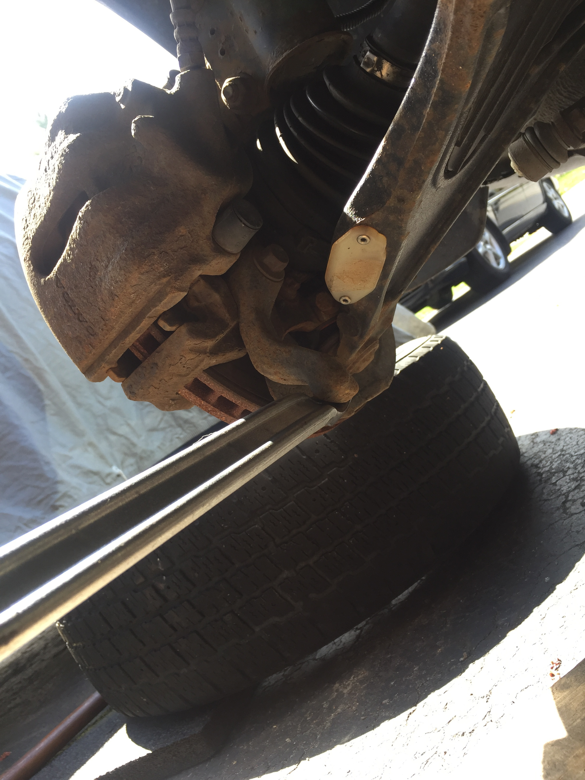

It took me an hour to get the right front snow steel wheel off the disc too. Bad rust. I ended up using a tire iron on the steering stop to pop it free
Water pump came out in easily. Access sucks to those bolts. Old one with 250k on it is in good shape , one small rust spot ; bearings firm
Still have to finish and replace clutch switch
Used motor mount for sale

Fluid Film (lanolin) is my new favorite miracle in a can. Spray and wipe rotor/wheel contact faces each before mounting, and unlikely to have a similar problem next Spring.
A little wiping with a FF-sprayed paper towel will sweep away a lot of light surface rust as well. Might consider that before you put the steelies away for the summer.

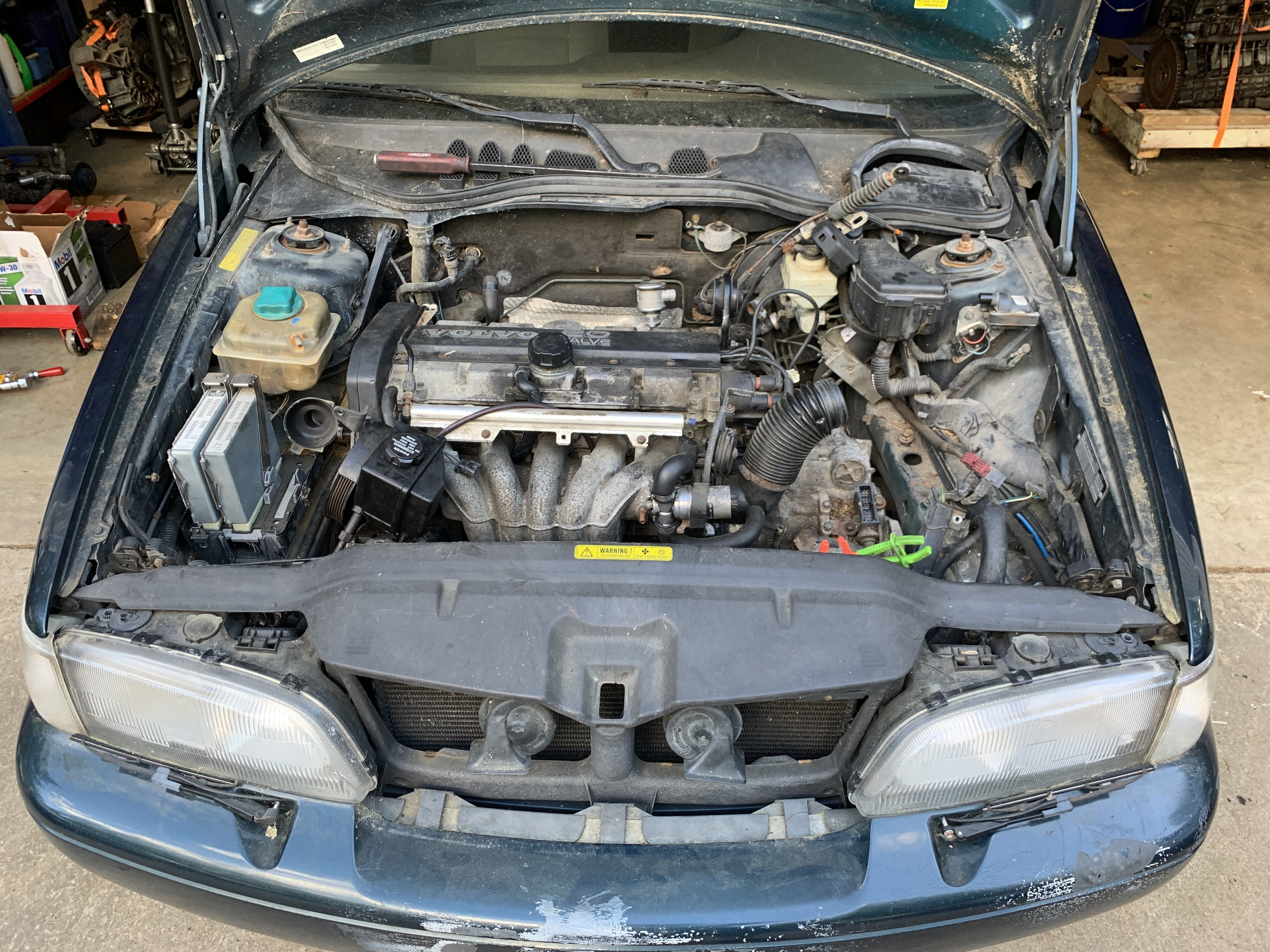

90% done... just waiting on some ATF and an axle from the owner, and I'll be able to wrap this car up finally. I've gotten it done pretty quickly given that I've only actually spent 3-4 days actually working on it. Took a little time off over Easter, but I'm happy to finally get this car wrapped up and get back to my other projects.
I also need to do a heater core firewall junction bypass since a heater hose was knocked loose while dropping in the engine... fun!
