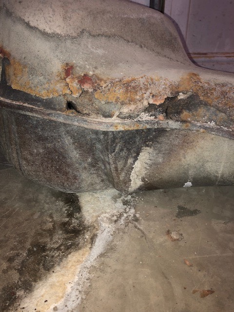

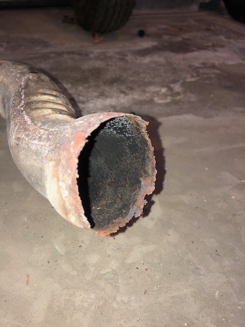

Changed the muffler and resonator pipe today, my car was starting to get a little noisy over the last couple months. I used Walker products for both although the muffler was manufactured by Starla and relabelled Walker. Both appeared to be good quality parts and installation and fit was straightforward. I used stainless bolts for the resonator to cat pipe flange. The pictures below show fairly typical failure of the muffler with cracks and holes, the resonator pipe was in mostly good shape with rust failure only at the clamp area where it joins the muffler. Not bad for 21 years and 320,000 kms.
