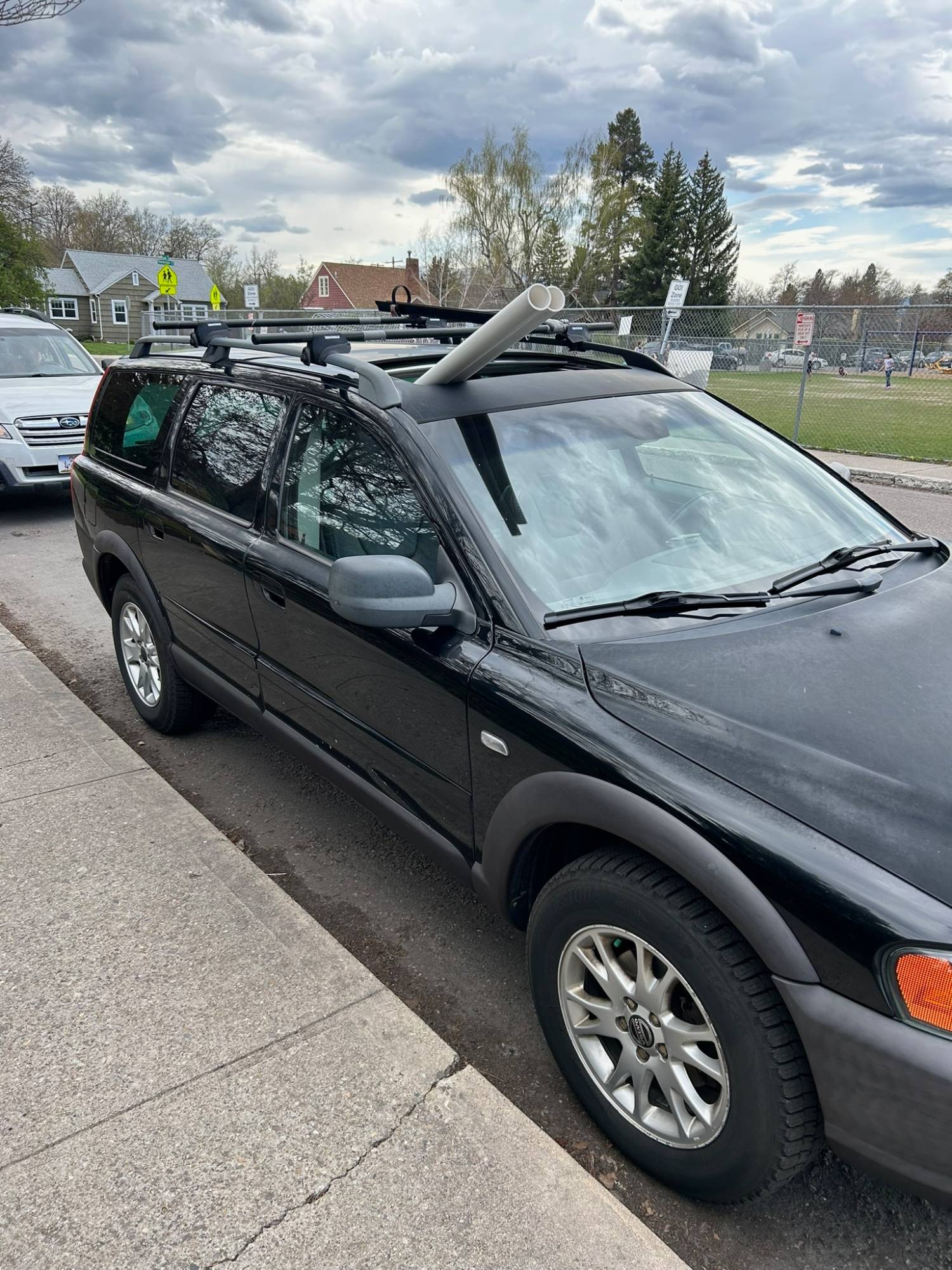

My Ace Hardware 10' double barrel rocket launcher.
I'm sending it to Ukraine.

BlackBart wrote: 30 Apr 2024, 13:07 My Ace Hardware 10' double barrel rocket launcher.
If I remember correctly, 10 foot long small section parts like this can fit from DS rear corner to PS windshield area without open doors or the sun roof.
Extra MVS points for full use of sunroof for hauling.

volvolugnut wrote: 30 Apr 2024, 18:11
8 foot 2x4. Maybe a tad longer, but we do not want to scratch anything, right? ;)

I use moving blankets and top racks to move stuff as I live in fear of w/s breakage from long stuff inside.
Double MVS points for the rocket launcher
