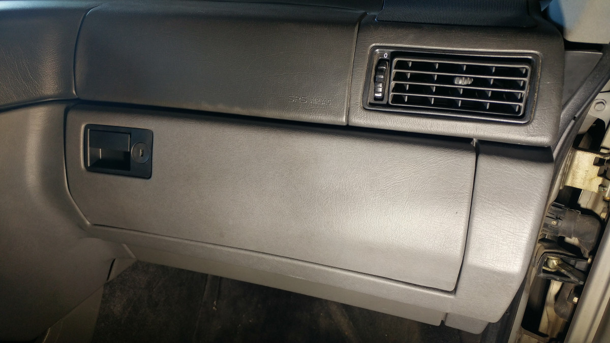

Fixed my flopping glove box door. Had to reinforce the areas where hinges attach to the dash. Plastic just disintegrated. Not the best of designs.
Ended up using small pieces of exterior composite house trim, epoxied, and pre-drilled. Now it's stable enough to hold more than it will ever need to.
And it might even be a little bit quieter....

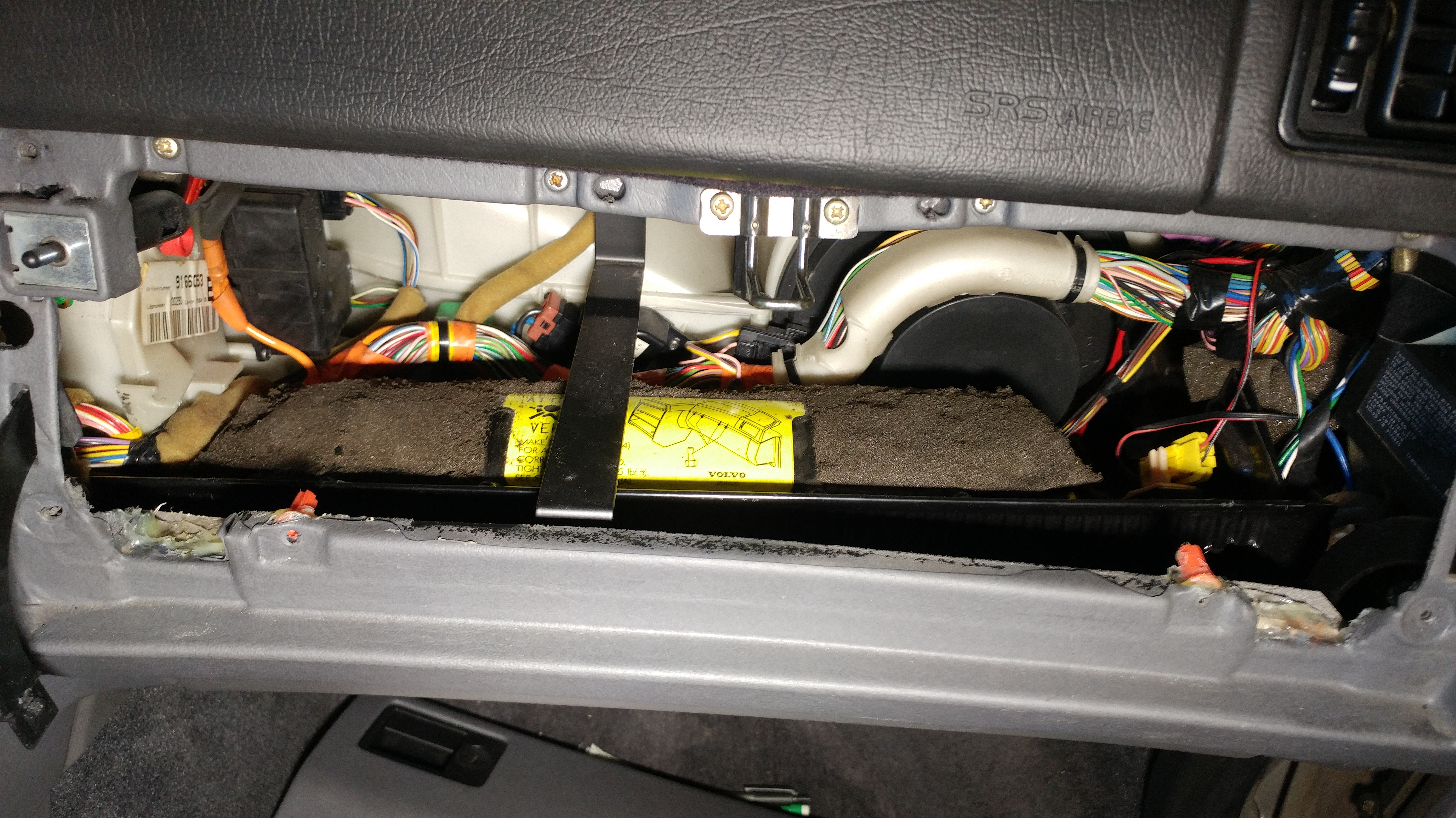

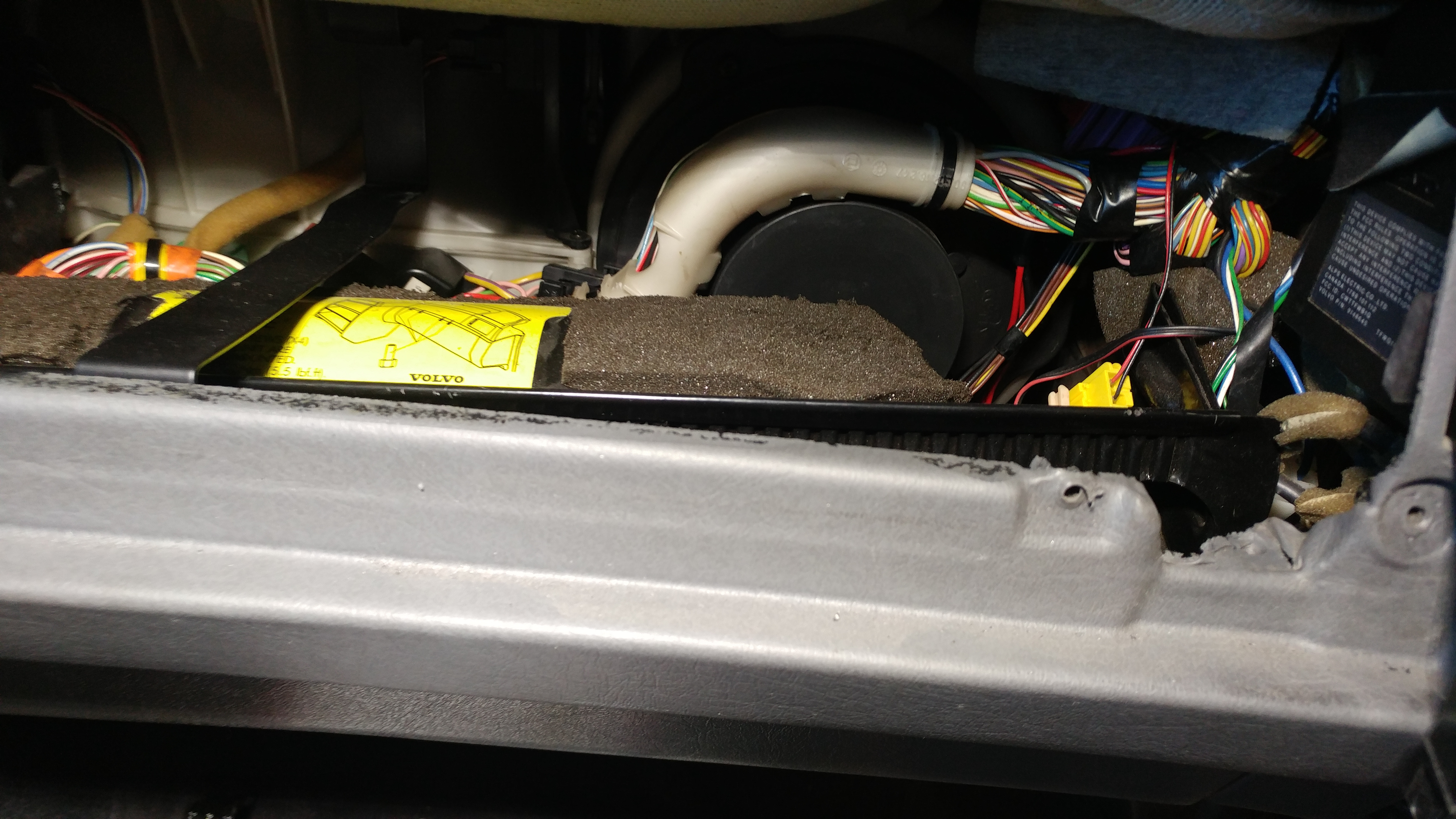

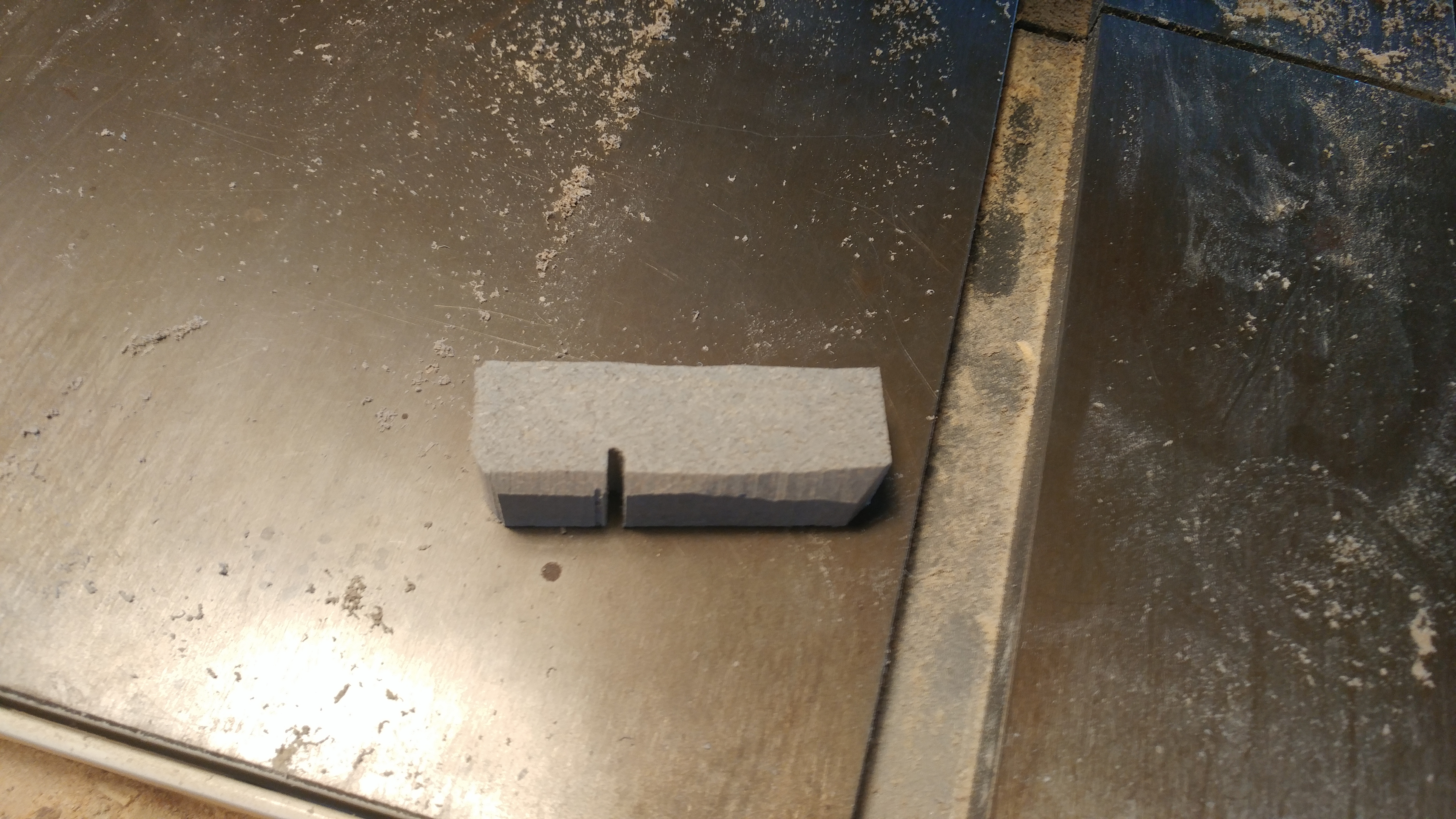

Well after taking it for a test drive, I can say that 95% of my dash rattles are gone ! I was sure that the issue was the main dash mounting bosses, but apparently the glove box area was the bigger problem.
I took a few pictures while I was doing the work, but they're not particularly good.
1st is where the glove box door should have been hinged on the right side. All the plastic was gone, so all that was left was the leather type material with the two slide nuts attached. In pic I had already cut that material away.
2nd is the sort of block of composite material ( think Trex ) that I cut to epoxy in place for the hinges. The saw kerf is so the block can fit over the plastic cast gussets inside the dash area. I could have cut the gussets out, but I decided to keep them instead. Chamfered edge is just so it fits a little tighter to the plastic. Epoxy was made for plastic. Color matching not required, but recommended.
3rd is after the hinge blocks were epoxied in place. I also repaired a couple of the box mounting screw posts that were broken or missing. The one on the right was half gone , so I just tried to capture what was left so the screw would hold. One on left was completely gone.
After epoxy dried, I filed it flat, pre-drilled for the hinge screws and put it all back together.

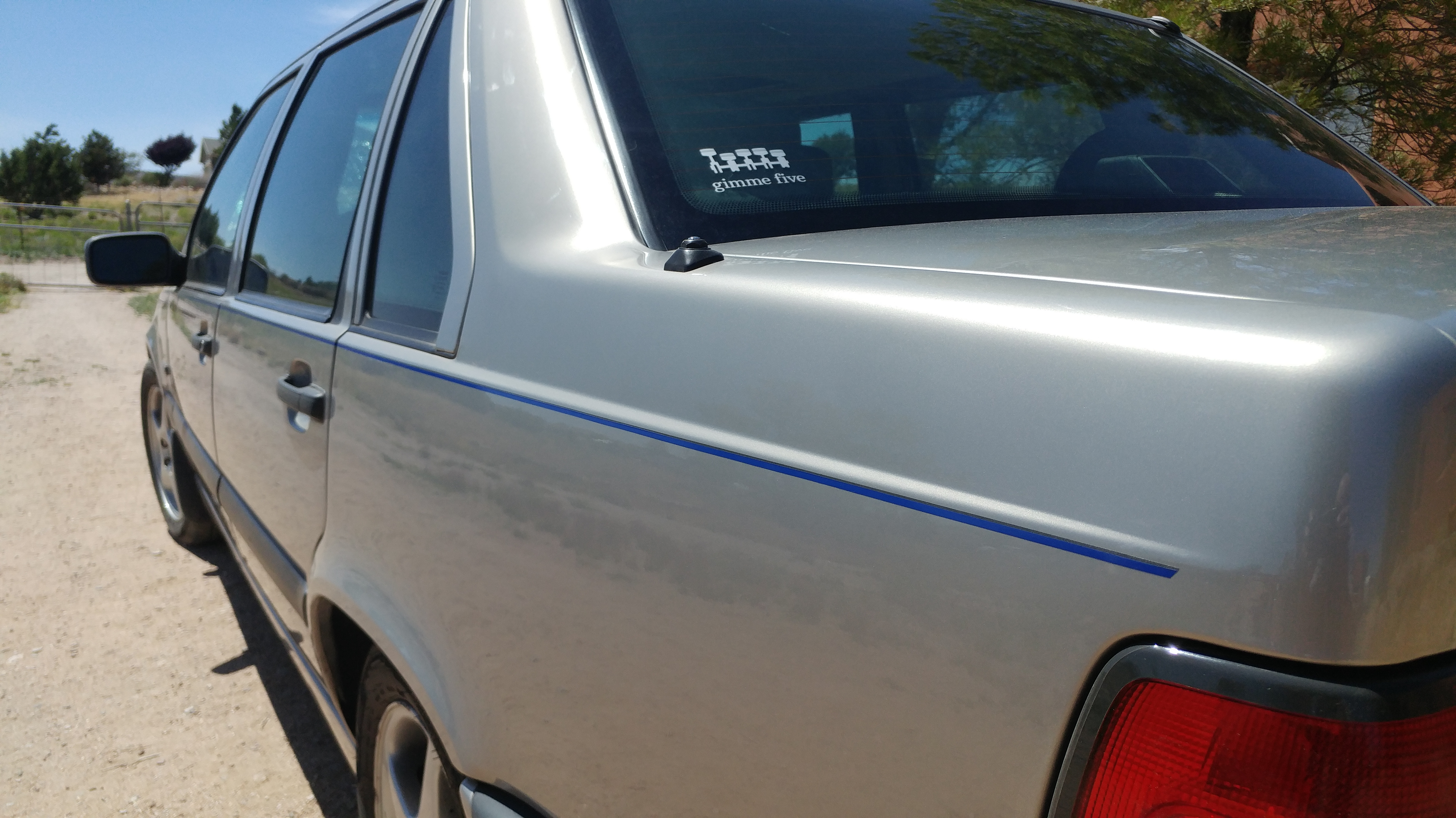

Figured that after doing some interior work, that the exterior needed something, like maybe a little color.
So 1/8" blue pinstripe seemed to fit the bill.

I like itSveedy wrote: 25 May 2020, 16:18 Figured that after doing some interior work, that the exterior needed something, like maybe a little color.

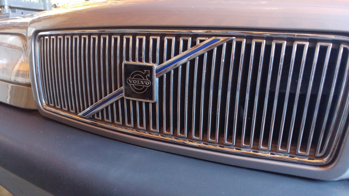

like the stickerSveedy wrote: 25 May 2020, 16:18 Figured that after doing some interior work, that the exterior needed something, like maybe a little color.

Thanks smacknab. From about 5ft. away it all but disappears, but it is the closest to Volvo blue I could find.
Kallekula - A member on here sells the stickers. " sigg " if I remember correctly. You can look him up.
