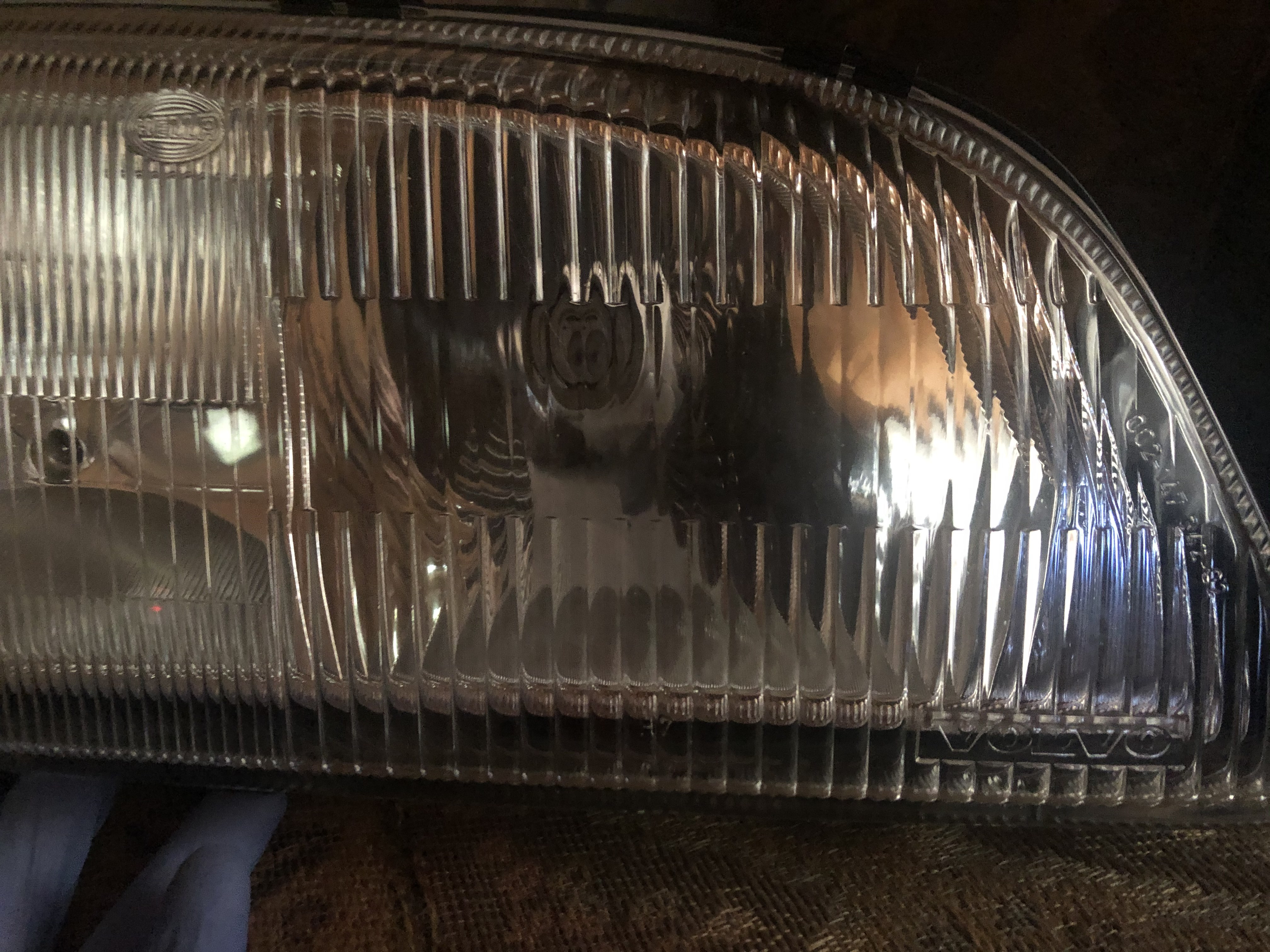

Thought I would start posting a few pictures of my upgrades or refurbishing I should say on our 2000 C70 Convertible.
I came across a really great deal ( $125) on a basically new looking set of OEM Volvo Headlamps and corner turn signal lamps,
they look so nice after installation.
I upgraded the bulbs to PIAA bulbs for the low beam,boy can I tell a difference,they are brighter and more crisp white color.

Wow, those headlights look brand new!
