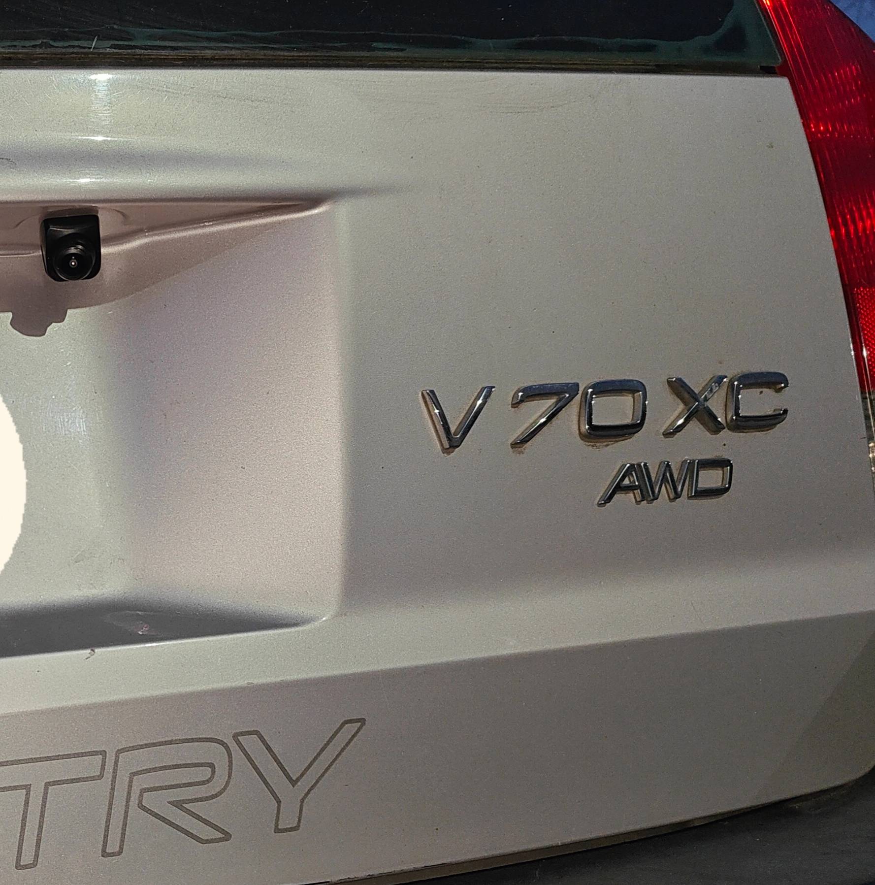

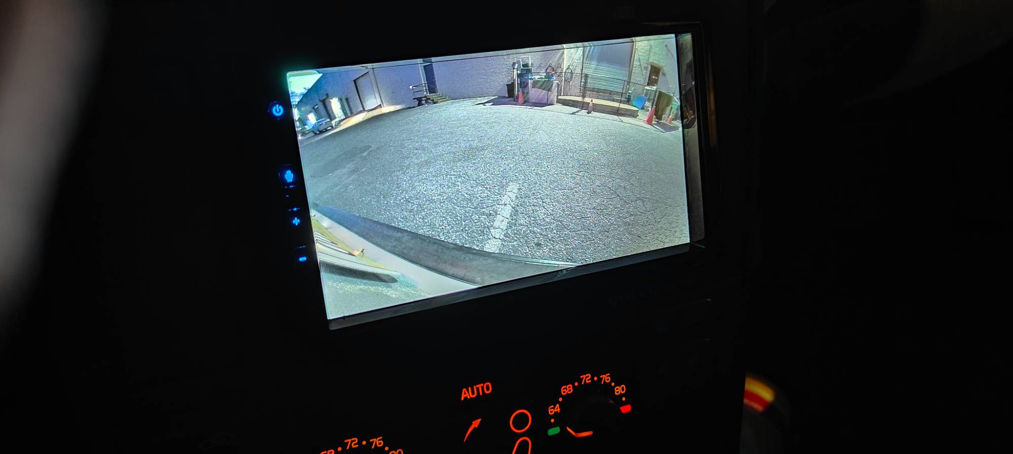

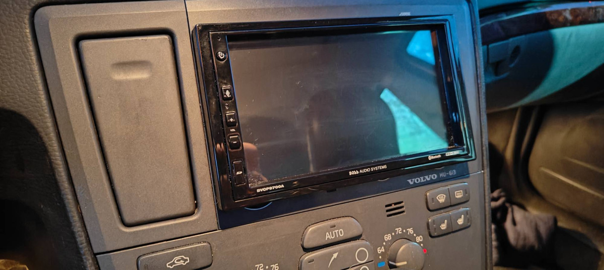

i plan to get one of those dbl din radios.lrock wrote: 03 Nov 2024, 15:37 Finally finished aftermarket audio integration complete with backup camera

it's a pretty easy job, the stock radio is already double din behind the faceplate. the most time consuming for me was cutting faceplate to the right size. cut it small and snuck up on it by file
Oh, and running the camera wire through the existing plenum under the carpet took awhile.

not pictured is the double usb port that i got for the carplay/android auto usb and device usb for the head unit, it was a happy accident, but it fit the spot for the 12volt plug perfectly after i popped that out. I would suggest gettiing a unit that is based on android, so you can pull up a blue tooth obdII scan tool on the screen, get one that takes a sim and a cheap mint mobile plan or something and you can just use that for nav/music/etc rather than connecting to your phone. That's what i'll be upgrading to in the not too distant future.
