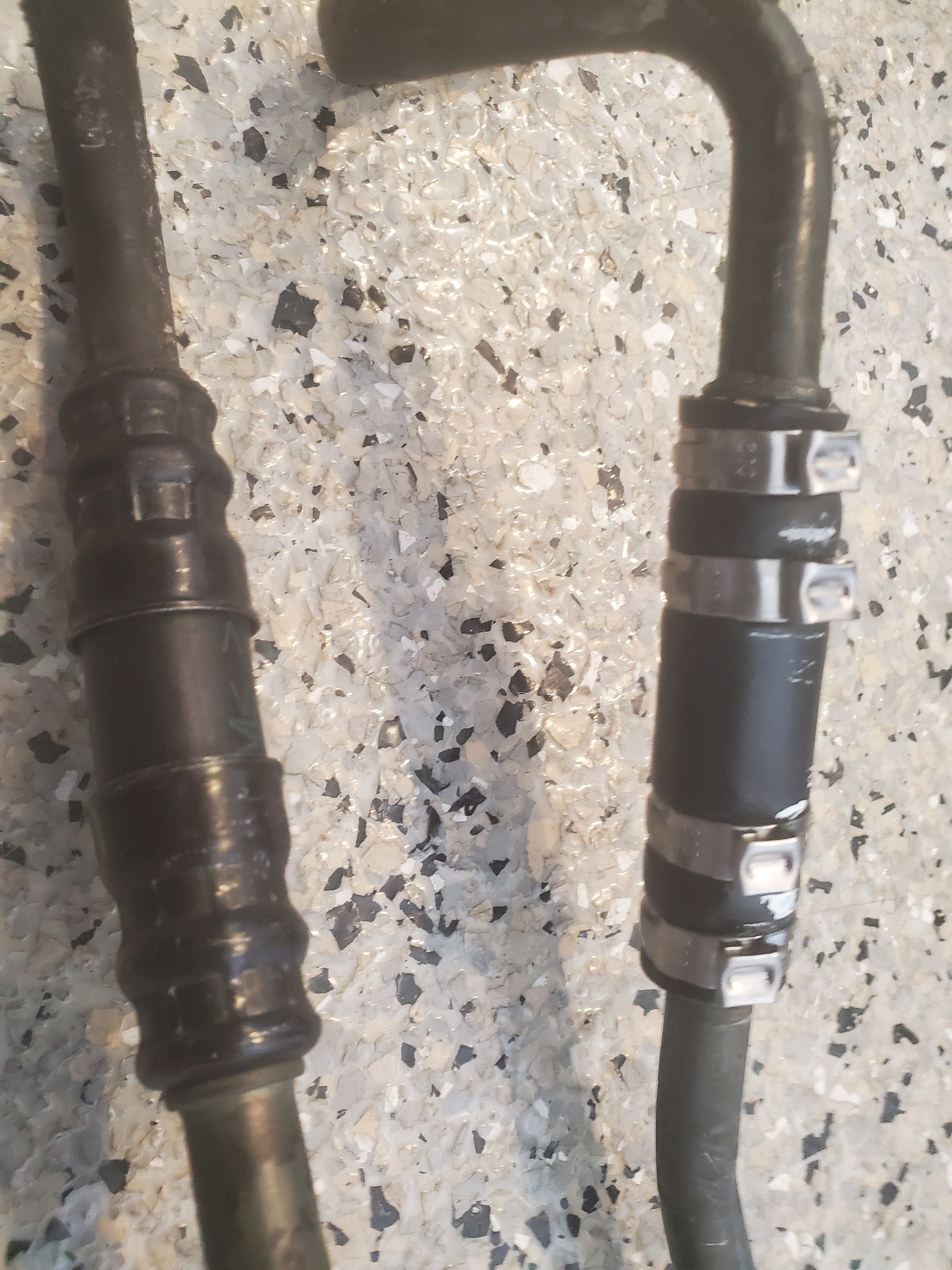

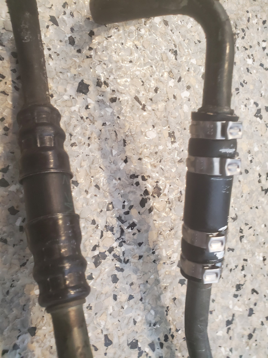

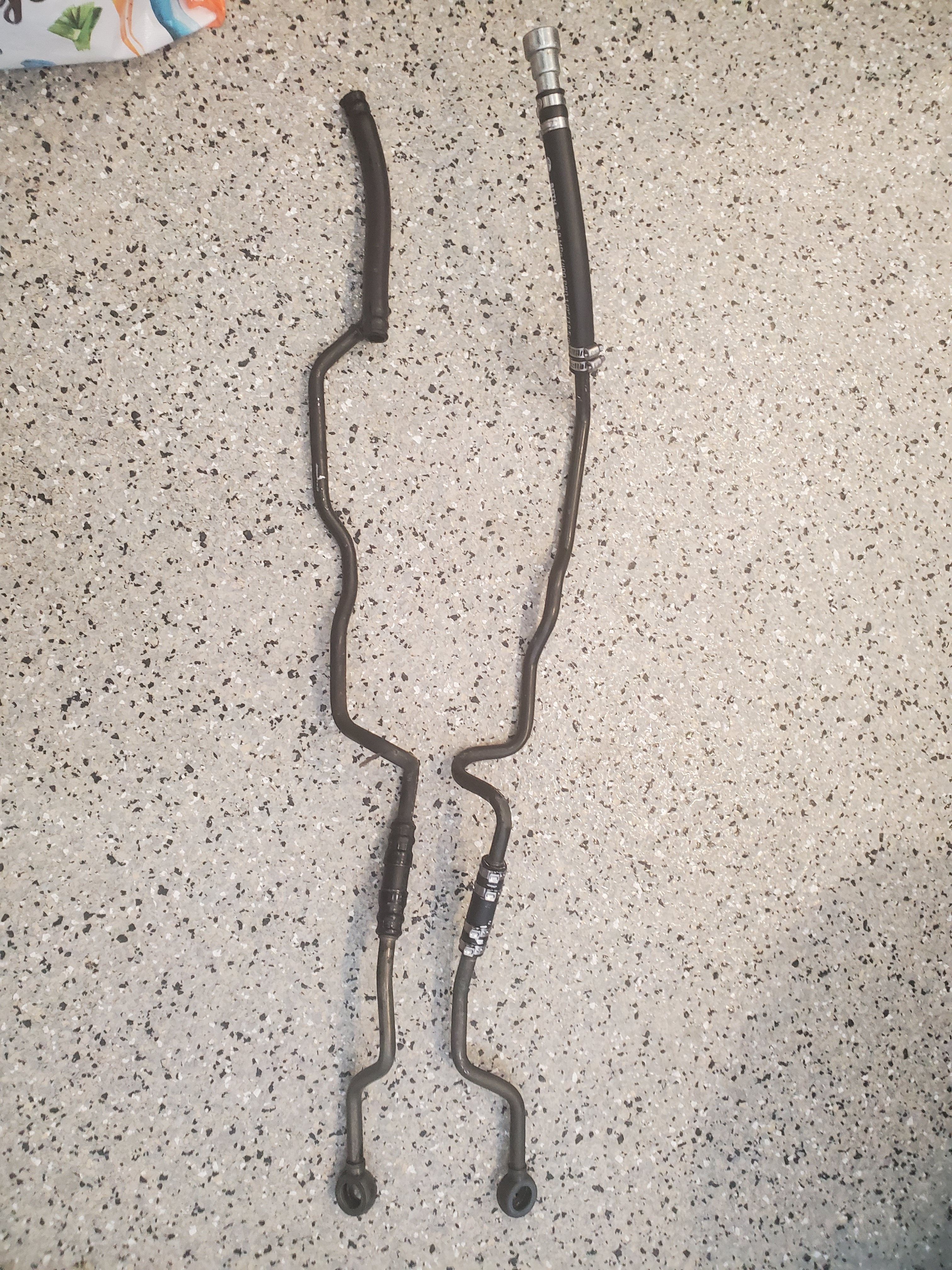

The crimp clamps on my auto trans cooler lines have been leaking for some time. Checked online how much new ones where. North of $400!!! So I repaired the ones I had instead using pieces of a new gates hose and an assortment of oetiker and worm gear clamps. Not the most fun job but I managed to save some hard earned dineros
Dang it's expensive to own a bimmer here...

Nice. That will last lifetimes.

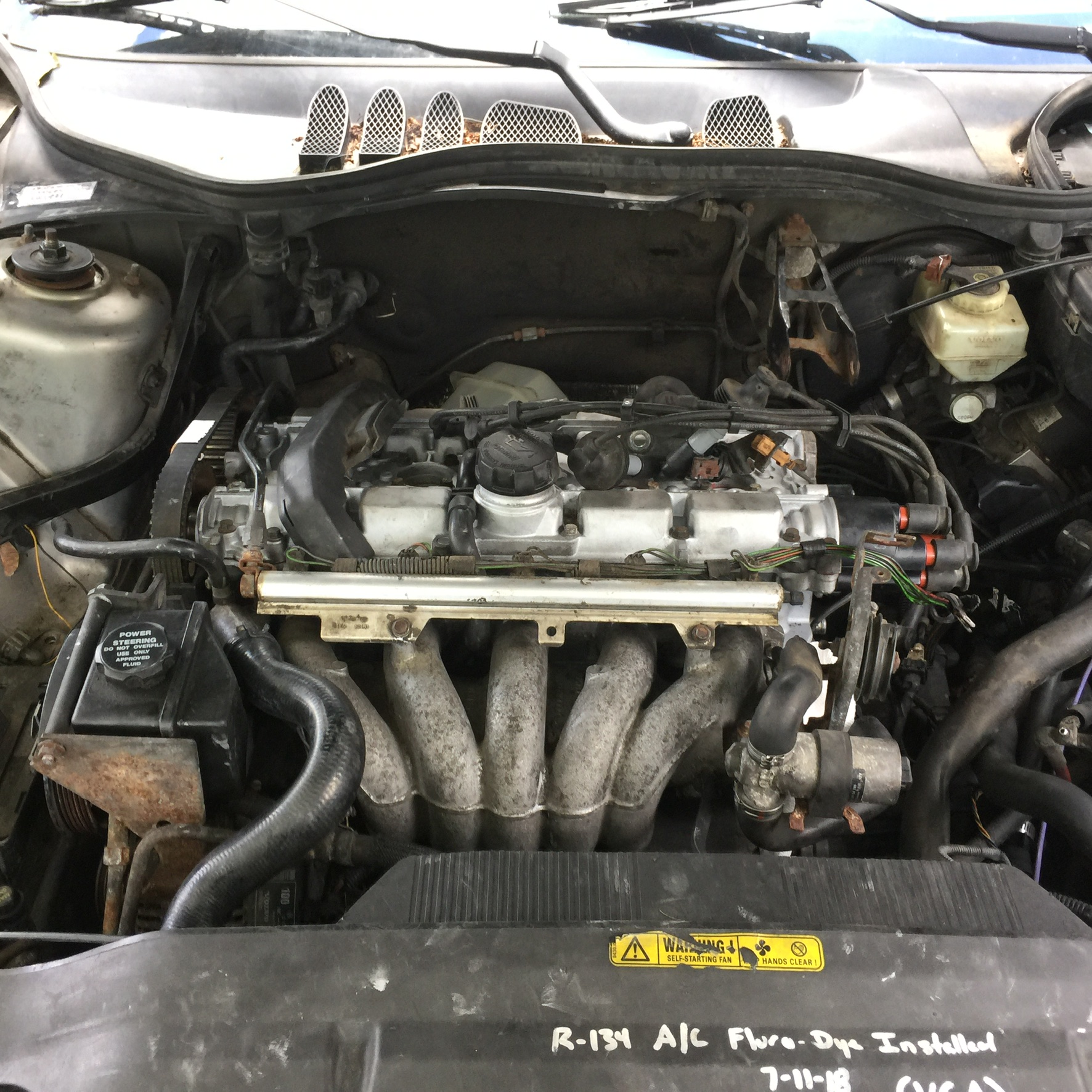

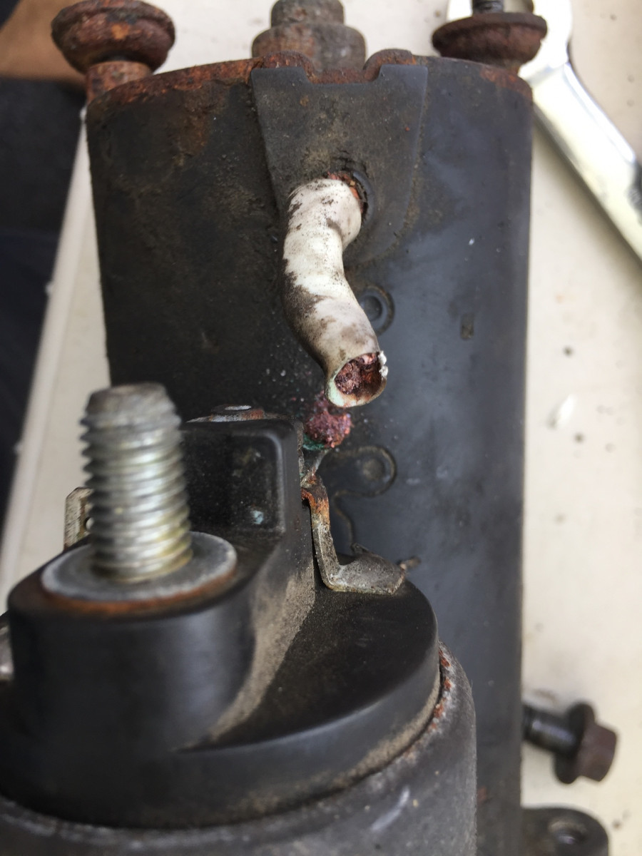

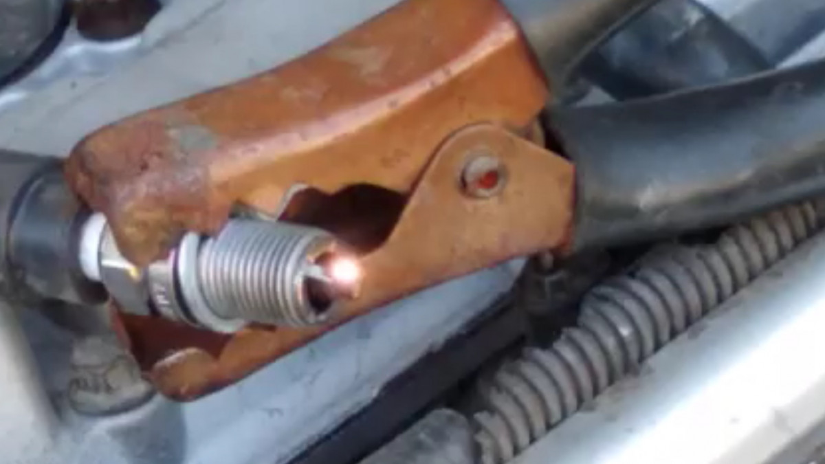

I troubleshot a no crank condition. No help with remote bypass terminal
Removed starter
Put in spare starter
Cranking good, no start.
Fuel supply ok on visual test, and smell test
Got nice spark picture for the files....
Removed starter

That was a little broken!
So fuel, spark, and it still won't start?

I’ve got two 1998s and a 1999 in the workshop at moment.
Focus is on the 1998 V70 at moment, just finishing head job. No life yet, runn8ng troubleshooting

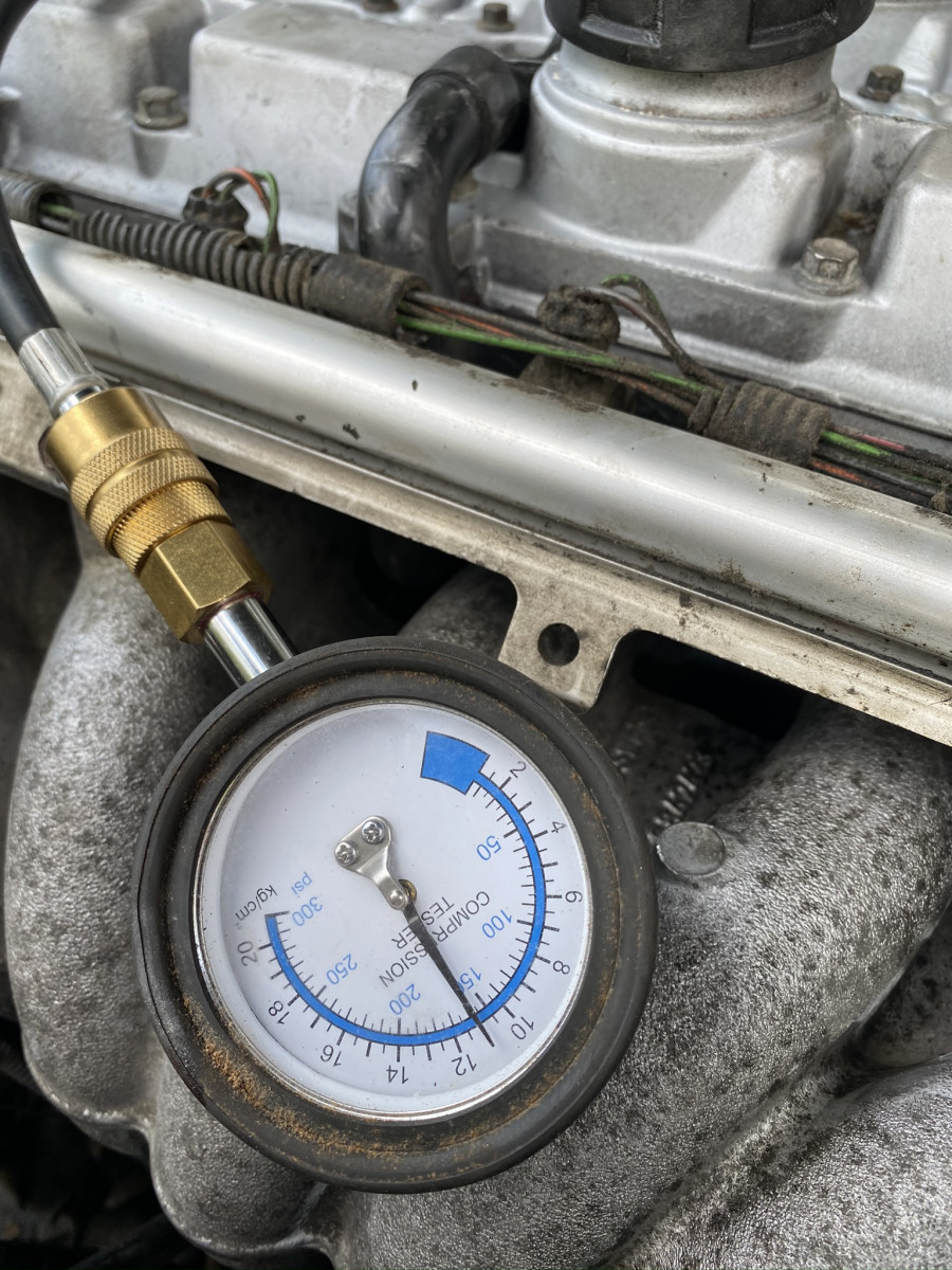

So, you have fuel, spark, and compression (assumed on all cylinders), but do they occur at the proper time in the crank cycle? Has this car ever ran for you?
