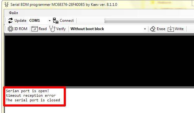

Treur wrote: 22 Apr 2025, 12:06 CEM free BDM programmer - https://volvo-tech.com/en/793-2/
I tried this project. It didn't work with CEM-B 8688434 . Still the same response : it can't permanently open com port.
If I missing something, I didn't figure out what is it.. till now
It would be the simplest CEM programmer, ever seen
[email protected] (32.22 KiB) Viewed 1560 times

Check connection, it's working
