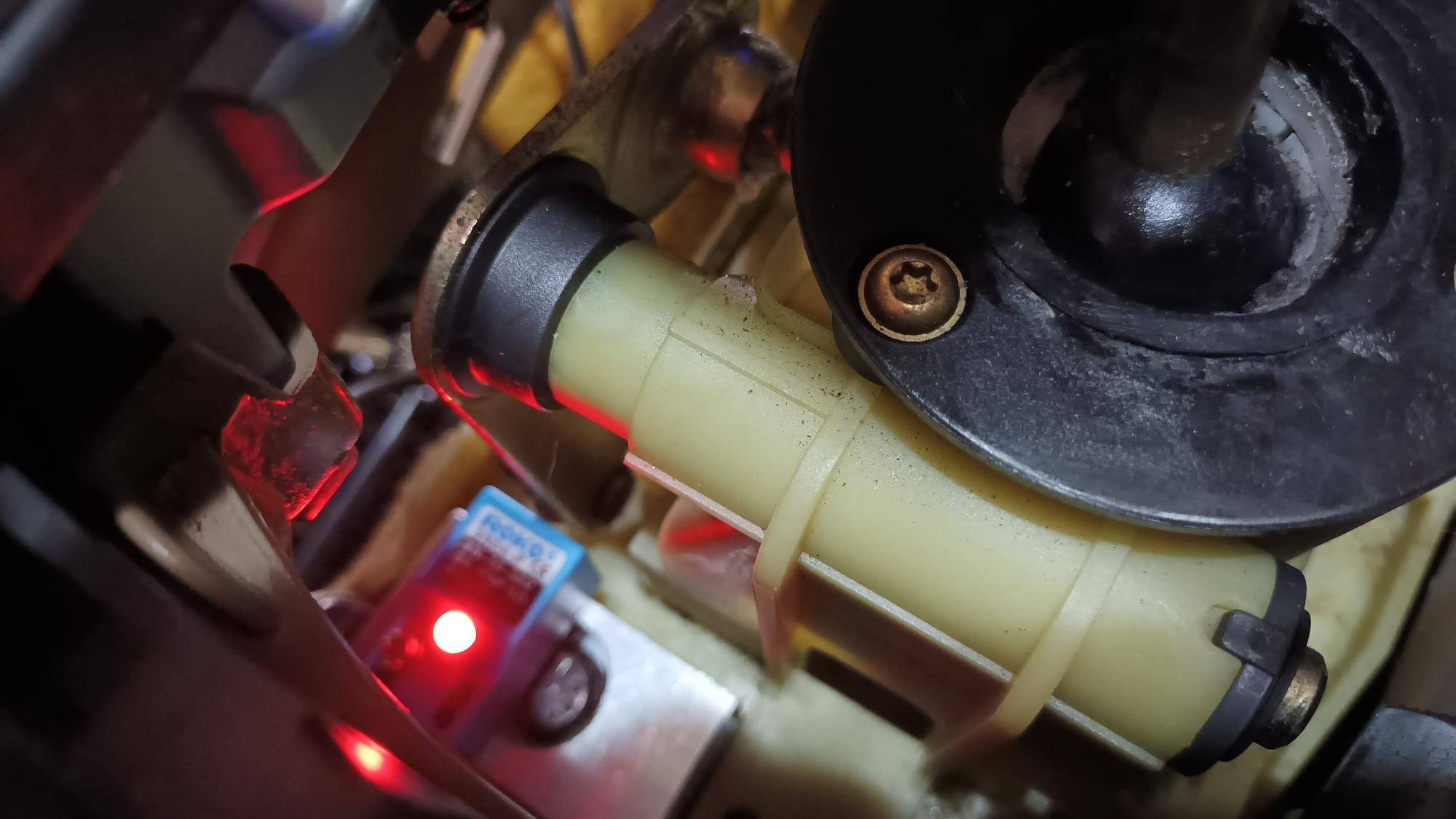

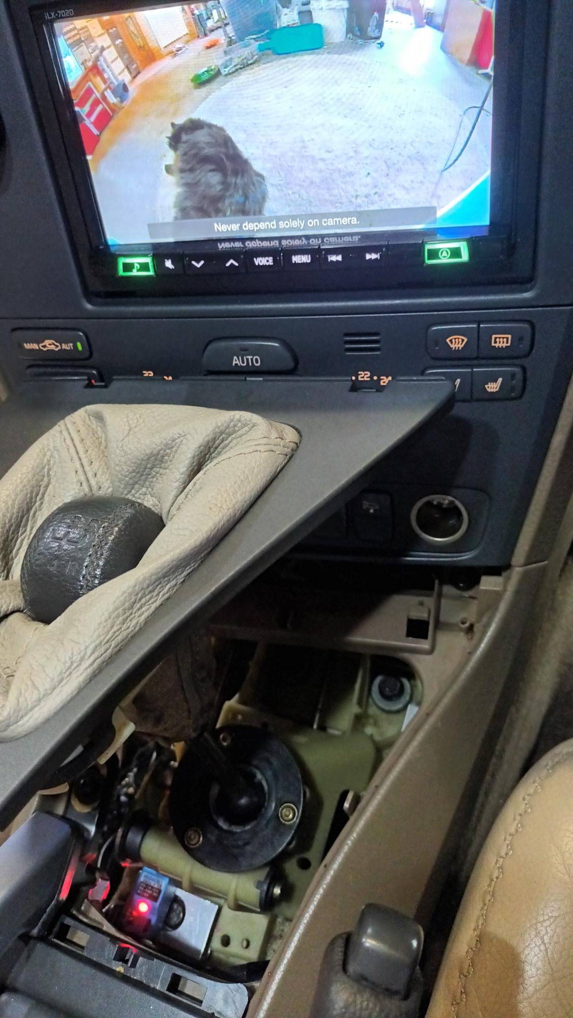

i am almost finished a front (cat cam) camera installation, activated by a contactless proximity sensor mounted on the gear stick (manual)
the sensor activates when a metal object (gear selector arm) swings into range
SN04-N 4mm PNP Approach Detect Inductive Sensor Proximity Switch DC 10-30V
Alpine ilx-702d headunit

Very nice, I would've personally also installed a night vision module such as the ones from Mercedes. But where did you put the front camera?
