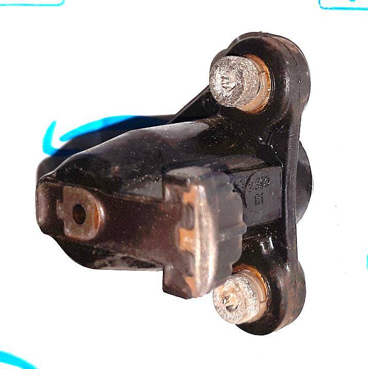

Thanks for the info. I may have misjudged the underside of the distributor cap though if you look at the picture you can see a ring around the inside where the contacts are. I think that is just carbon buildup, which can conduct and lower spark energy.
One thing is puzzling though. The distributor cap has six grooves in the surface that contacts the block when it is bolted on. The grooves will let air in or out of the inside of the distributor. They seem to be judiciously placed too. You can see them on the upper right side of pic and the lower right side of the pic, three on upper right three on lower right.
Any idea what those grooves are for?
The are narrow but not so narrow that they would stop air from going in and out.
I would think we would want to seal the surface around the cap mating area where it contacts the block to keep out dirt and moisture.

Both of those parts look well past their best. There looks like significant burning on the cap posts, but it may just be dirt. Some judicial cleaning may clean it back up to a good enough condition as a spare. The rotor arm on the other hand looks like it is beyond saving. Contact portion looks very worn.
A lot of the dirt could be dust and condensation build up.
Been a while since I had a distributor P80, but if I recall, one of the slits is a locator for orientation on the body of the distributor, and the other I think orientates you missing flash arrester. and/or is a condensation drain if it points downwards when seated.

I'm going to say replace those pieces pictured above and give the ECT sensor and connector a good going over.
The flash arrestor is there to help keep any oil/vapor from contaminating the inside of the dist cap. You have a cam seal sitting right behind there, and they do leak as they age.
