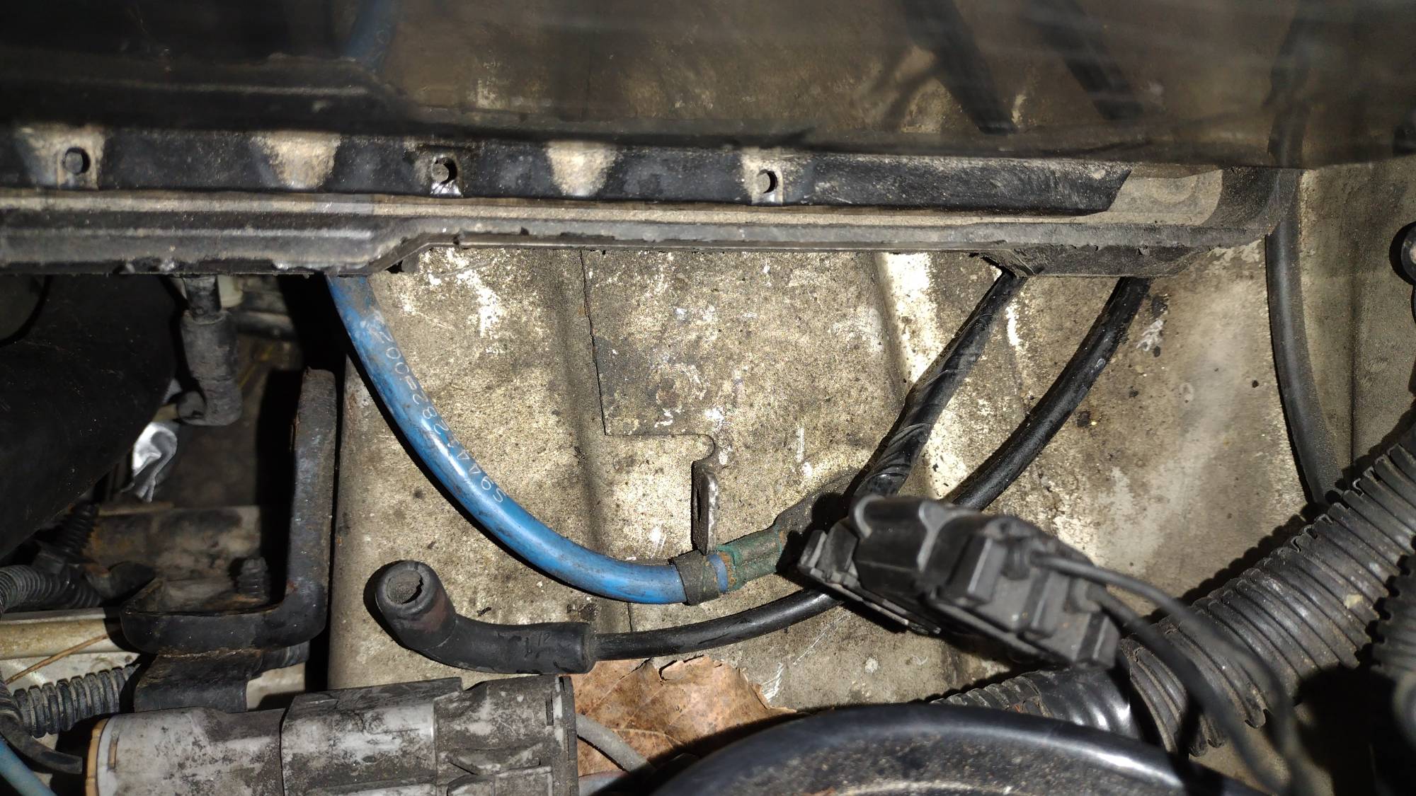

Also found this hose sitting in front of the battery tray. Assuming it's for the smog pump or cruise control? Maybe the evap system?

Most likely cruise control, the motor sits under the battery tray.
