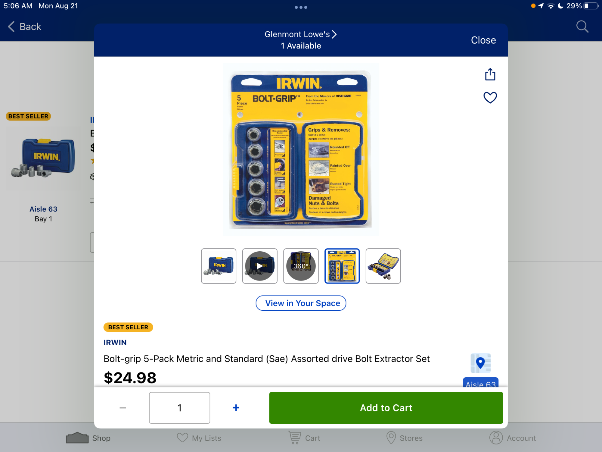

" I'm not sure if the thermostat is installed correctly. I was going to replace it a little while back when I replaced the expansion tank, but the thermostat housing bolts were stripped so I couldn't remove it."
Someone used the wrong size torx bit , its no biggie.
any decent tech can easily get those bolts out even if completely stripped out.
I did it on my bike transmission bolts with a shake and break in an air hammer.
The nuclear option is to weld a nut to the torx bolt head and remove with a socket.

Those thermostat bolts respond well to 30 seconds of propane heat and a brand new sharp Irwin extractors tool bit
