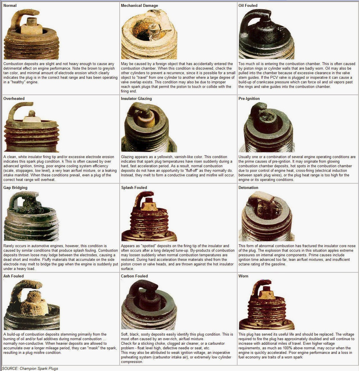

BTW, glad you took the time to look at the plugs. From the link chitownV provided and the oil ring video (see my previous post), let's establish and confirm that your P2 3.2 is not affected by the poor oil ring design issue. If there is oil burning it's from long oil changes interval, again established by chitownV's link and the video.
From the spark plug chart below we see your plugs has an oil burning issue with #6 while the others seem normal at this time. The first thing to establish is whether that cylinder has lower compression. If it does then oil burning is the main issue with cylinder 6 and less likely the PCV at this time. Being you're in Israel the 15W40 is suitable for the warmer weather.
1) Check compression of each cylinder to see if the oil problem is cylinder specific.
2) Clean all plugs and swap plug #6 and the coil with plug & coil #1. Check again and if cylinder #6 is clean then it could be a weak coil.
3) Clean the CAT with Lacq Thin regardless of any of the above to see if code goes away
4) Change to 15W-40 and check plugs again after some miles to see if there is improvement in overall oil burning.
Do the simple and narrow things down before changing part$ and doing a lot of potentially unnecessary work.

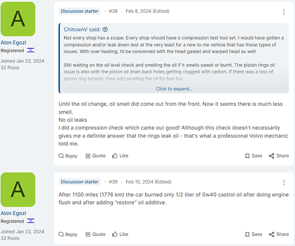

I did do compression test.
All of them were in a good condition - that's what the mechanic told me. But he also told me that there could be good compression but still the rings could pass oil through because of that poor thing design.
Also i did smell some volatile fuel smell from the oil. And if course the no.6 plug smells like burned oil and the no. 1 doesn't

EgoziAlon wrote: 12 Apr 2024, 01:19 Thanks for summarizing.

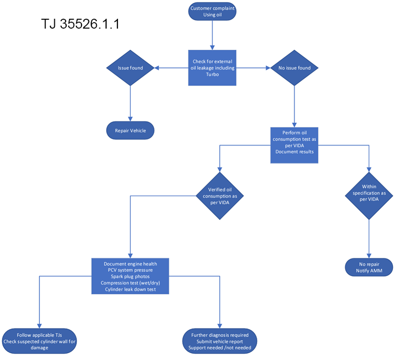

Volvo TJ 35526.1.1.pdf
(625.58 KiB) Downloaded 208 times

As for the oil consumption. Let's make sure that we are talking about the same thing. The P2 XC90 to 2014 did not have the bad designed oil rings on the Volvo and through out the industry. They can consume oil but didn't have those badly designed oil rings which were on later 2.0, 3.2's with some indicating the 2.5's also.
The service bulletin you provided indicated this also. The service bulletin is in 2020 so this couldn't be for the up to 2014 XC90's. Oil consumption from poor or improper maintenance is not the same as poorly design rings which again the P2 XC90 didn't have.

This TJ does apply to the Si6 in both non-turbo and turbo variants. The other referenced TJs, which go deeper into the issues address the specific engine variants. This TJ is the process a dealership tech has to go through for proper diagnosis and warranty approval. In 2020, it still applies as many XC90s would still be serviced at the dealership.
