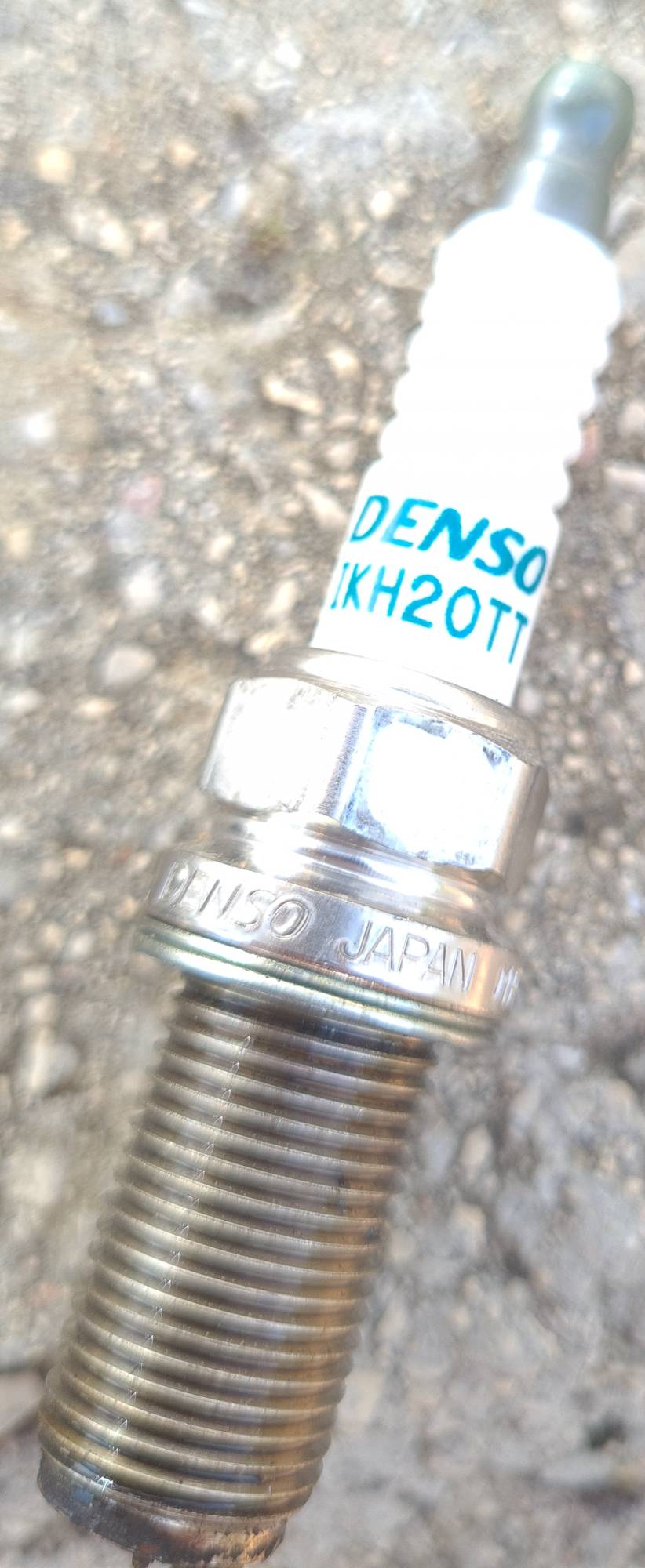

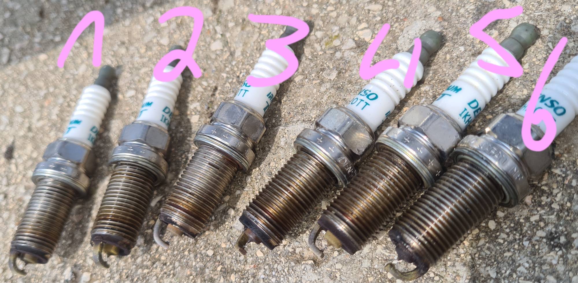

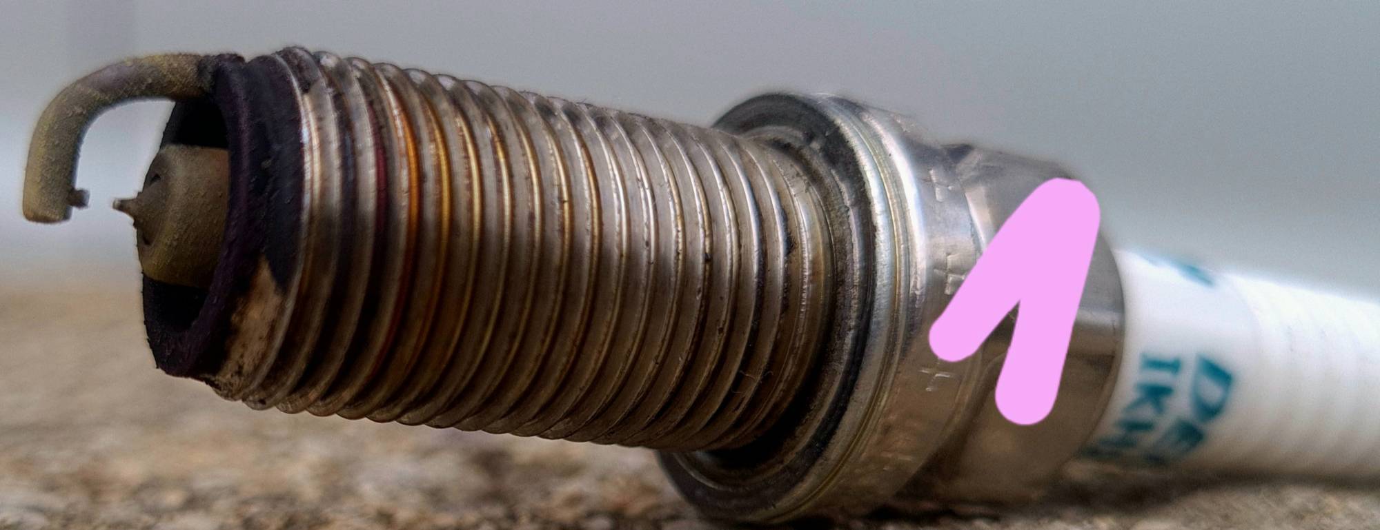

Took out the plugs. For your judgment

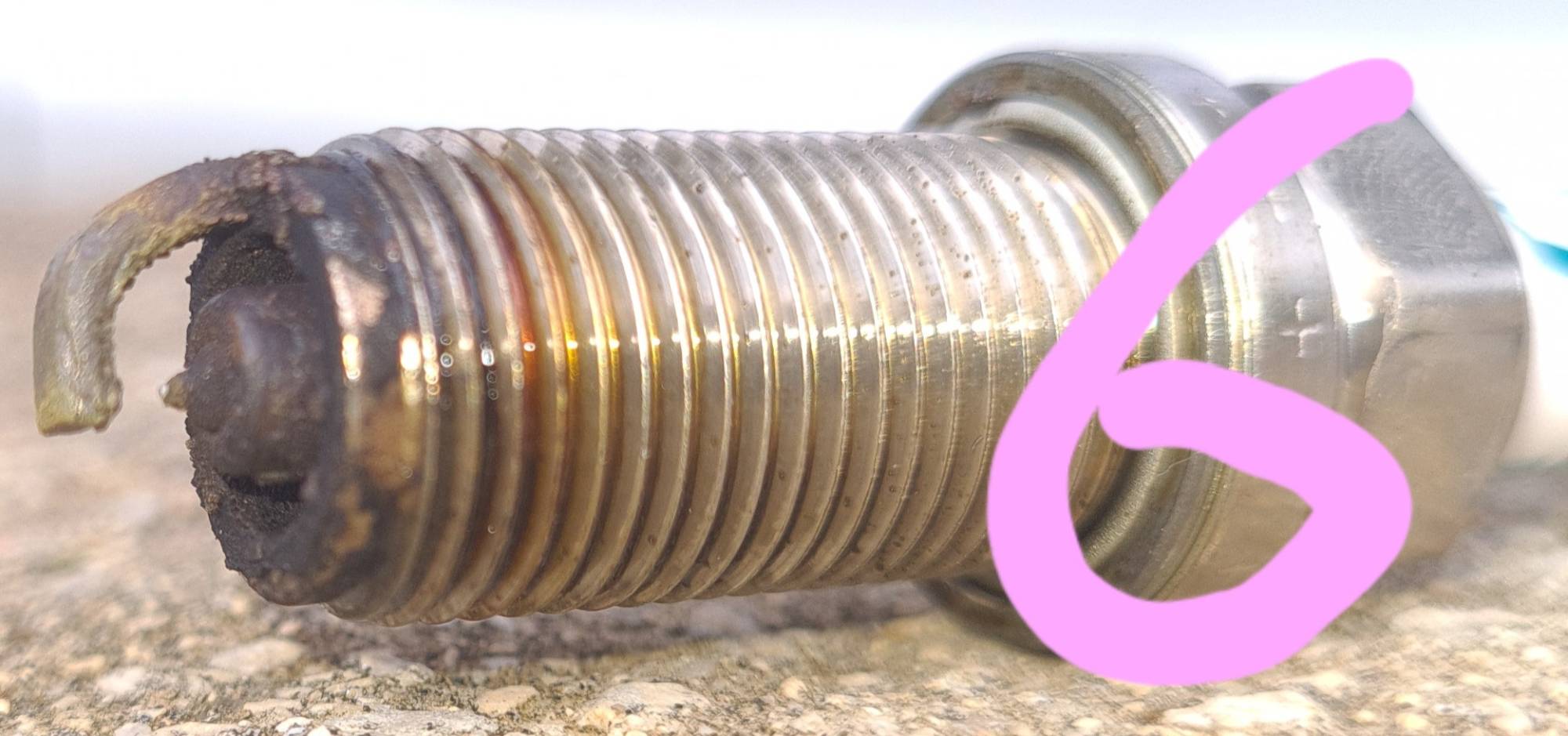

Post by EgoziAlon »

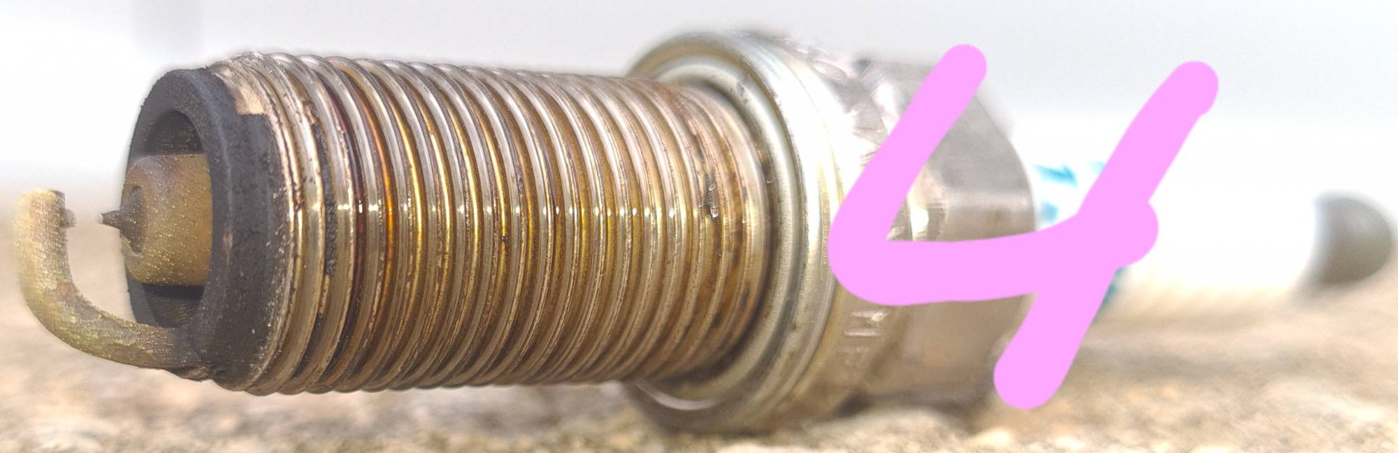

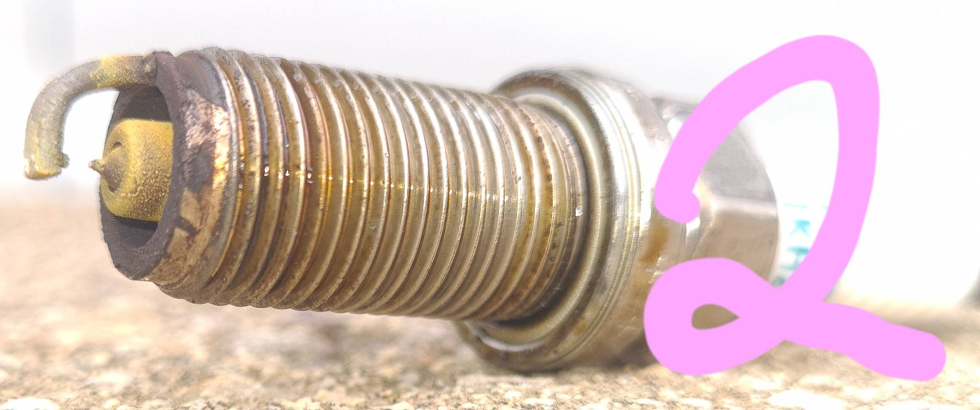

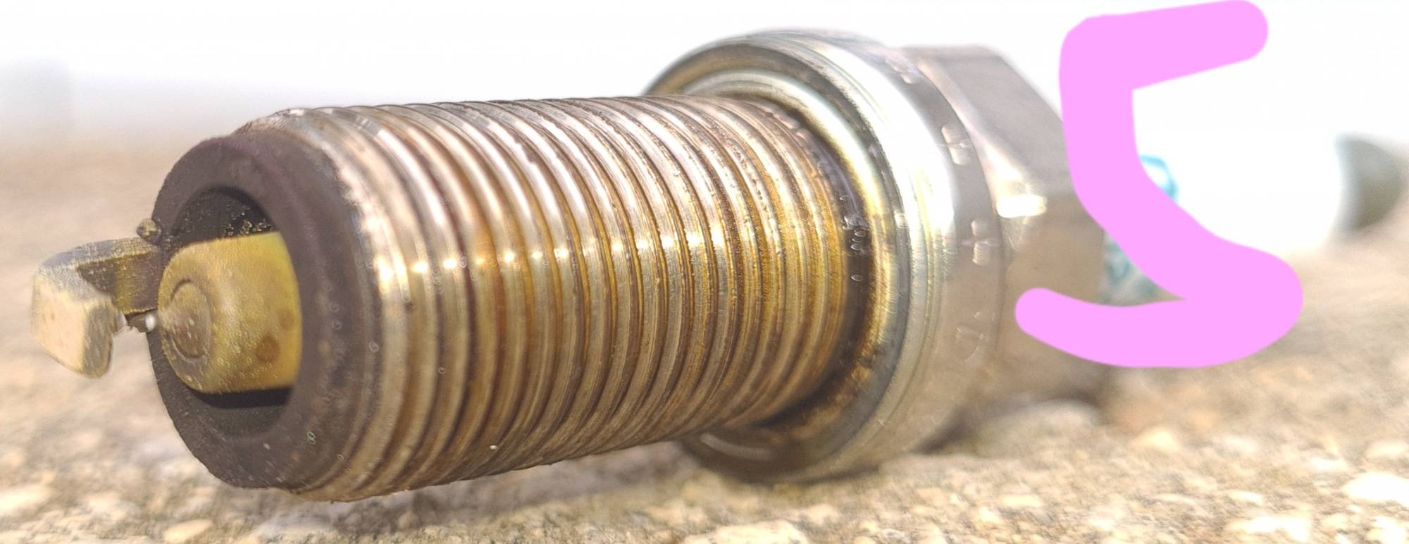

More pictures

#6 indicates your PCV (aka oil separator). Bad PCVs will start at cylinder #6 and then as it gets worse move towards both banks. In the Oil Consumption and P0420/P0430 thread I specifically linked to a thread showing this pattern.
You didn’t mention any observations while removing the plugs. Any oil in the spark plug holes? How are the coil boots? How do the spark plugs smell? Etc.
You kept on questioning my help and experience with the 3.2. The collective 3.2 experience that I reference in my threads are just the start so you can continue to research on your own. You assumed the cheaper PCV was good and then tried to justify why it’s not an issue. I hope it’s a good lesson for you to not make assumptions and to simply verify.
I think this is where I’ll end the my help in this thread in this forum. Now you can see to trust the process and the specific 3.2 threads directly addressing these issues.

I just smelled the no. 6 plug and it does smell like burned oil
