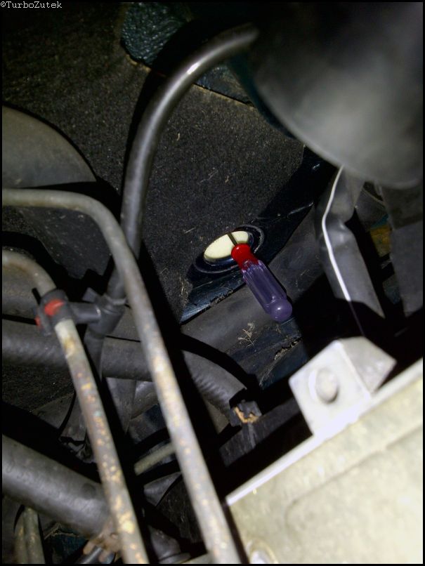

I recently did the YITSBox Mod:
YitsBox Mod and Harness.jpg (88.02 KiB) Viewed 6777 times
The quality of construction is top notch. Good components, a well designed PCB and the solder (all done by hand) was utterly perfect; I couldn't improve upon a thing on the hardware. I got this delivered at 9am and by 9:10 I was building a cable loom for it! Yits included all the connectors and the mounting hardware needed in the kit, all I had to get was two lengths of two core automotive cable and a metre of four core.

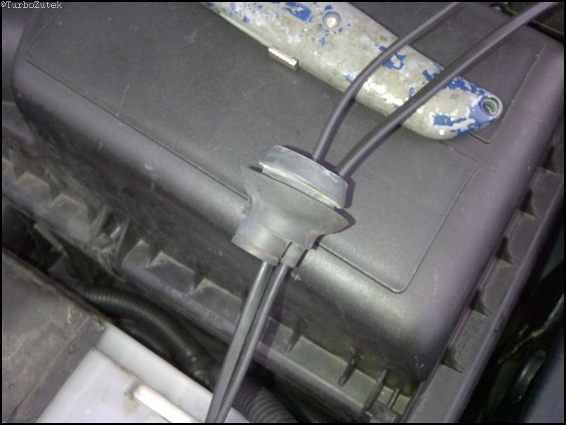

While most installations of this unit were to a LHD car, mine is a RHD... The instructions are mostly the same of course, the only difference being you need slightly longer cables and it's inconvenient to route the cables via the fusebox, as your loom would have to pass the hot exhaust manifold. Instead, I lead the loom over the centre console and behind the glovebox - from there I found the original unused Volvo grommet, removed it and made a hole in the sound damping foam.
It pokes out just in front of the air recycling flap and from there it routes to behind the glovebox.
Cables Installed In Grommet.jpg (70.33 KiB) Viewed 6777 times
The original Volvo grommet just needs snipped in two places and with a little silicone grease becomes 100% water-tight again.

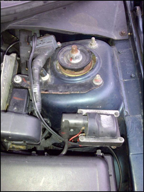

The routing under the bonnet (hood) - I basically followed the ABS loom here, first connection branching to the coil while the other runs behind the battery to the solenoid.
YitsBox Mod Installed.jpg (83.71 KiB) Viewed 6777 times
Doesn't look out of place in the slightest, a very clean almost 'factory' look! :)
