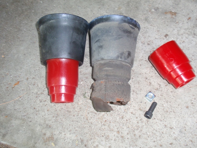

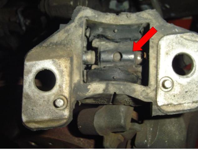

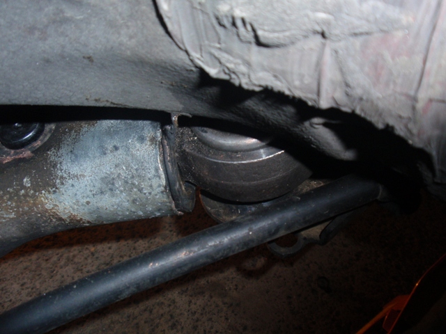

Anywho, while I had Lola's rear in the air, I noticed this: That bump stop is supposed to be mounted to the upper spring perch right? I looked on IPD's and FCP's websites, and didn't find any replacement rear bump stops.
For the fronts I used some Daystar EVS universal bump stops, that were cheaper than any of the Volvo stuff I found, and they seem to be working great. Not that I ever take Lola off any "sweet jumps" or anything, but I guess I should probably address the bump stop issue, before I go loading any bodies in my trunk.

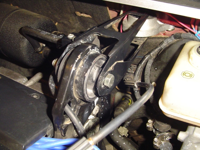

Continuing with replacement of "all the little things" I should have done when I originally did the engine swap. I did most of the other engine mounts and bushings last weekend. I'm still adjusting to the new smooth ride, I was so accustomed to putting the transmission into neutral at every stop light to lessen vibrations, I've still caught my self reaching for the shifter a few times.

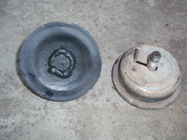

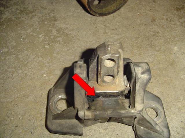

I'm guessing the biggest improvement was probably from replacing the front right lower engine mount, it was beyond shot.
The rubber was no longer attached to the old engine mount. Here you can see the shiny bottom of the engine mount where it rubbed metal to metal on the sub frame. Brand spanking new, I got a little crazy with the white lithium. I also got rid of the yellow polyurethane upper torque arm bushing, and replaced it with a rubber one. I used the big bolt with two pipe flanges DIY press method to install it, but even with that I had some difficulties. I chucked the new bushing with a bolt through it up in my drill press, on a low speed, and held a file at an angle to the edge of it. This let me put a taper/bevel on one side of it which greatly aided with pressing the new bushing into the mount. I also put the bushing in the deep freezer over night. Last but not least (well actually I did this first) I put in a new transmission torque arm, all shiny and new.

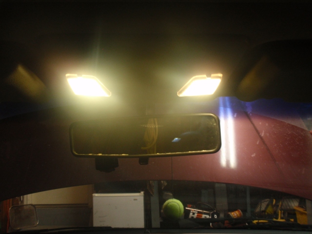

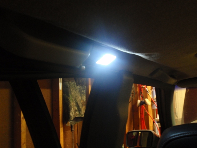

After getting an over head map light assembly that worked (actually got a newer one from an S70) I switched all of the interior lighting to surface mount LEDs.
2x 36 LED panels in the map lights 5 LED "replacement bulbs" in the rear 48 LED panel in the trunk: I wasn't happy that the color temperatures weren't the same, but it's so much brighter, and the eBay LEDs are cheap enough I haven't bothered to do anything about it. I even added a 36 LED panel in the driver and passenger side foot wells, and have been very happy with the extra light.

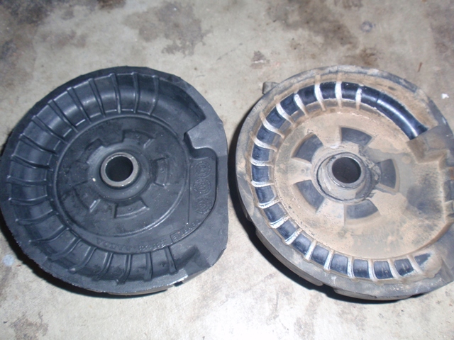

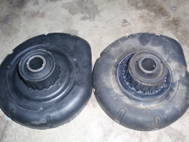

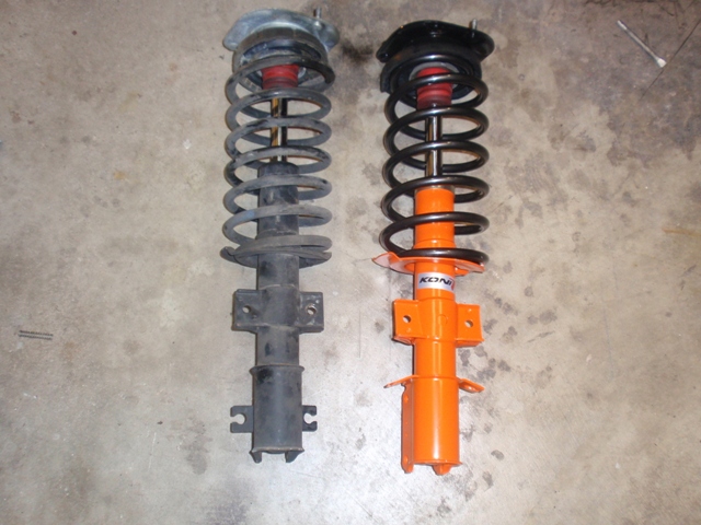

The biggest update has happened over the past few weeks. I had put new struts and strut hardware on a couple years ago (page 3 of this thread) I bought the cheapest I could find at the time, $75 got me a pair of spring seats and strut bearings from FCPGroton, well they don't seem to carry the particular kit I purchased anymore. That ought to tell you something. I was having similar noises (not as severe) from the front end as when I replaced the spring seats before.
Sure enough, worn out already. You get what you pay for I guess. This lead to some decision making on my part. I decided I wanted all new suspension, shocks, struts, springs, bushings, etc. I wanted a little more performance oriented suspension, but didn't want to brake the bank, nor did I want to be scalping ground hogs. So goals were affordable performance with the least drop. I wound up with a set of Koni STR.T (orange) shocks and an Eibach Pro Kit. I'm kind of a guinea pig on the Konis since there don't seem to be many in the Volvo community using them yet. They had positive enough reviews on forums of plenty of other auto makes/models, and Tire Rack had a 20% off sale on all Koni products a few months ago I decided to take the plunge.
After extensive research to find a decent set of performance coil springs with the least amount of drop, I decided on Eibach. I spent more than I originally planned, but found a good deal via Discount Tire Direct on eBay. They claimed free shipping, but charged me enough in tax to make up for it, still cheaper (just barely) than anywhere else I could find them. After they/Eibach screwed up the shipping, Discount Tire stepped up and refunded me $50, so that almost made all the hassle and a trip to the UPS warehouse worth it.
Enough Jabbering, on with the pictures:
Front Spring Old vs. New Strut Assembly Old vs. New I upgraded to XC90 spring seats. You can obviously see how much beefier the new XC90 spring seats are than the old cheap crap I was using. Holding each one in your had you can also feel how much more substantial the XC90 seat is. Finally front strut assembly on the car. That Koni orange paint is very delicate, I had the strut bodies wrapped in butcher paper and duct tape to protect them when assembling them, but still manage to nick/chip the paint in a few places. - Lee

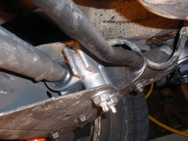

I decided (foolhardily) that I should probably do the rear trailing arm bushings and link ends while I was at it. I'll preface this with a HUGE thanks to Ozark Lee for the info on replacing the rear links, would have taken me 5 times as long with out reading this: www.matthewsvolvosite.com/forums/viewtopic.php?p=31294
I decided though, that if I ever find myself needing to replace these links and/or bushings again, well it's time for a new car.
New trailing arm link, I didn't really think much about taking pictures of any of this, I was mostly focused on getting the stupid things out, what a chore that was. A torch is your friend, I used my propane torch, but an oxy/acetylene with a rosebud would NOT be overkill. On the trailing arm bushings, it was a learn as you go, and of course I read VADIS after I was done, more of a "did I do it right," than "how do I do this." Smart huh? This was very much a 2 steps forward one step back. If you notice in the pictures that the passenger side (US) is "captured" and thus both the passenger and driver side bushings, and at least one of the trailing arm links must be removed before the passenger side bushing can be removed. I of course did the driver side first, only to have to remove it again.
Passenger Side: Driver Side: - Lee

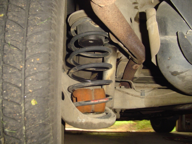

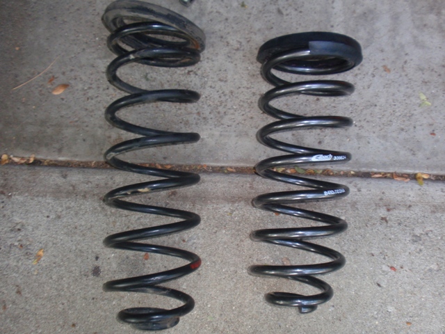

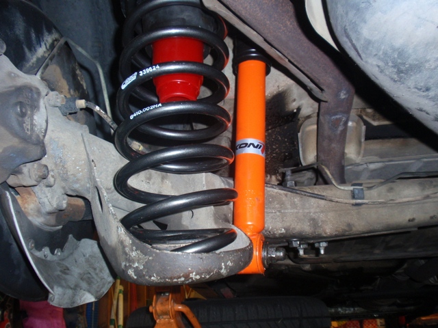

Finally the rear springs, shocks, and bumps.

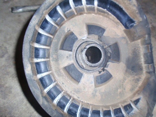

Rear Springs Old vs. New with new coil spring spacer too. Now the rear bumps on my car were beyond gone. The driver side was rattling around at the bottom of the spring, and both would crumble to pieces pretty much just by looking at them. I looked at factory replacements, but am not a fan of it being held in place with a plastic push pin, how expensive they are (seem to be a dealer only item) or the fact that my now slightly lower suspension would have slightly too long bump stop if I used a factory one. So I used my mad Googlefu skills and went to work, I found several possible solutions, but I finally decided polyurethane bump stops from Energy Suspension. Specifically the 9-9143R, which is 3.125" tall and 2.437" around with a 3/8" through hole for mounting. I used a 1" long 3/8" socket head bolt and square nut to mount the bump stop to the bump stop mount. I used a square nut because I couldn't fit a hexagonal nut down into the bump stop mount.
Bump Stop Old vs. New with mounting hardware Another issue I ran into were the press fit bolts in the rear lower spring retainers no longer being "pressed" in place. This made removal difficult because the bolt would just spin when attempting to remove the nut. This was solved by a friend at work welding the bolts in place. They got a coat of Rust-Oleum, to stave off any rust. Finally the whole mess together

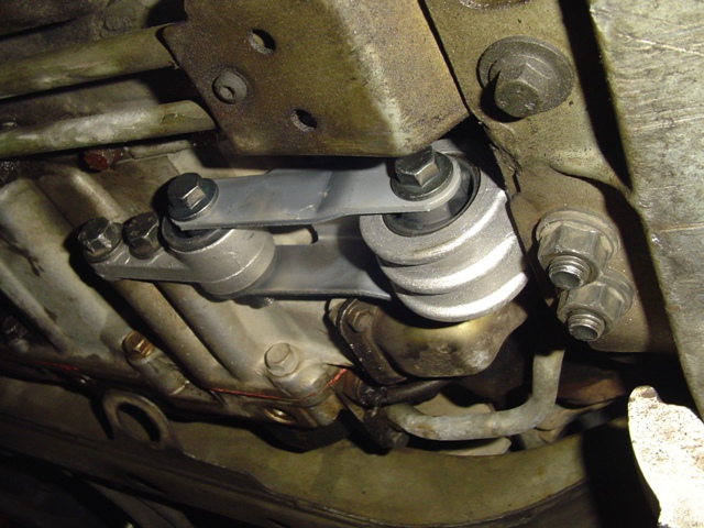

Still need to do an alignment, but I'm going to replace the strut bearings first. Yeah I've got to take the front struts off/apart again. I was expecting to reuse those cheap POS strut bearings I bought, well the passenger side literally came apart when I removed it. I cleaned it up and re-packed the bearings with some good Lucas Red N Tacky grease, put it back together and put it on the car, didn't have any other options. I will order some new OEM bearings this weekend.
I've got a new Lemforder lower engine mount and Meyel torque rod bushing to replace the Scan-Crap I used last fall. I knew better, I guess I'm just a glutton for punishment. Who doesn't like doing the same repair over and over?
