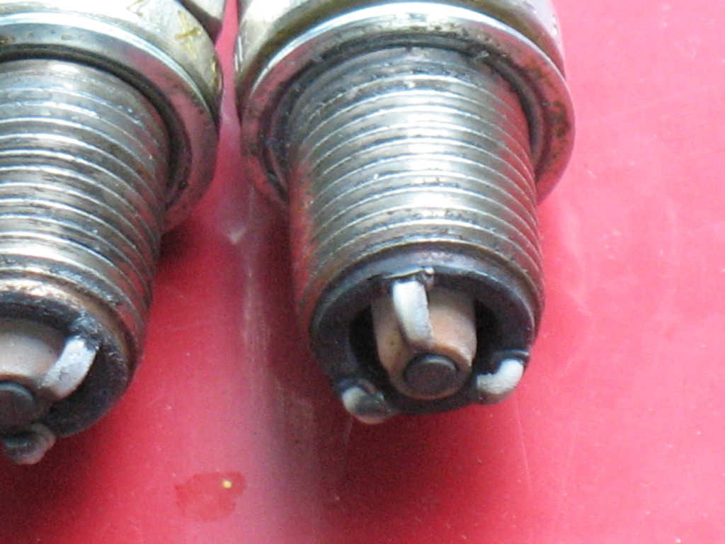

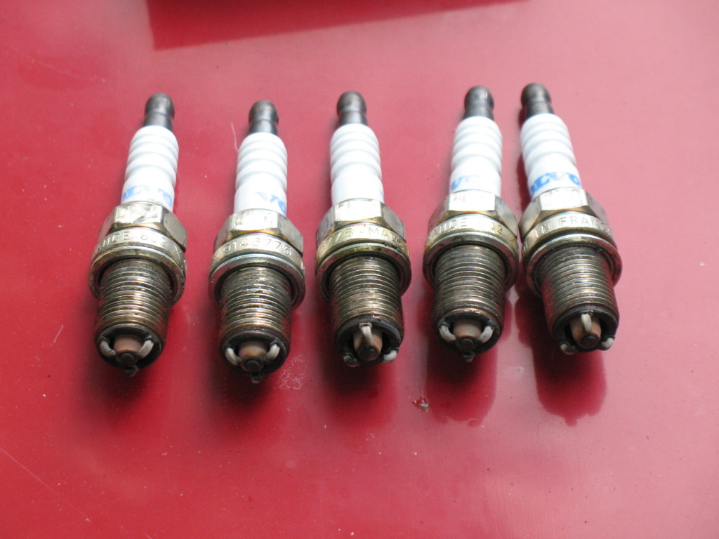

I just changed the spark plugs and found what I would imagine are either original, or old replacement stock plugs. Here is a picture of them, as removed from the motor left to right:
They all had the same amount of wear like this:

Those don't look terribly bad, you've still got a healthy engine! :)
