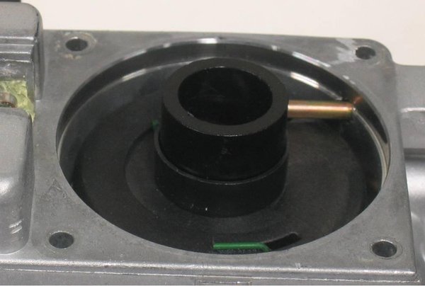

Just another quick question before I go and cut the shaft tomorrow. It looks like there is no tight fit between the magnet and the shaft (see picture) is that going to be solved when I fix it under the bolt? Or do I have the wrong magnet / sensor?
Thanks in advance,
Nadja
Thanks in advance,
Nadja

The magnet is upside down.

The shaft at the bottom where is the carving is wilder, so when you cut it it'll be fine. Well, allmost... there still will be a 1 degree tolerance, but when you tight the nut it'll be strong.

@ precopster, I know the magnet was upside down. I did that to show the space between the shaft and the magnet.
