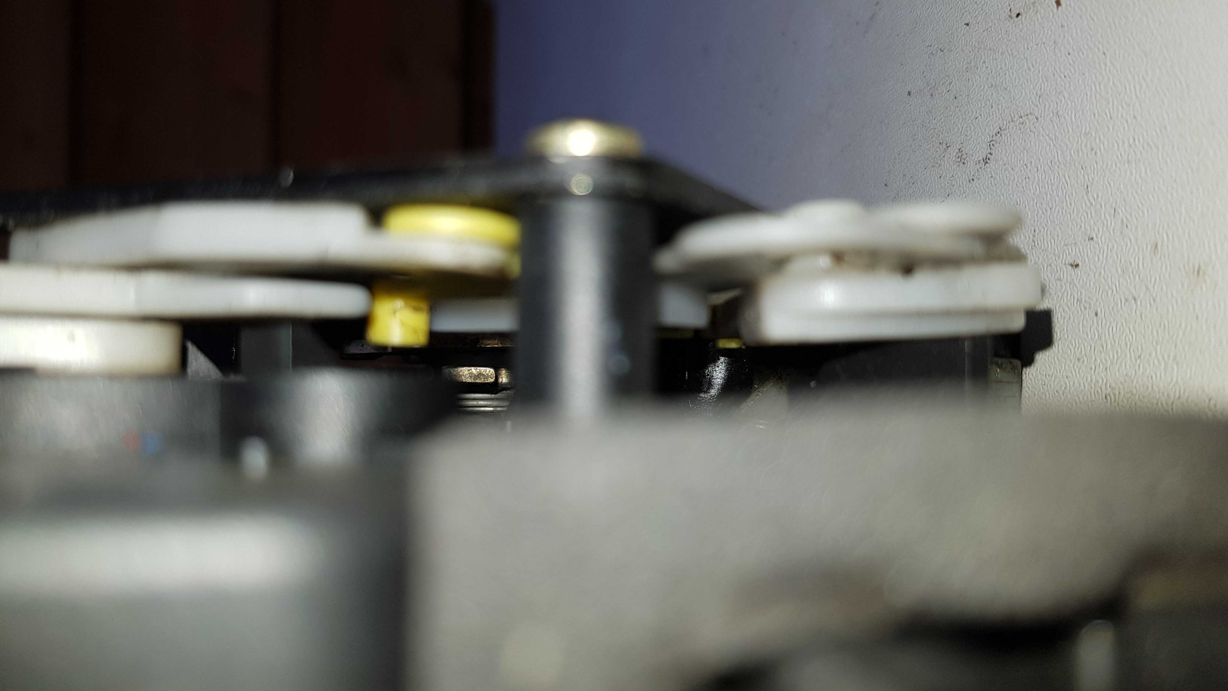

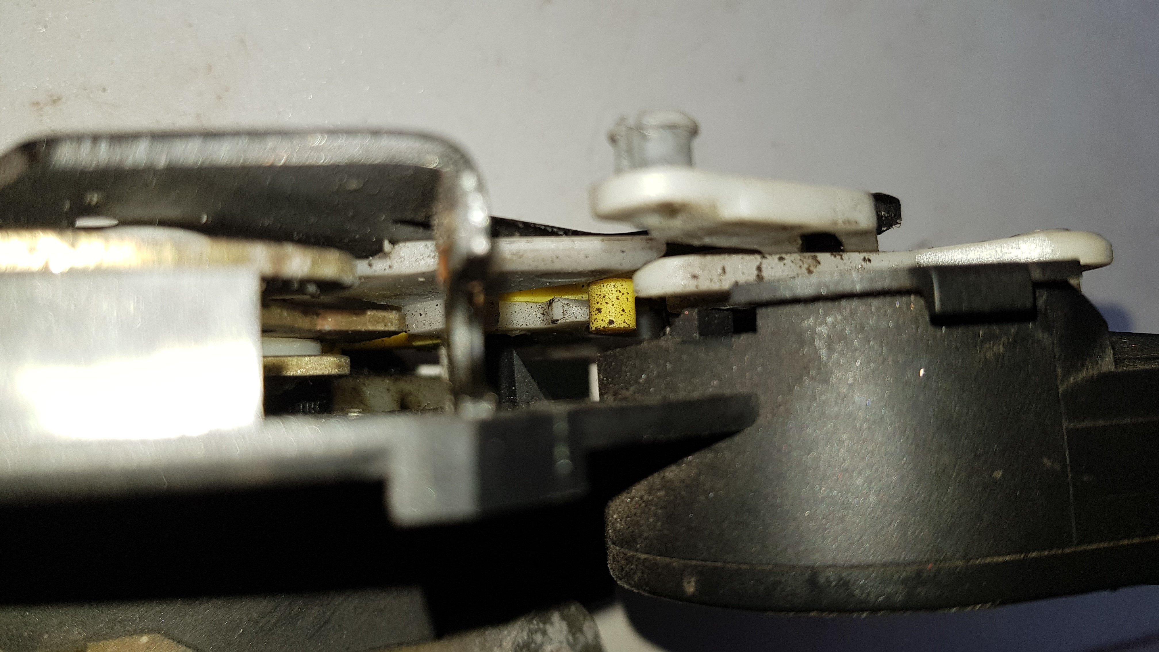

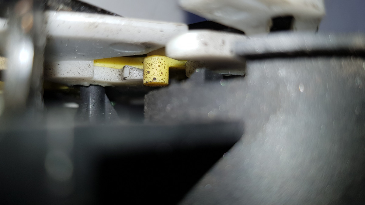

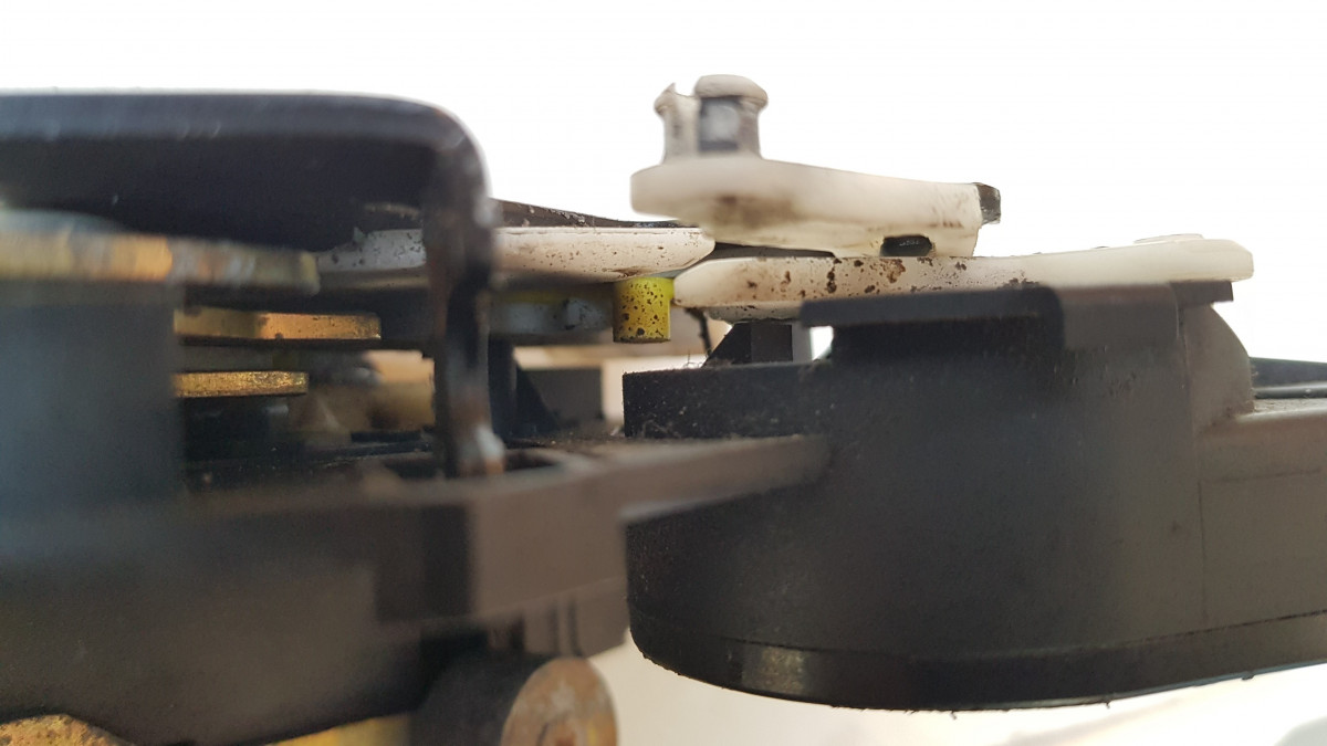

Nice, those pics will likely be useful to someone. I'm not surprised the actuator has changed somewhat in an 05 C70, but also not surprised the design is basically the same.

Looking at the state of the pin, it doesn't look very healthy, and appears to have a slight bend on it already? Having played with the mechanism, the only time that pin is touched, is when the motor actuator turns in the unlock direction. I've got the old one to come out, so will have a play with it, and see if there is any way to possibly repair, or make a replacement. They aren't cheap ! Looking at it though, I'm at a loss as to how and open it? looks like "boyoyoyong" moment as springs fly in every direction ?
