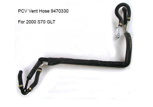

I’d like to do the heater hose fix on my 2000 S70 GLT, but I'm not sure it will work.
The vent hose is more complex. It runs from the oil trap in 2 directions: to the PTC nipple at the turbo intake, and to the underside of the Intake manifold through some plastic(?) pipe and a banjo fitting.
Instead of a vacuum pipe, there's a coolant line with a banjo fitting, running from the rear of the block (above the PTC area) to the thermostat. I would guess the purpose of the coolant line is to warm the vent hose and prevent condensation in the line.
I’m not having any failure symptoms, but the car has 145,000 miles and the PCV system is probably original. Might this mean the coolant line jacketed with the vent line is working?
Here’s a picture of the vent pipe, the parts diagram, and my take on how it works.
PCV Hose1.jpg (116.1 KiB) Viewed 3816 times
PCV Diagram.jpg (142.68 KiB) Viewed 3816 times
PCV Diagram Color Coded.jpg (265.41 KiB) Viewed 3816 times
The part costs $185.00 and seems to share the same limited flow that CN90 points out in his writeup.
Some people just clean out the tube if it isn’t broken. My plan is to replace all the parts except this vent hose, then clean or replace it as needed. I don’t see a way to improve the flow with 5/8” heater hose due to the restrictions at the banjo fitting.
I’d appreciate any advice about this specific variation of the PCV system, or any suggestions about using heater hose for this.
