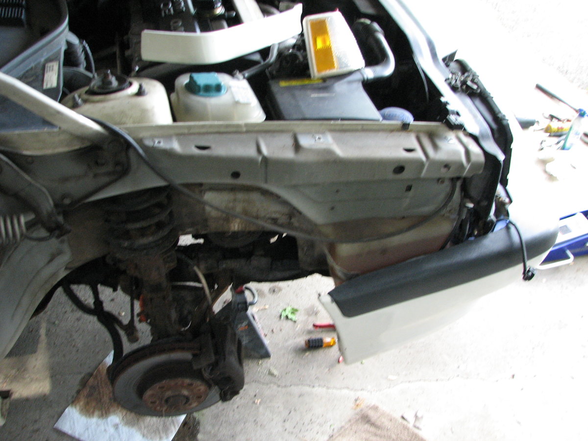

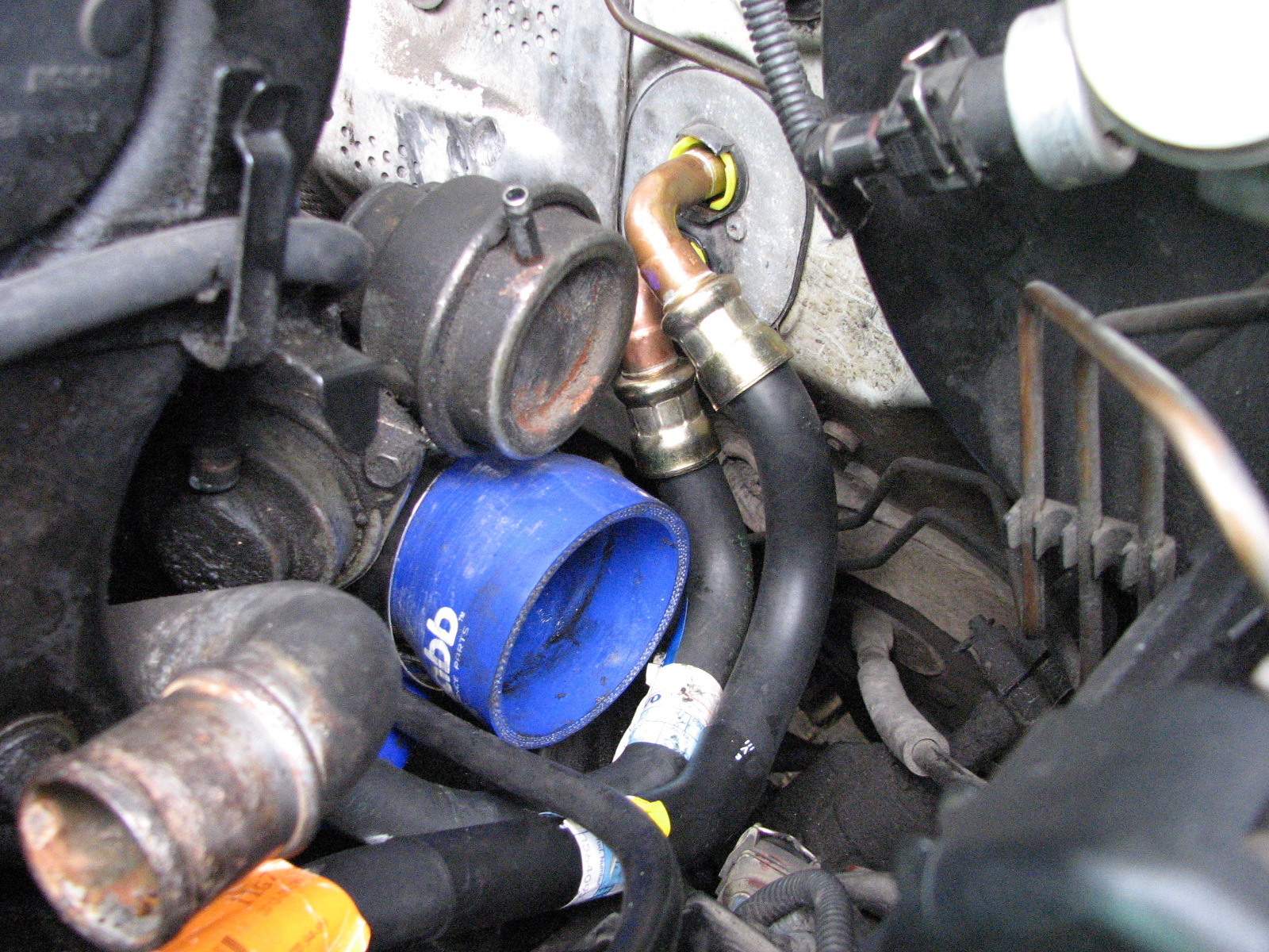

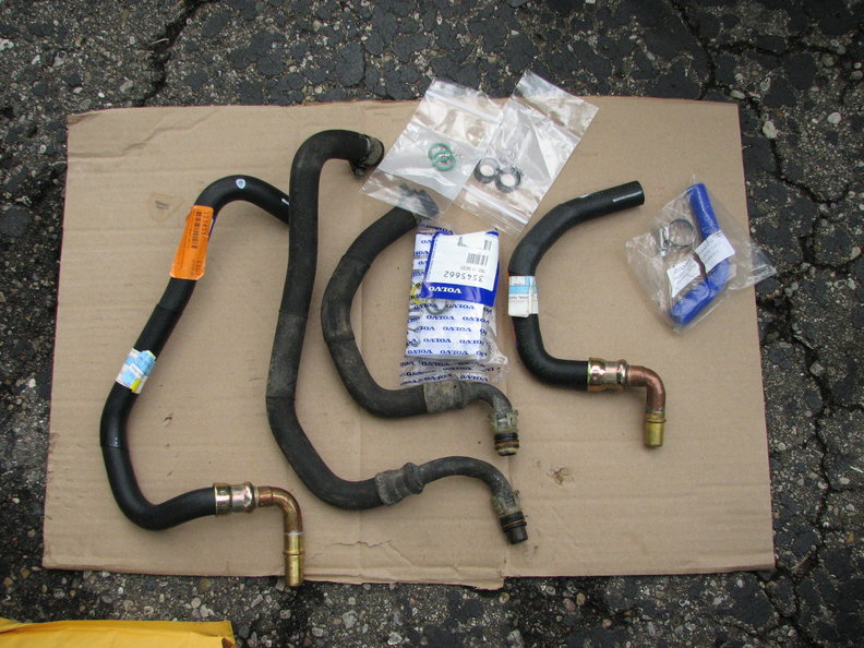

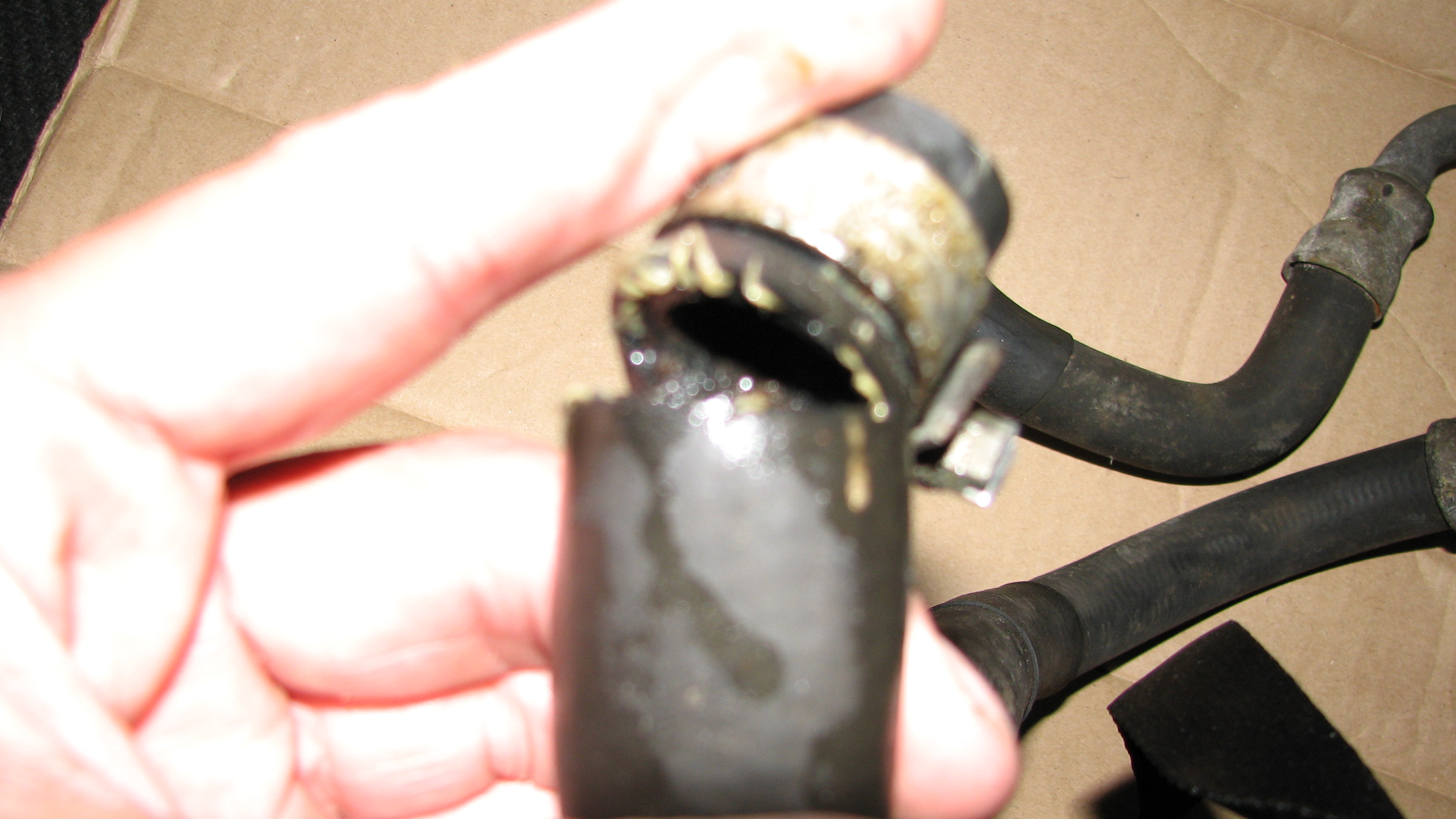

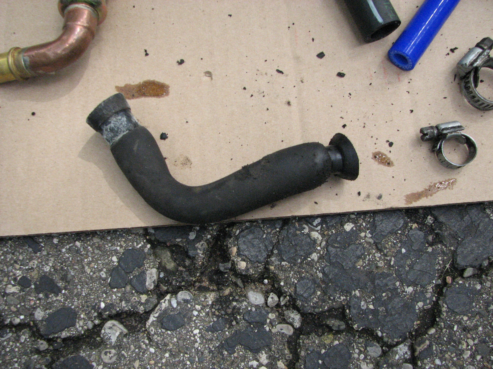

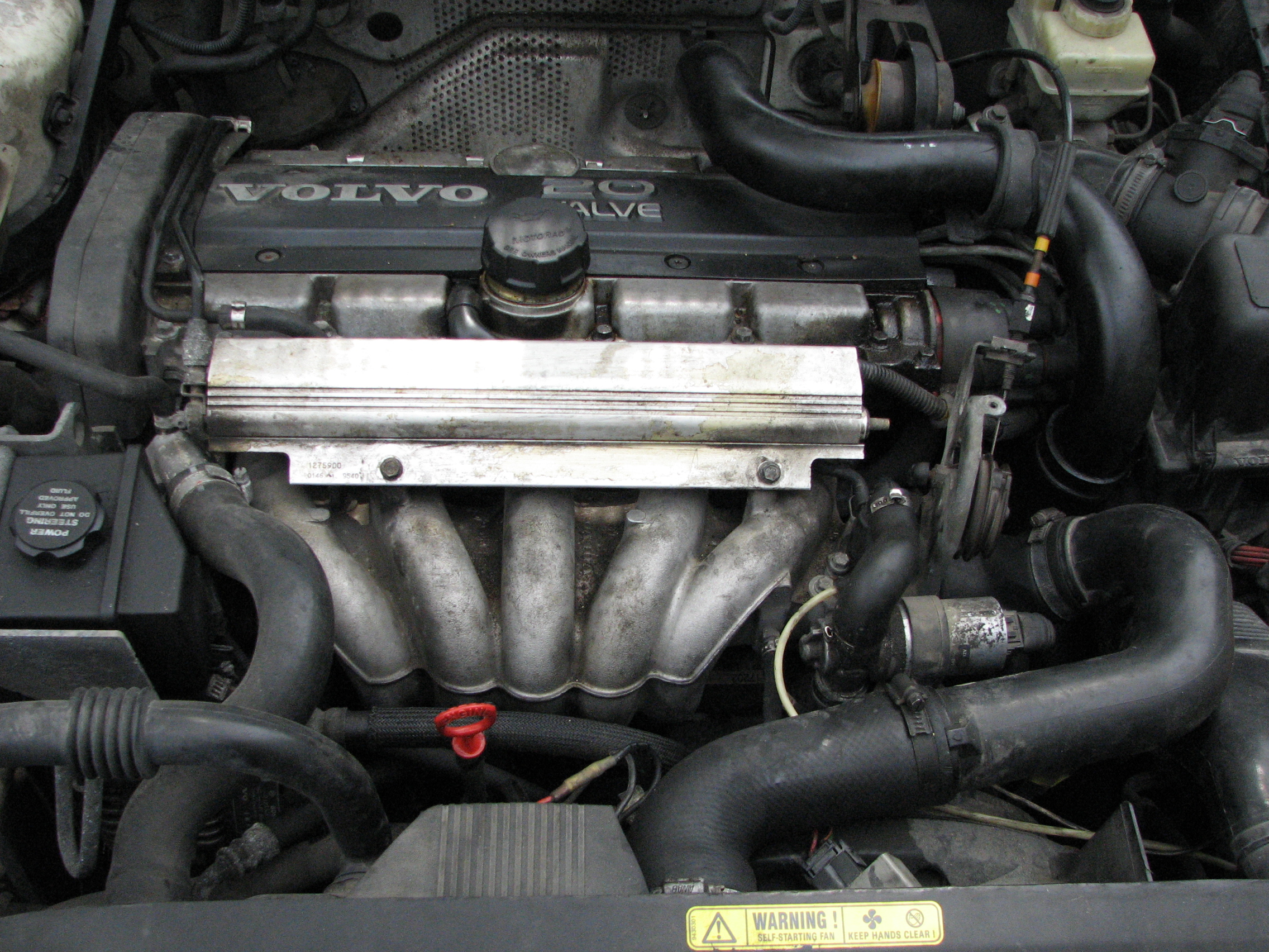

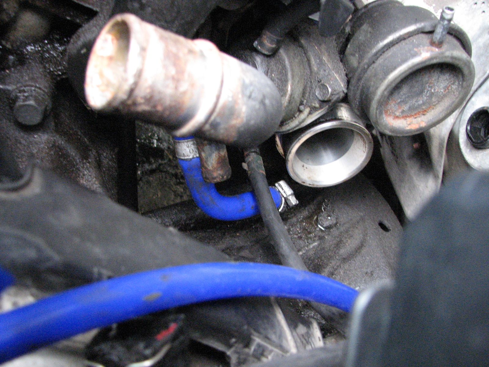

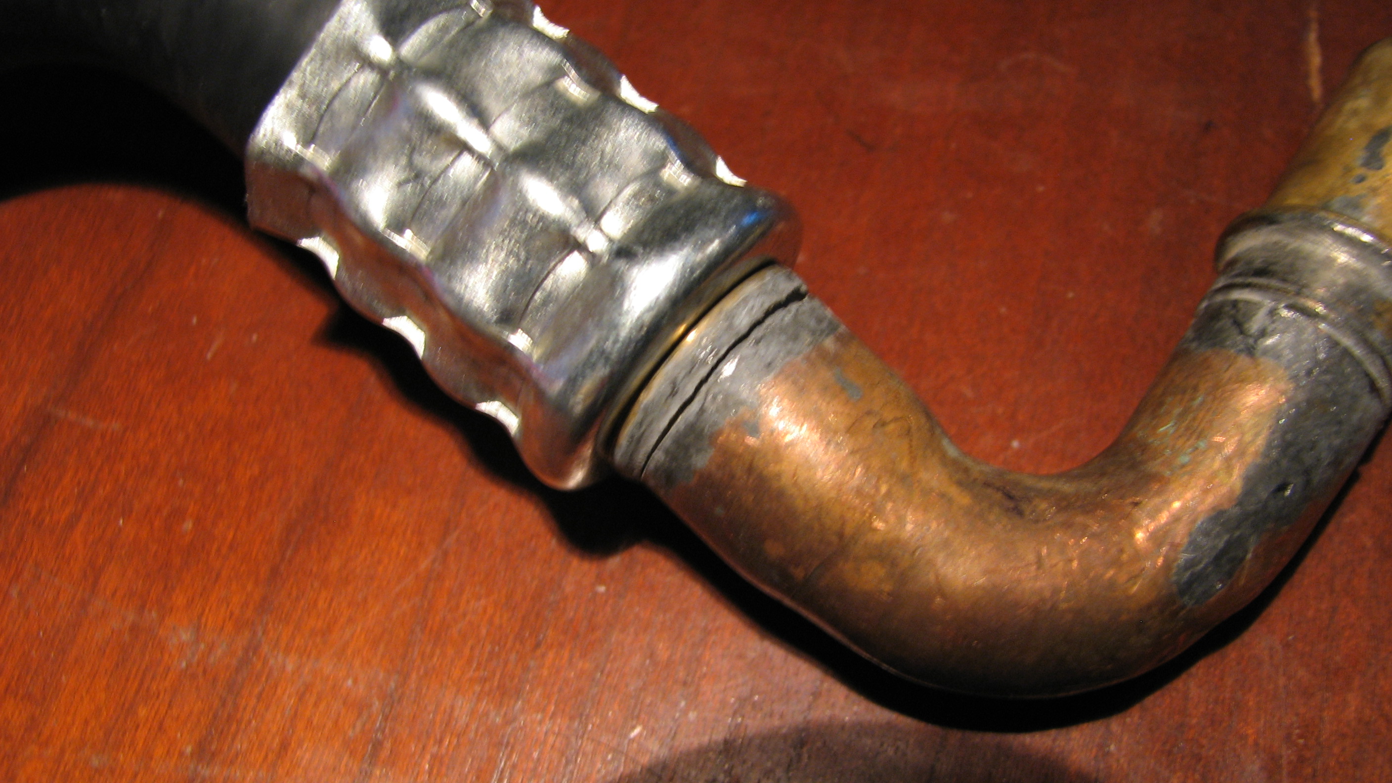

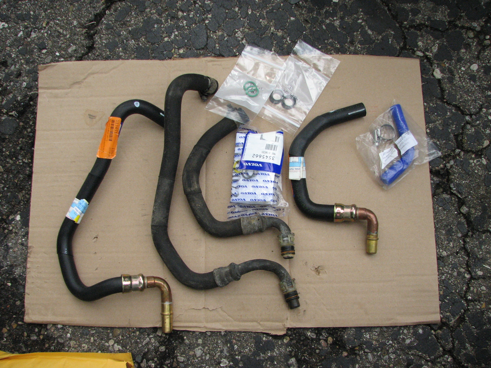

I had replaced everything plumbing related except the heater hoses, and the turbo coolant return hose.
Before photos a couple posts above.
The car drove fine all summer. Put on a couple thousand miles in a few long trips.
I blew a heater hose a half mile from home while pulling out of my local gas station.
I have to also thank one of our moderators Steve, "abscate" for bringing the OE Volvo replacement hoses with him on a business trip in my area to assist in avoiding potential delays in return and backorder issues I may be having.
Great to meet you Steve. Thanks so much, and I look forward to a chance to return such a favor.
I had cracked the coupling when I removed the old hoses, so I have a new heater core, and coupling with the tubes scheduled to be here in two days to be at complete ease with the coolant lines for a while.
I am still able to reach the couplings in the engine compartment so I put everything back together.
The rest will mostly be work inside the car to remove and replace the heater core, tubes, and junction couplings.
The only thing left is the metal pipe to the block with the multiple fittings. It seems fine.
