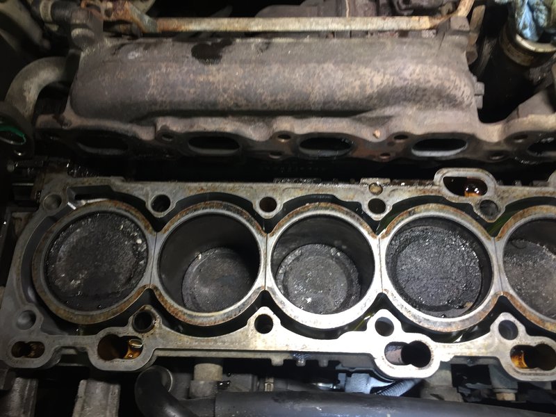

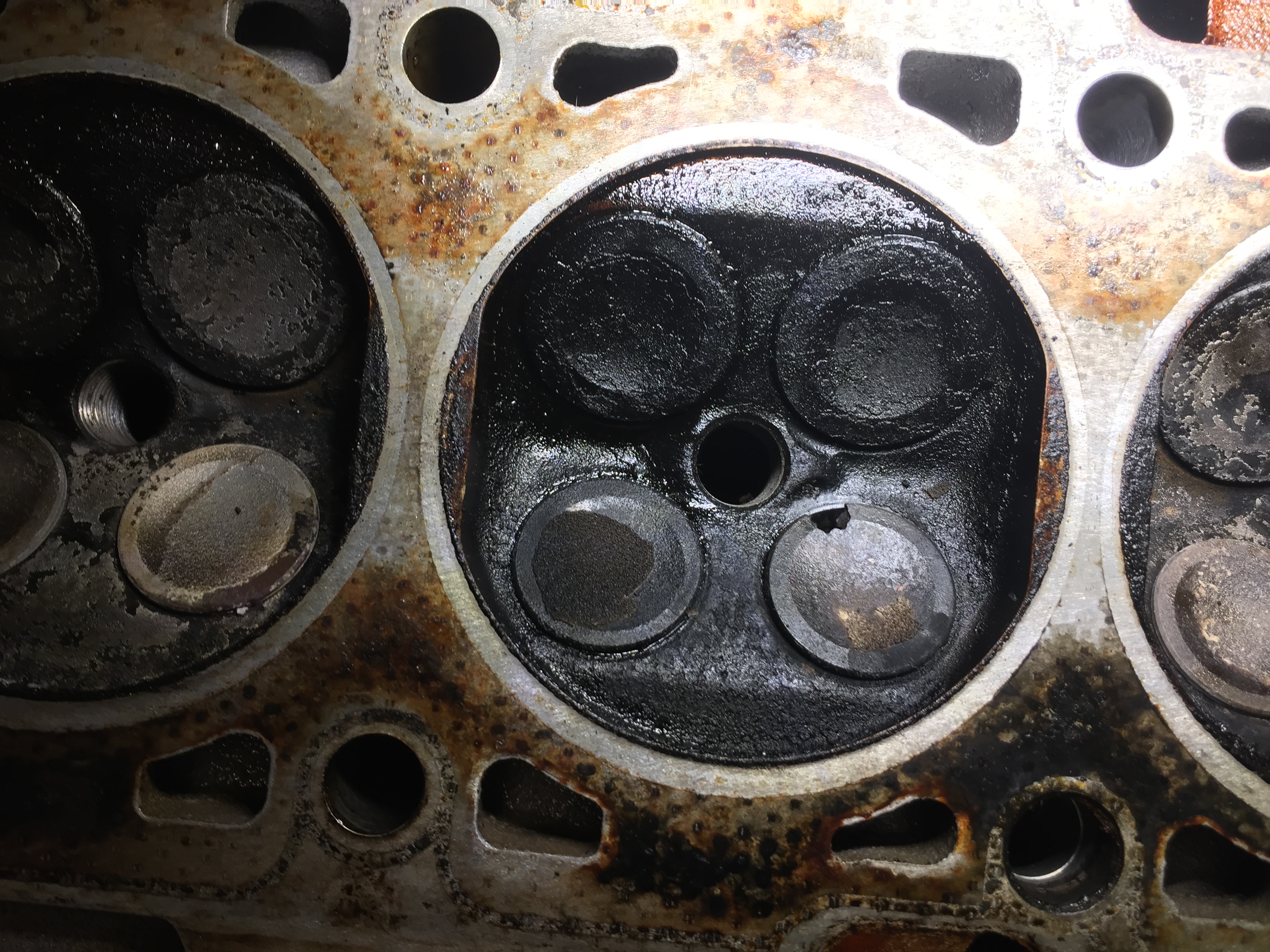

Well guys, I'm back... and I finally had a chance to dive into the head. 8 hours later, and I finally finished the disassembly; for those that guessed a burnt valve ( and that's pretty much everyone), you are correct! It did run smooth at higher speed, though. Anyways, here are a few pics of the cylinders and valves. Anybody have a good idea for cleaning up the top of the cylinders? They look like a bad oven in need of Easy Off...

Chippy chippy little chip (not sure what that means, if anything ...).
Some people will say to not clean the pistons. I like to clean the tops, here's what I do: raise the piston to the top, coat a couple of flat layers of paper towel with a good carb cleaner (my favorite is B-12 Chemtool), lay the paper towel on the cylinder, then put a small pane of glass over it to stop the carb cleaner from evaporating. I use glass because I happened to have some in the garage when I first needed to clean a piston but anything flat that stops evaporation would do, e.g. a piece of flat sheet metal, etc. The glass needs to be wider across than the cylinder and its sleeve. Walk away, leave it 10-15 minutes, when you come back the majority of the crud will wipe right off. Do a second round if you need it, you probably will with those.
Then turn the crank until you raise the next piston to the top, and go to work on it.
Make sure your work space is well ventilated, otherwise the cleaner will get you dizzy in a hurry.

Those piston tops are the worse I have ever seen. As they said, DO USE VOLVO valve stem seals, ask me how I know... Doing the head job the 2nd time is a lot less fun than the 1st.
As for the build up on your pistons, what's going on there? My guess is that you have a PCV issue or the turbo is blowing oil into the intake.
What fuel do you use?
What oil do you use?
Was the PCV in need of replacement?
Does the turbo have shaft play?

Yes, I agree that they look quite horrible. The previous owners (I'm the 5th owner, ugh) did not service the pcv system (ever) and I did it about 8k ago at 180k miles. The damage is done, though: oil seeping out of pretty much every seal. As far as I know, the turbo is ok, though that will get my attention after all of this. I've been using 91 octane since I got it, along with Mobil 1 10w30. The first owner really babied her; I have the original service records with the dealer stamps in the maintenance book. After that, though, she was neglected. I'm slowly bringing it back to life..

I wouldn't clean that off but I'd try running some injector cleaner through there every 1000 miles and check it after 10,000 to see if they clean up any. Put one of those cell phone scopes through the spark plug hole on #4 since it looks worse.
