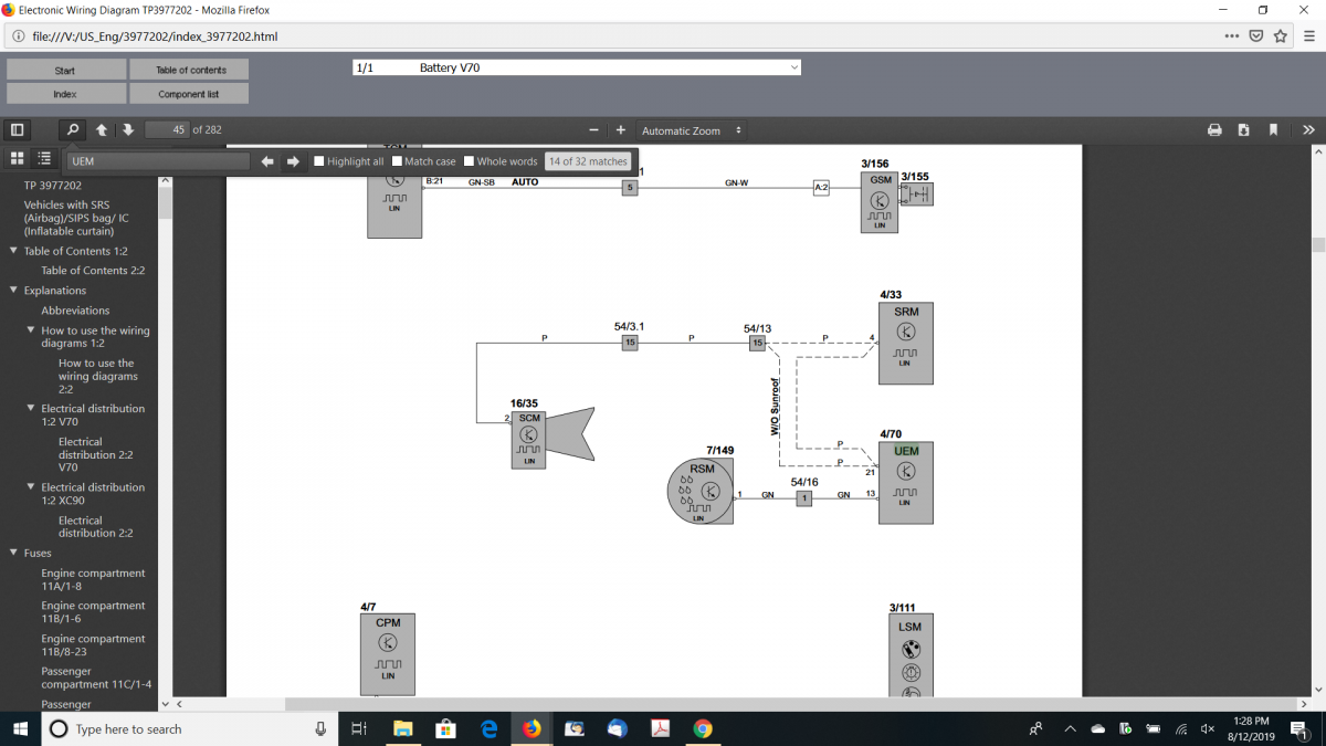

The Sun Roof (SRM) and the Siren (SCM) share the same CAN Bus from the UEM.
The Rain Sensor Module (RSM) is working, From that we can deduce the UEM is working.
The UEM is in the rear view mirror. I'll go after the connector to the mirror/UEM.
