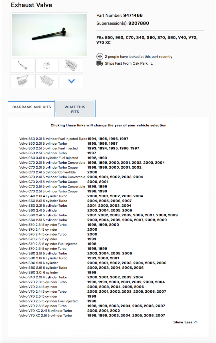

So I thought I found valves but in checking the volvo web site it shows part number 9471466 for both turbo and non turbo. So is everyone sure the 850 turbos did in fact come with there own sodium filled valves? Seems very much like I'm on a snipe hunt for sodium filled valves for these things. No part listing state sodium filled. Even on fcp

Just called fcp. They have no idea on the sodium filled valves for turbos. And checked volvo parts lists that the turbos in fact came with the same valves as n/a's.
This has me dumb founded.

Thanks volvolugnut. Looked at those places already too. Nothing special about the turbo exhaust valves still the same part number as non turbos. The 9471466's so I'm beginning to think all this hype about turbos having sodium filled valves is bunk.. At least with the 850's
Looking at Intervalves replacements now. Heat treated hardened stainless. $254 a set of 10

Fir the 1999 models, IPD list the turbo models as sodium filled.

The IPD sodium valve above is 6mm dia. Earlier post seems to indicate 7mm is needed. I don't know which is needed, but noticed the difference.

I pulled up my 1999 for that ad as I knew it had the sodium valves, your 1997 may well be different.The IPD sodium valve above is 6mm dia. Earlier post seems to indicate 7mm is needed. I don't know which is needed, but noticed the difference.
Current status, unresolved - the current attached photo from Volvo webstore isnt awe inspiring as I know there was a valve stem size change in 1999 but that picture implies one part number fits all VINS 1995-2005.So is everyone sure the 850 turbos did in fact come with there own sodium filled valves?
