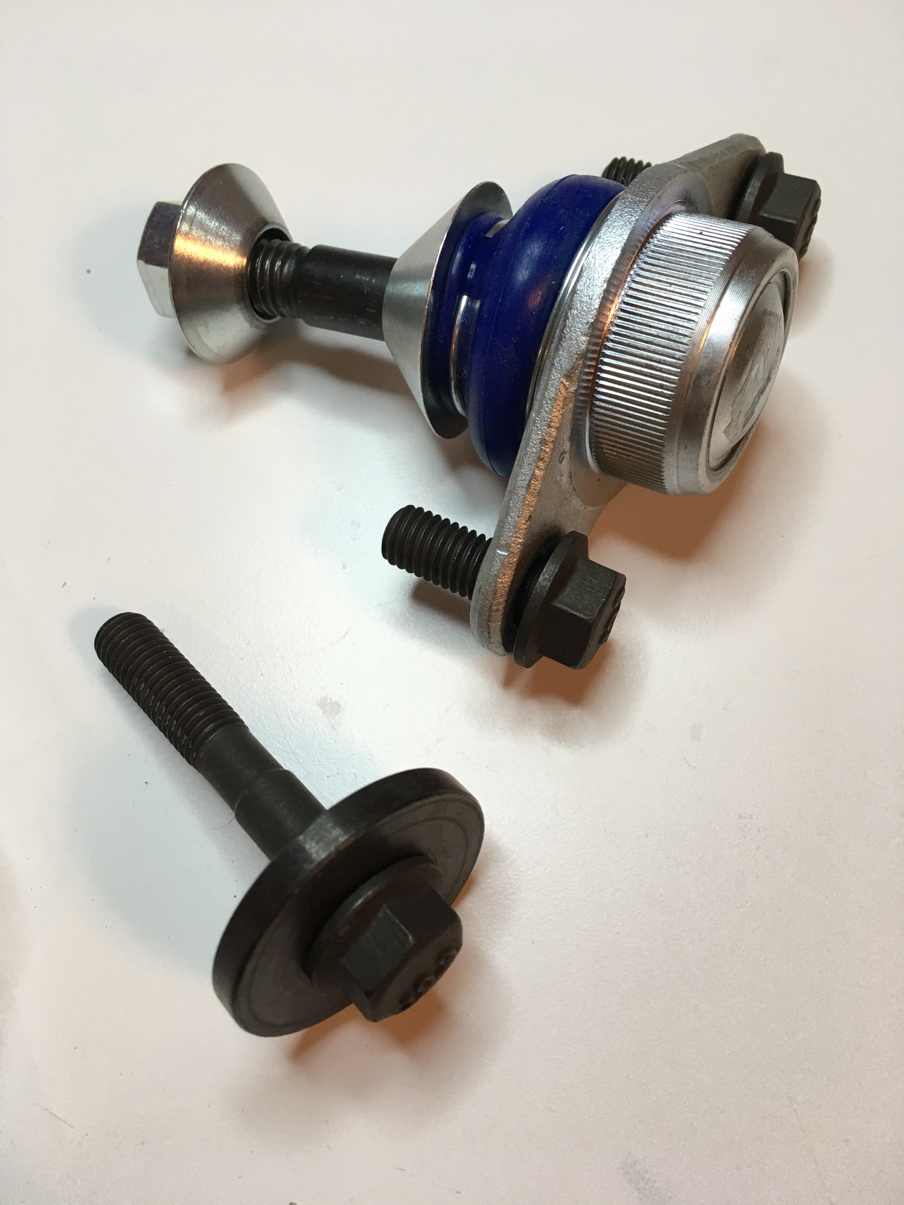

Just bought $75 of secret sauce Toyota 3309 ATF, ouch (12 liters). And lookie here, Porter!...the nice people at ipd included axle bolts with their shiny new ball joints! I can just put them in now, right, I'm not using old control arms. A 2" galv pipe fits perfectly over the boot, with a cap to hammer on. Let's try it!

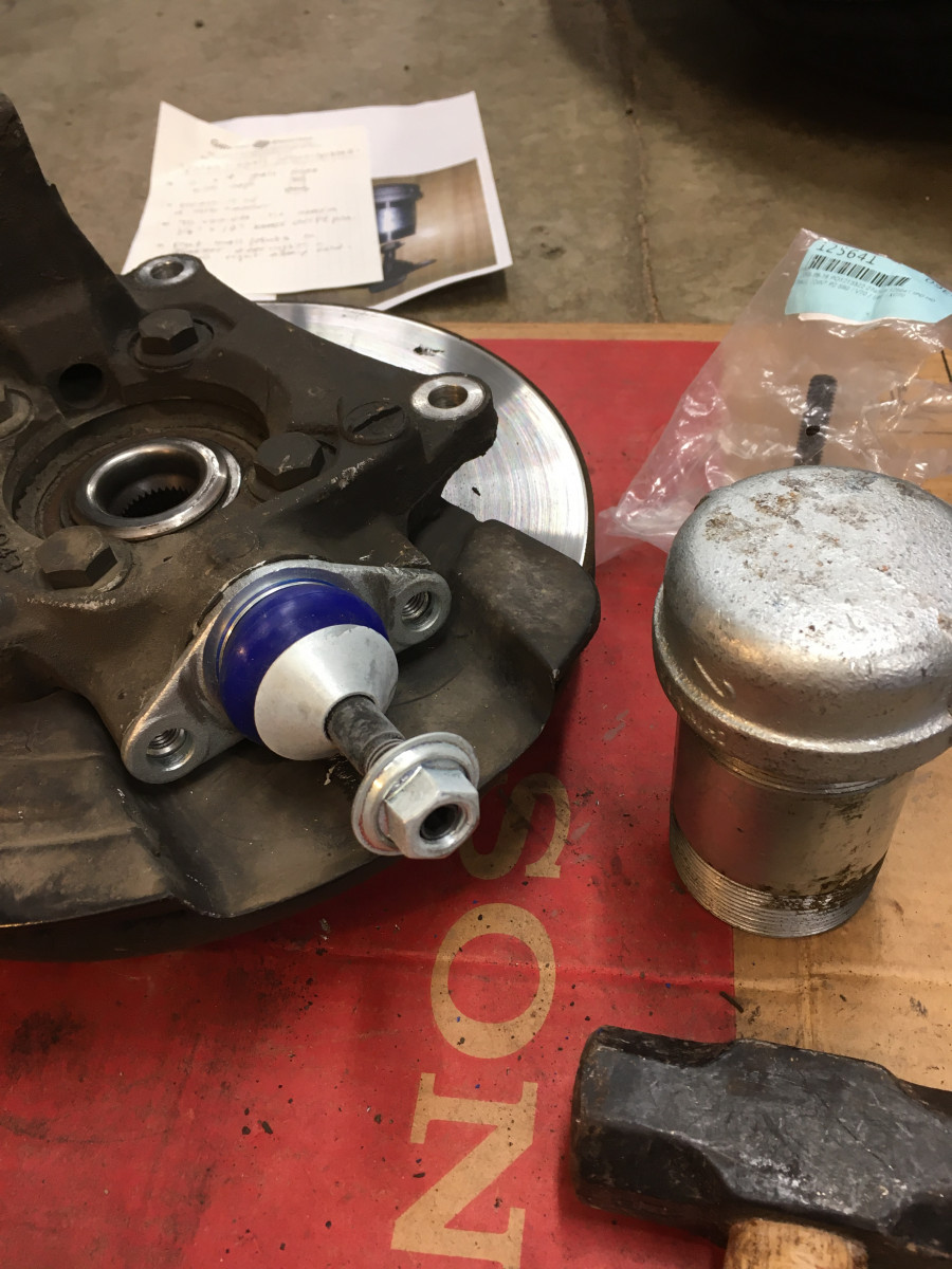

The ball joints go in pretty easy, but you’ll probably need to have your knuckle off the car & in a vise. Leave the plastic boot protector on if they came with them.
The very first time I had to put ball joints in I was at our cabin in the middle of nowhere & had to use the screws to pull the ball joint into the knuckle. It worked but I wouldn’t advise doing that. You could use screws as alignment dowels.

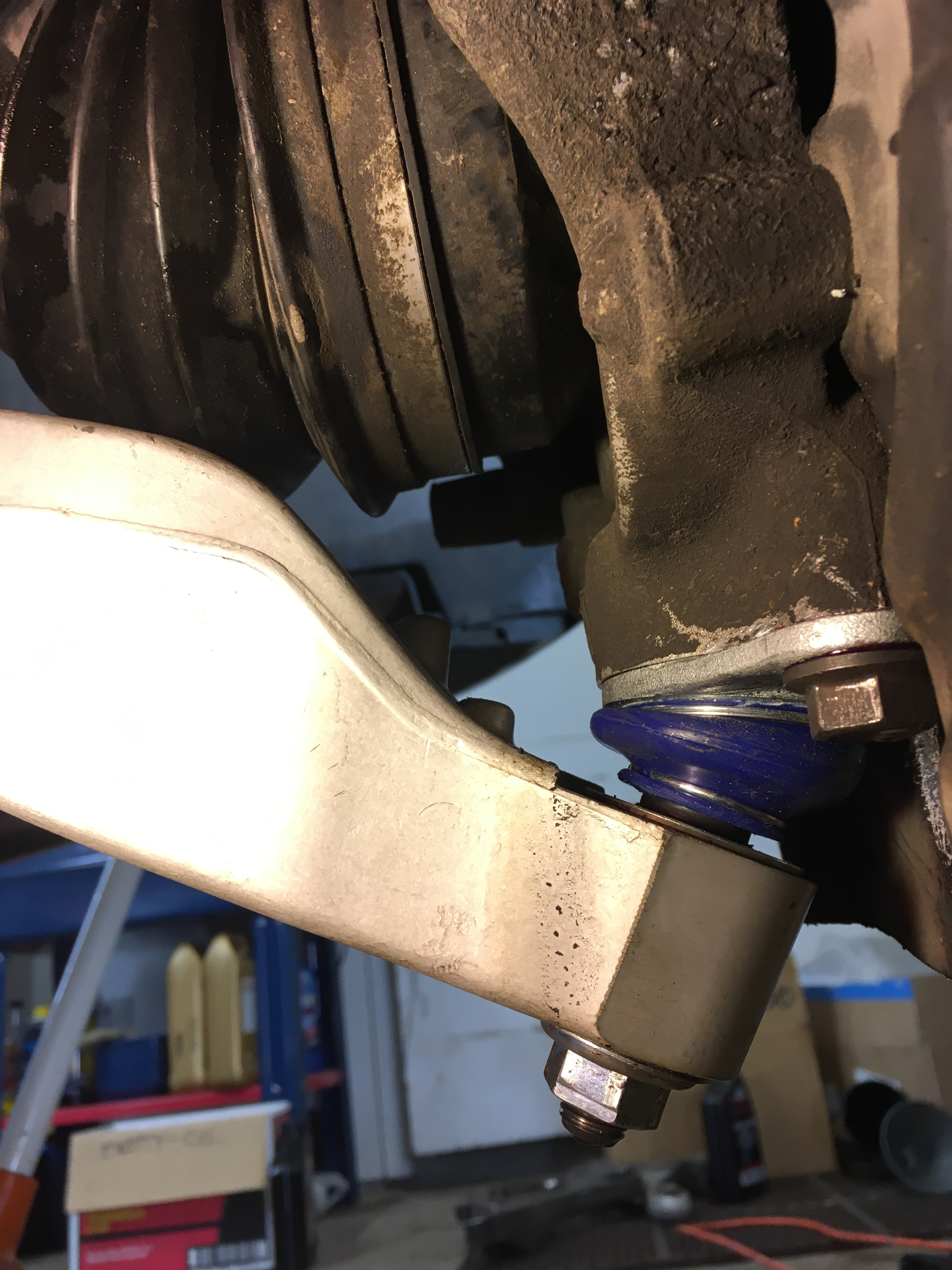

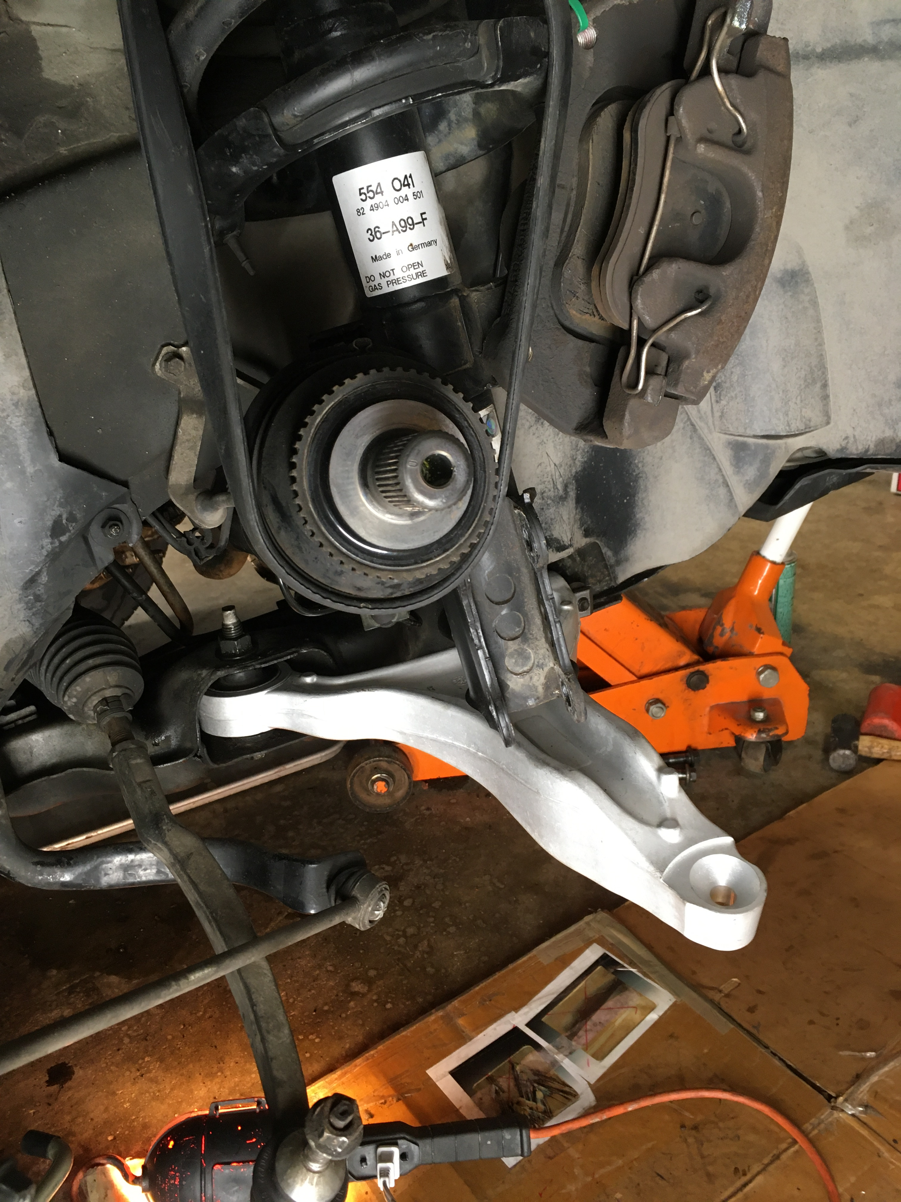

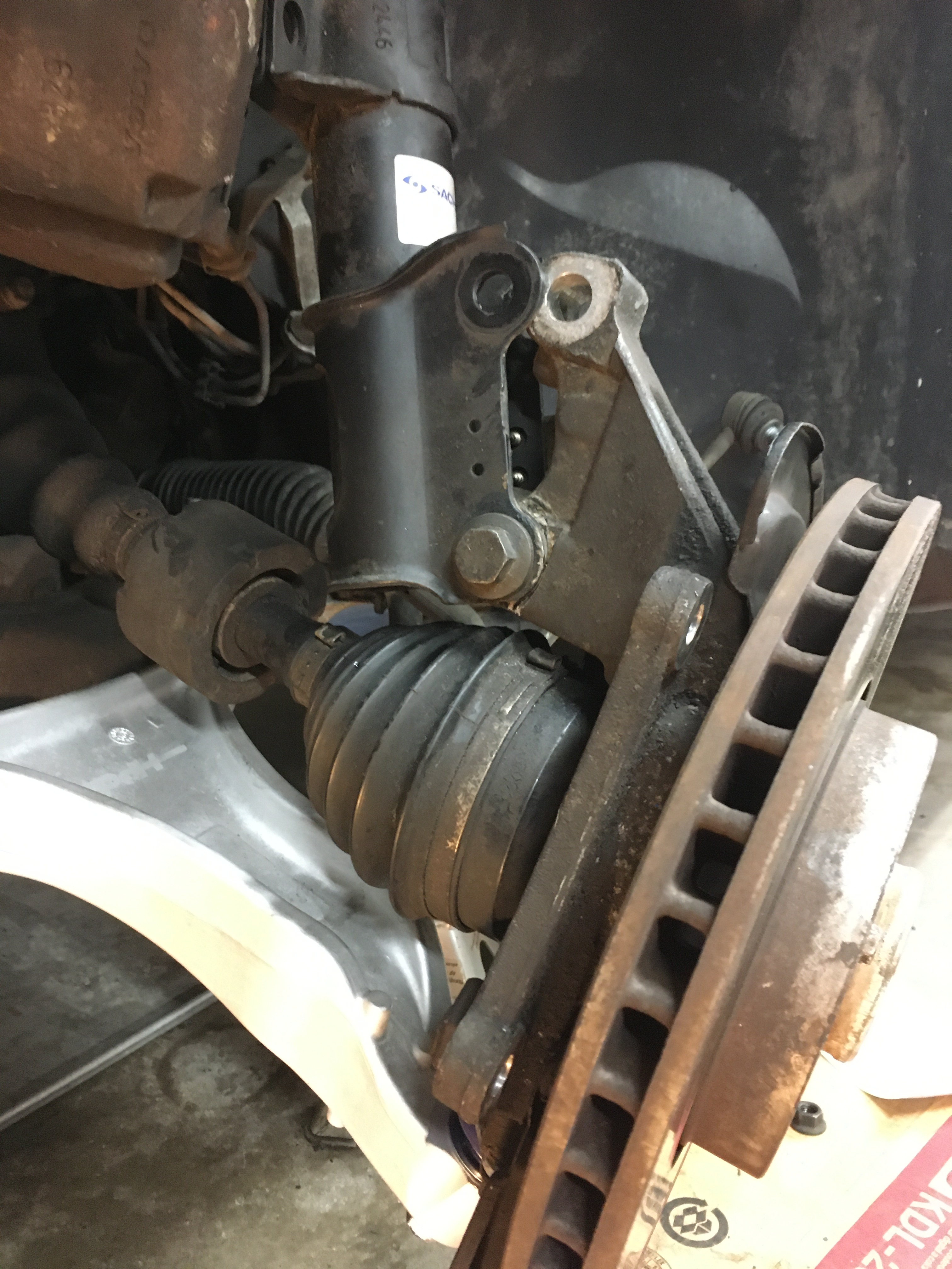

Welp, she's back on the ground on all four wheels, new control arms and ball joints. Man, that's a bear of a job, no wonder those guys use air guns. Big bolts, high torques, limited clearance, hand tools. Funny, the worst ones to get off were the tie rod end ball joint nuts - somebody must have blasted those on there with air tools. Anything I put back together earlier with anti-seize came apart nicely. I didn't have to do any straps on control arms to pull them down, just horsed the hub down and in and aligned the lower strut bolt hole. Tapped the bolt in and everything went back together. Maybe that's an easier XC vs V70 thing, I don't know. Also no motor lifting for clearance underneath - used short sockets with wobble joints as well as box end wrenches. Slow and careful is slow.
Oh, and the 2" galvanized pipe with a cap on it was genius to pop the ball joint back into the hub. 2 1/2 lb hammer, no problem. I will look up the member who suggested that and thank him.

Oh, another couple of things about the control arm job relative to the FCP Euro replacement video -
Many of my bolt head sizes were different than what he shows. Maybe differences in model years, or AWD vs FWD?
My car had no steering stop to fall off the caliper. He shows a loose bar as part of the caliper assembly.
My car had no steering bump stops on the control arms to swap over - no holes or fittings.
Putting the new ball joints in the freezer overnight seemed to help when installing them.

V70/R control arms have the steering stops/bars like in the video, XC control arms do not.

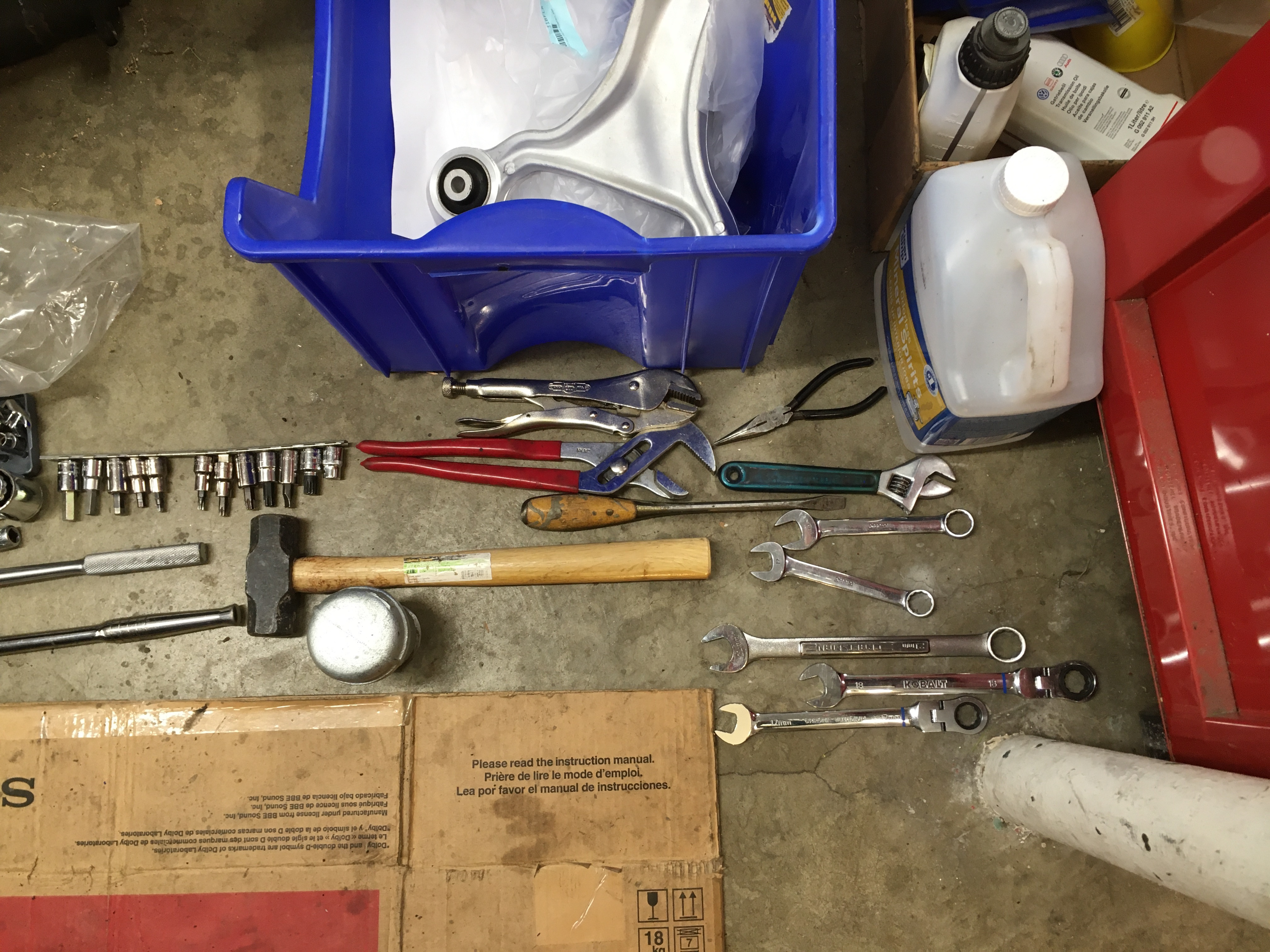

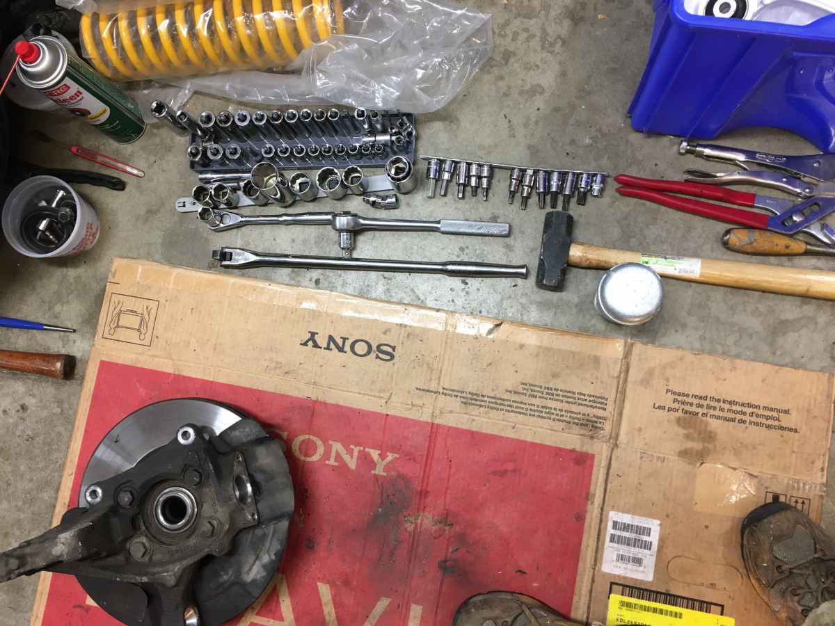

The tools I used. Some long box ends would have been useful. I hook two together for more leverage - old trick.
Bushing rubber was cracked and torn on a couple of them.

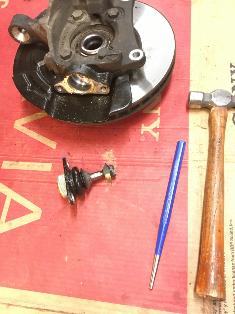

3/16 x 12" drift / punch worked well. Popped off fairly easily.
Galv pipe to seat the new one was brilliant. Shove hard down and in towards the engine, get that bottom bolt in. May have hurt a rib on the sharp edge of the rotor.
