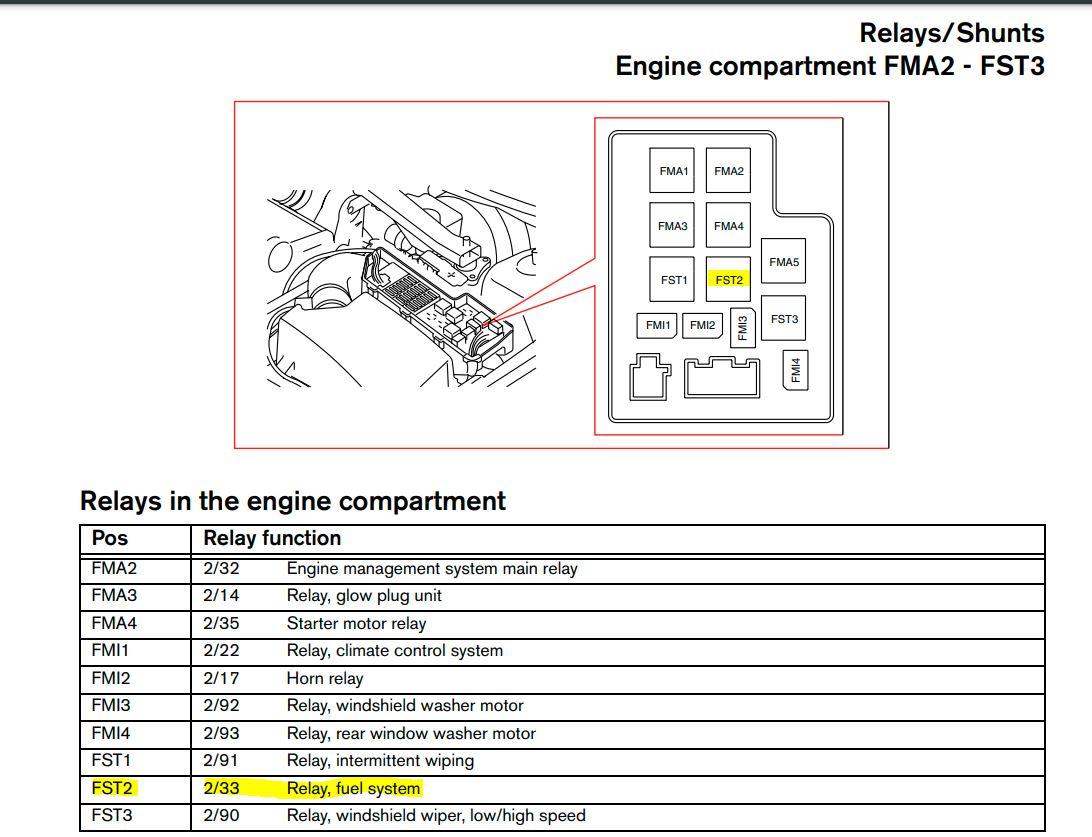

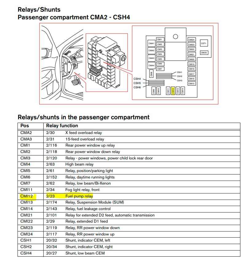

Curious to hear Xemodex's diagnostic results on your modules. I poked through the EWD of your car and found two relays related to the fuel system. Did you ever have a chance to test those prior to shipping the CEM off? Relays are only rated for a certain number of cycles. Maybe yours sticks on a cold day? I ask because one of your posts you mentioned the fuel pump wasn't running which to me means it wasn't being fed power. PEM is obviously in good shape so I imagine it's sending a proper demand signal but I wonder if the pump itself wasn't being fed with the 12V.

I did check the connections for corrosion and did not see anything. I replaced the relay on the inside of the vehicle but did not check the one under the hood. I’ve been searching the internet and forums about this cold weather issue for over a year now. I’ve seen a few other people with this issue but no solution to fixing it. It seems like most people give up and trade the vehicle in. It’s very odd how cold weather is telling the fuel system not to pressurize.br0dy519 wrote: 06 Jan 2022, 19:20 Curious to hear Xemodex's diagnostic results on your modules. I poked through the EWD of your car and found two relays related to the fuel system. Did you ever have a chance to test those prior to shipping the CEM off? Relays are only rated for a certain number of cycles. Maybe yours sticks on a cold day? I ask because one of your posts you mentioned the fuel pump wasn't running which to me means it wasn't being fed power. PEM is obviously in good shape so I imagine it's sending a proper demand signal but I wonder if the pump itself wasn't being fed with the 12V.
