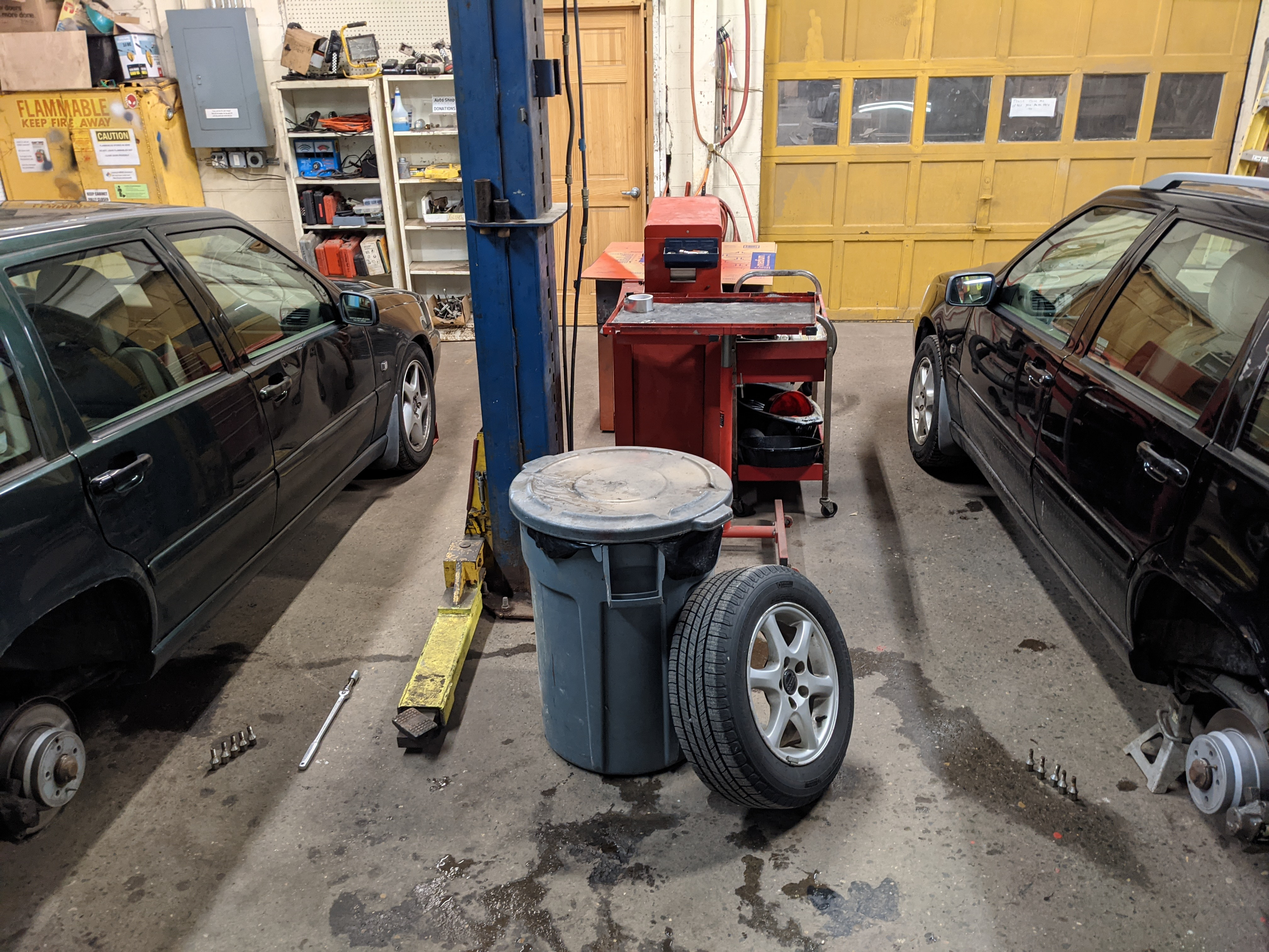

A stroke of bad luck hit me today. After doing some simple diagnostics at my local Makerspace, I ran over a chunk of scrap metal and slashed the entire sidewall of one rear tire. Geronimo is wearing studded snow tires. The front two are worn out but the back two were very nice. Now it has only one nice tire which is useless without a match with the same amount of wear. I feel responsible to buy all four studded snow tires, perhaps used if I can find them. This expense is going to hurt.
Despite the bad luck, I had some good luck. Though I slashed the tire, I had just picked up my car's tire from getting a repair, meaning I had a full size spare already in my car. In no time, I swapped my nice spare on to Geronimo and we were back on the road. Here's a picture of my car lending its tire to the cause.
With the rebuilt ABS module installed, the speedometer is back, only the coolant and check engine dash lights are on, and only two DTC codes remain. The ABS is acting up, so I'll research that and the codes before posting more.

Unless those wheel studs are posing for the photo, I would say you are very organized and this is part of the reason you have made great progress on the rescue.
Keep up the good deeds.
- Posts: 36147
Having met Firefox I was a bit worried that he was stressed, as one of the right hand row is slightly askew. He might have had a bad day.

Mine are scattered underneath the car where I kicked them trying to get up!

That is exactly what happened. I just caused $400 in tire damage, was late for dinner, and was wearing decent clothes instead of my nasty work clothes. The lug bolts kept falling over and, alas, that was the best I could do. I'm only half kidding...abscate wrote: 04 Jan 2022, 11:38 Having met Firefox I was a bit worried that he was stressed, as one of the right hand row is slightly askew. He might have had a bad day.
I keep the threads of the lug bolts (and all bolts) off the ground so they don't get dirt in them. It's easier to be preventative than to meticulously clean grime out of bolt threads (with a brush, rag, or razor blade, ask me how I know).
