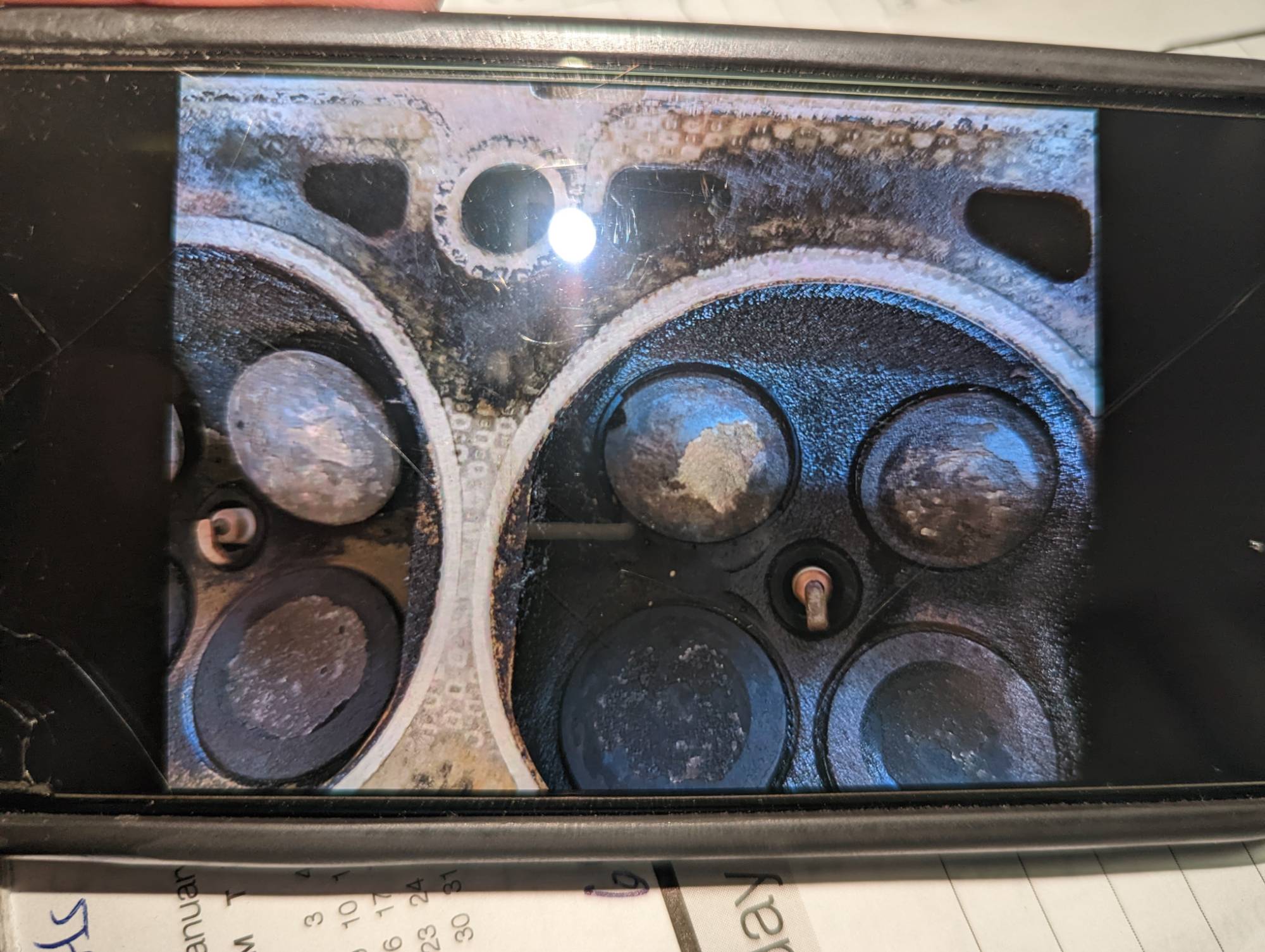

Updating you nice fellows. Got the car back after 4.5 weeks in the shop. Small shop, covid outages, etc.
All put back together, it runs smoother than I ever recall. The engine is calm as a rock at idle, and stays calm as it revs up
Several internal parts fell apart as they did the job, so there were additional parts needed, crankcase breather hose, new headbolt set, etc. All said and done, it put me $2900 back.
Haven't driven long enough to check gas mileage. It had been on the low side with the burnt valve. Pic attached fyi.
