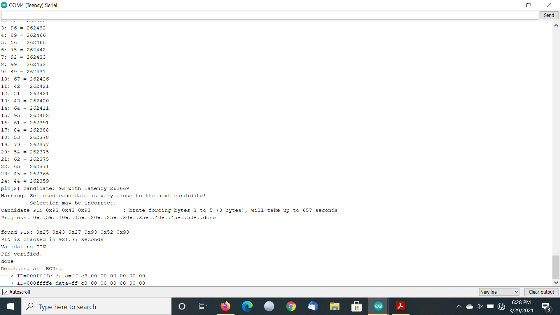

RickHaleParker wrote: 23 Dec 2020, 19:25
vtl wrote: 23 Dec 2020, 17:41 CEM must be powered on within 5 seconds after "sending CEM into programming mode" is printed.
Is this correct?
Process to get CEM into programing mode.
1. Power on cracker.
2. Wait for "sending CEM into programming mode" in the terminal.
3. Within 5 seconds power on CEM.
On the bench:
You need to be able to switch the Cracker and the CEM separately.
In car:
You power the cracker with the +12V on the OBD port, Which is always on.
1. Key in POS 0.
2. Insert Cracker in OBD port.
3. Wait for "sending CEM into programming mode" in the terminal.
4. Within 5 seconds turn key to POS II.
How do you know in advance which com port the Cracker will show up on?
vtl wrote: 23 Dec 2020, 19:37 That's correct for on the bench. I haven't tried it in car yet (burnt valve), just finished a 3.5 months long engine rebuild.
You can just open a serial monitor/console on the correct port with the code running and press reset on the Teensy.
Today I Breadboarded a PIN cracker and got the answer. When cracking the pin in car, don't even bother to put the key in the ignition.
When the car is turned on the CEM will not respond to attempts to unlock the CEM. My Breadboarded PIN cracker got it on the first try with the key off.
This has got me wondering if the cracker need the CAN-LS. Tommorrow I am going to pull the CAN-LS off the breadboard and and see if it will crack without a CAN-LS.

RickHaleParker wrote: 29 Mar 2021, 20:16 Today I Breadboarded a PIN cracker and got the answer. When cracking the pin in car, don't even bother to put the key in the ignition.
Congrats!
CAN-LS is only for shutting all the modules in car. All the job is done over CAN-HS.
No key cracking, huh? Just in case, don't leave the cracker being powered overnight, or you may find it in the morning with all the Volvos in your neighborhood cracked over the air, because who knows?

vtl wrote: 29 Mar 2021, 21:17 CAN-LS is only for shutting all the modules in car. All the job is done over CAN-HS.
I'm thinking because the key needs to be on to run diagnostics. The control modules on the CAN-LS might be offline anyway. If that is the case we can reduce the complexity by eliminating the CAN-LS.
It did get the PIN with the KEY in POS 0.

RickHaleParker wrote: 29 Mar 2021, 21:24
In diagnostic mode you need to power up modules like the ECM, ETM, ABS which are fully sleeping without key in pos II, otherwise they won't return any dtcs.
The CEM goes into sleep mode but is always listeneng and wakes up by the 1st can message it gets.
On previous page i demonstraded a minimal working setup with just 3 wires to the obd socket that works without key in.
