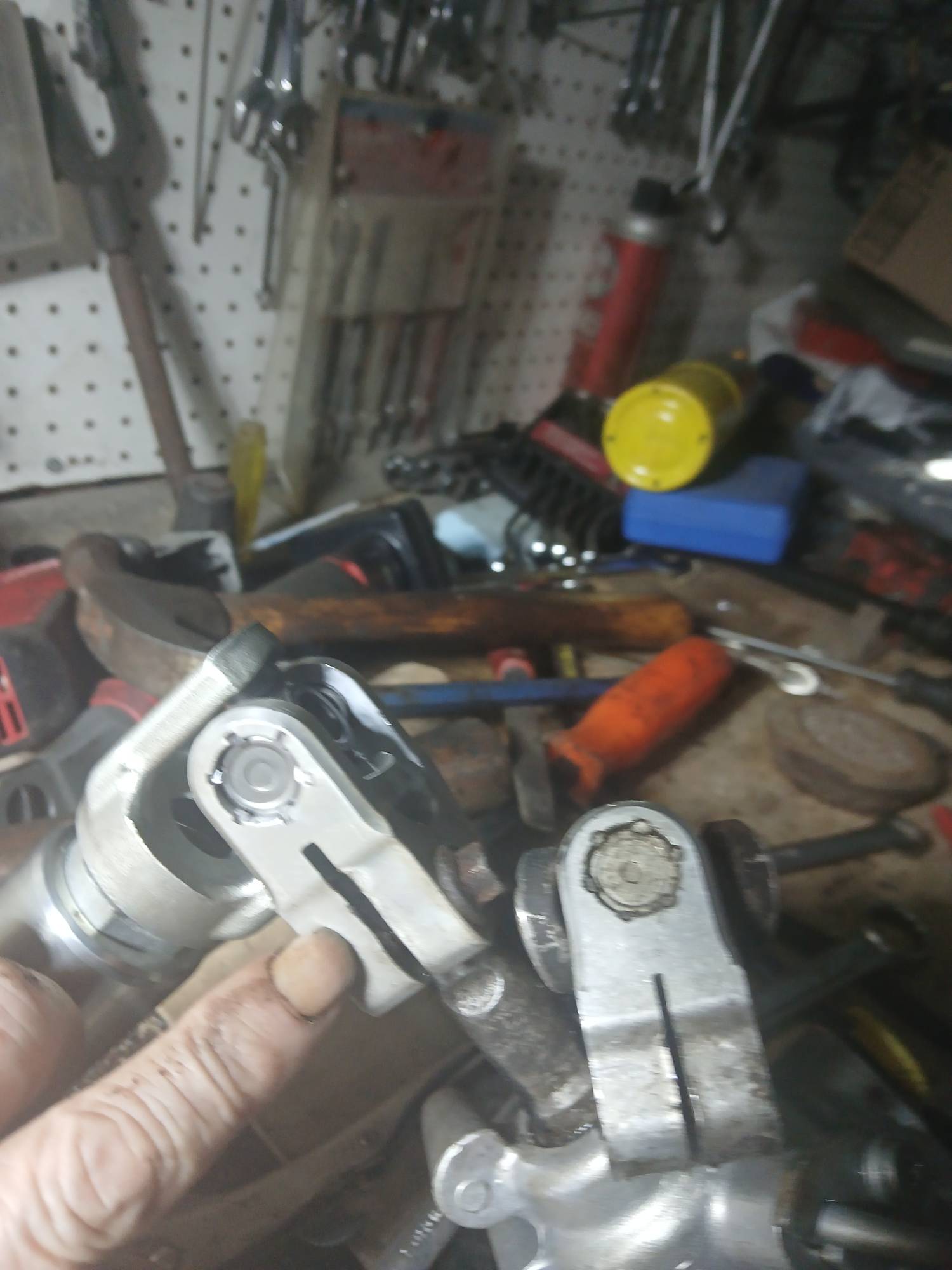

I ordered the steering coupler Ujoint on Monday from FCP, it was at the door by Weds via Fedex, that beats amazon.
Fitment verified by VIN for exact fit is peace of mind.
Modification (not me) , the gap is a lot wider for the pinch bolt, thats going to make it easier to expand if its still in the car.
I had to beat the original off with a hammer and chisel.
New vs original design.
