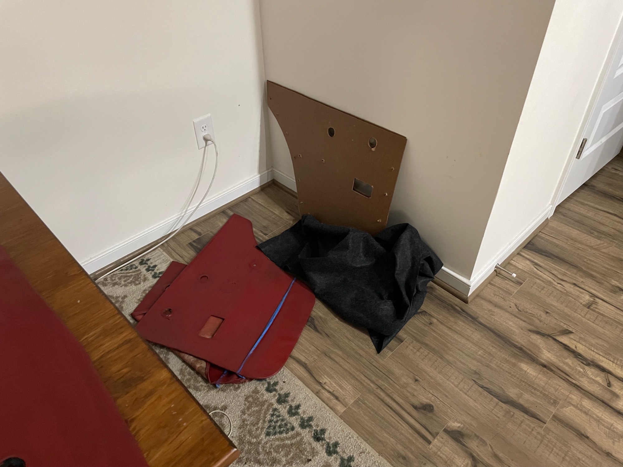

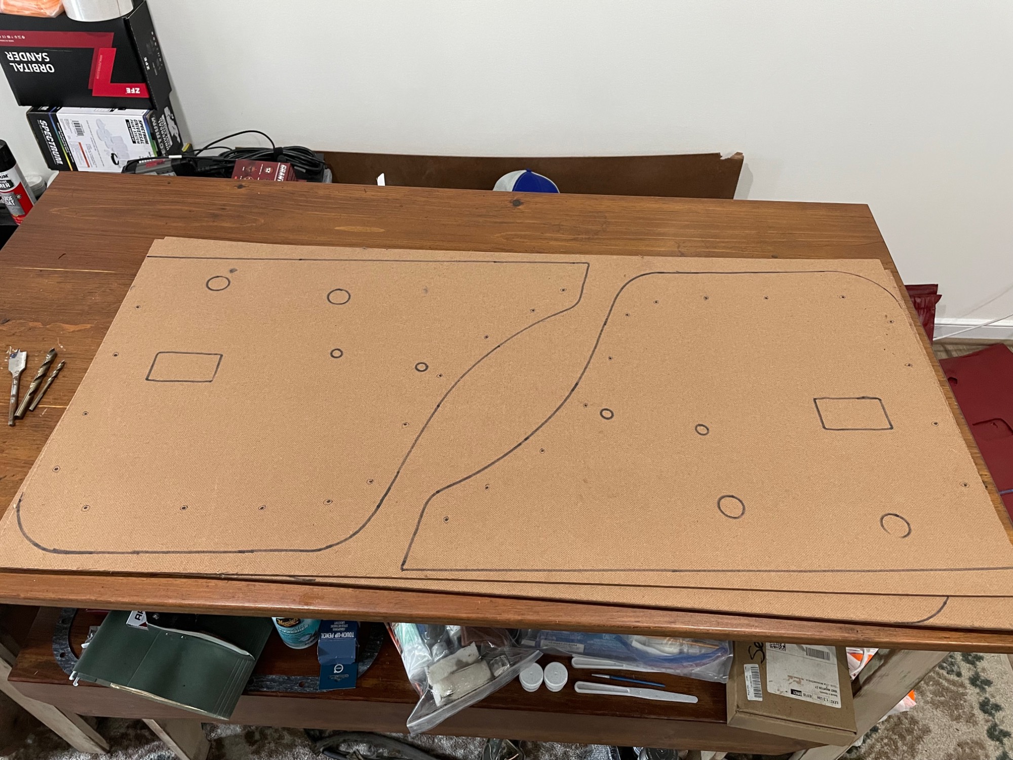

I bought 1/8” tempered hardboard. I have all the vinyl removed from the old panels and traced them to the new hardboard. The holes in the doors did not have a moisture barrier at all and all the weather stripping is shot. I bought some butyl tape and some 2mm plastic sheeting and will do those up like the newer cars. I’ll replace all the weatherstripping and seals when I strip the car down to paint it.

I am trying to remember from 40+ years ago if any of my amazons had plastic liners in the doors and I believe they just had a butyl type material and clear plastic sheet. The sheet was fairly heavy like the vapor barrier in houses.

I’ve seen some YouTube videos where Amazons have had plastic taped over the holes only, not the whole inner door. I actually got pretty far tonight. I cut out the panels and completed the two front doors.
