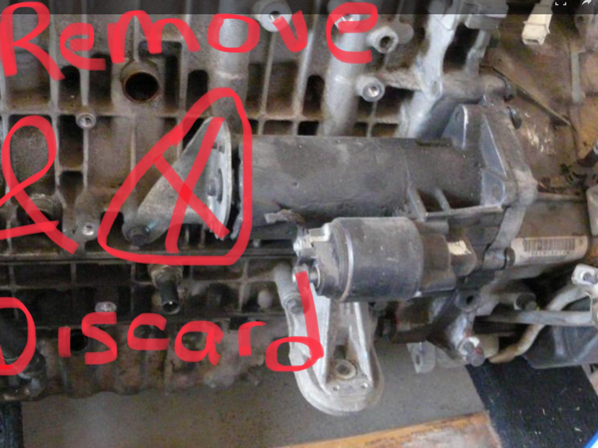

Anyone installed this starter without left hand bracket? My original on my S70 98 has a bracket. I am looking on FCP Euro Bosh and it does not have a bracket: SKU: VOL-8251551. Any recommendation for aftermarket starters like Duralast from Autozone etc? Thanks
- Posts: 36149
- Been thanked: 4068 times
The bracket 9442201 was removed by Volvo on later models, so you can install your new starter without either the bracket or worries.

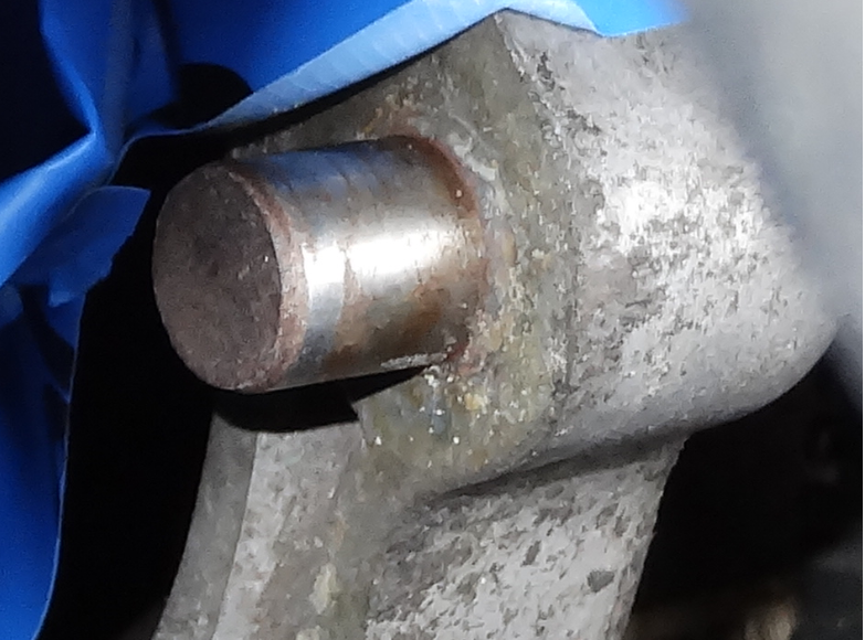

I've just pulled my starter and the pin (gap pin) is stuck on the transmission housing.What is the solution? It looks pretty solid. Should I find a starter without the pin? The replacement on FCP web site has a pin mounted on the starter. Is this pin removable? Can you remove it from the starter? Every replacement starter for my S70 98 I've seen has a pin mounted on the starter. Also I watched Robert on YouTube having the same issue. Check out 4:23 minute.
Unfortunately he does not show the solution.
Also I was trying to remove the automatic transmission dipstick tube in order to have more access to the lower starter bolt. I was able to turn the dipstick pipe around but I was not able to remove it. I unbolted dipstick's bracket (from harness and PNP). Stuck solid. Is there a secret to it? I was planning to replace the seal for the dipstick tube, but damn pipe does not budge. It moved upward just tiny bit. I thought that it's similar to the engine oil dipstick pipe... I will post some pictures tomorrow.

Here is the picture of dowel pin stuck in transmission housing. Robert DIY suggested to pull the pin with vice grips. Just wondering: from the transmission or the new starter? The pin on the transmission looks pretty solid. All replacement starters seem to come with pin mounted on them.

So just in case, it would help anyone in the future. I ended up buying a used starter, and I have taken it apart, cleaned, and installed it. The used starter was in working condition, but inside I found tons of dirt mixed with oil. Here are some details of the process. They are not listed in the order of disassembly and reassembly. You can figure out the actual order by watching the youtube videos linked below.
The guiding pin got stuck in the transmission housing upon removal. I removed the pin from the new "used" starter with Channellock. Cleaned the stuck pin on the transmission housing with sandpaper.

Most of the replacements don’t come with the bracket posts, and Volvo wrote a service bulletin ca.2002 deleting the rear bracket
