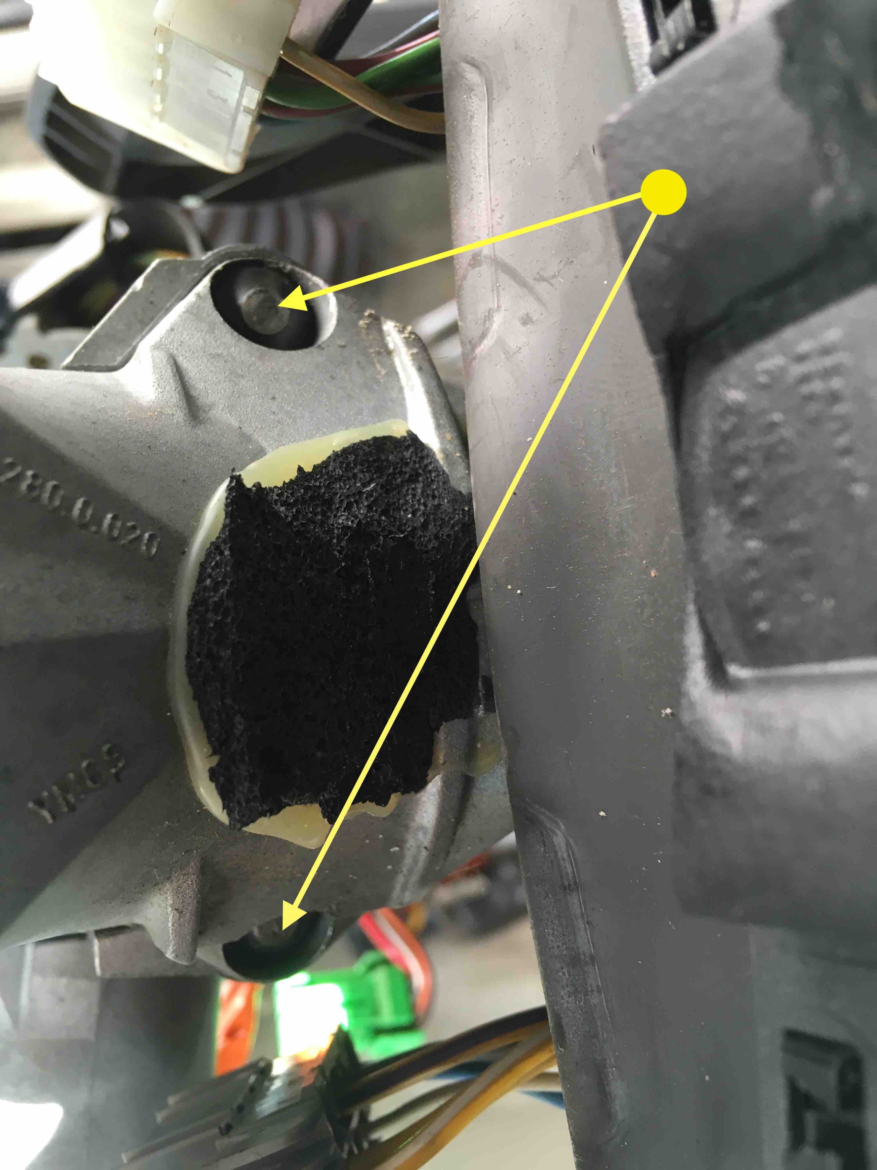

Hy,MadeInJapan wrote: 24 Nov 2013, 10:29 Write up was very helpful but the bolts did not come out at all. This is what I ended up having to do on both sides:
Glad it's done!! Works without any issues now.
