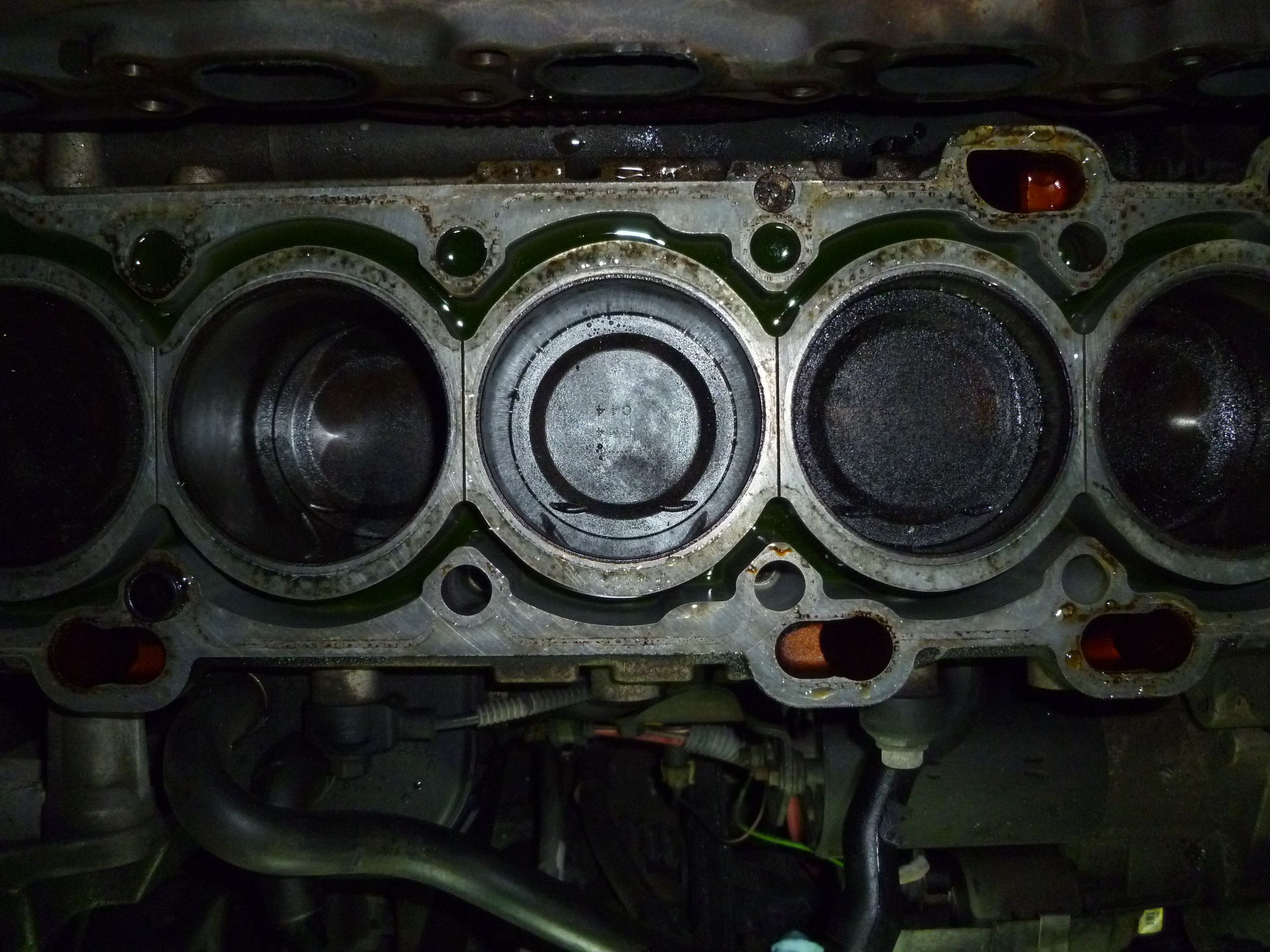

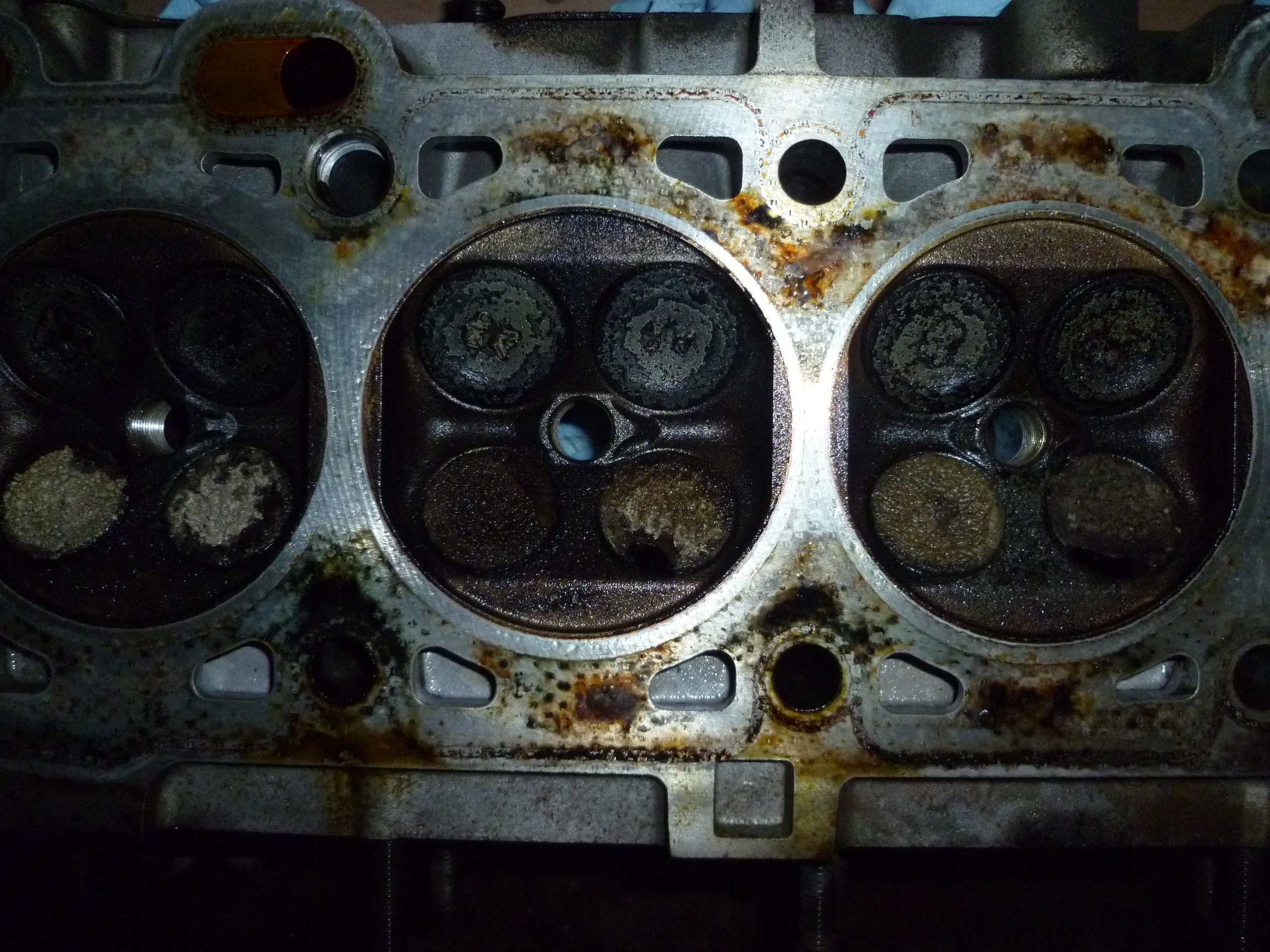

We were able to lift the head up, then forward to clear the exhaust manifold. At first, it felt like the head weighed 200 pounds, but I guess it was just stuck. Once it broke free it was a suprise at how much lighter it felt. Goining back in may be quite a bit more problematic, especially with the exhaust gasket set probably falling off.
The verdict: one burned exhaust valve in each problem cylinder.

The problem pistons look clean, but the other 3 have a lot of build-up. Would that be from unburned gasoline being in the cylinder, cleaning the piston?

I have always cleaned the piston tops when I have the head off. Seems right, unburnt fuel must have been washing those cylinders.

Despite the improbability, I think they must have burned within about 15 minutes of each other. Previous to the incident, there were no codes, stored or pending. Idle could have been a little smoother, but that could have been anything, not the least of which is fouled plugs.
