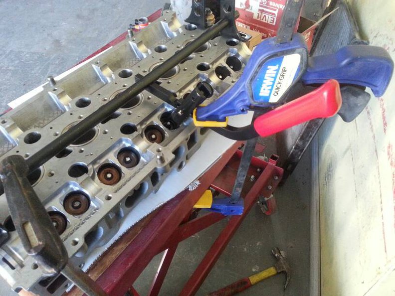

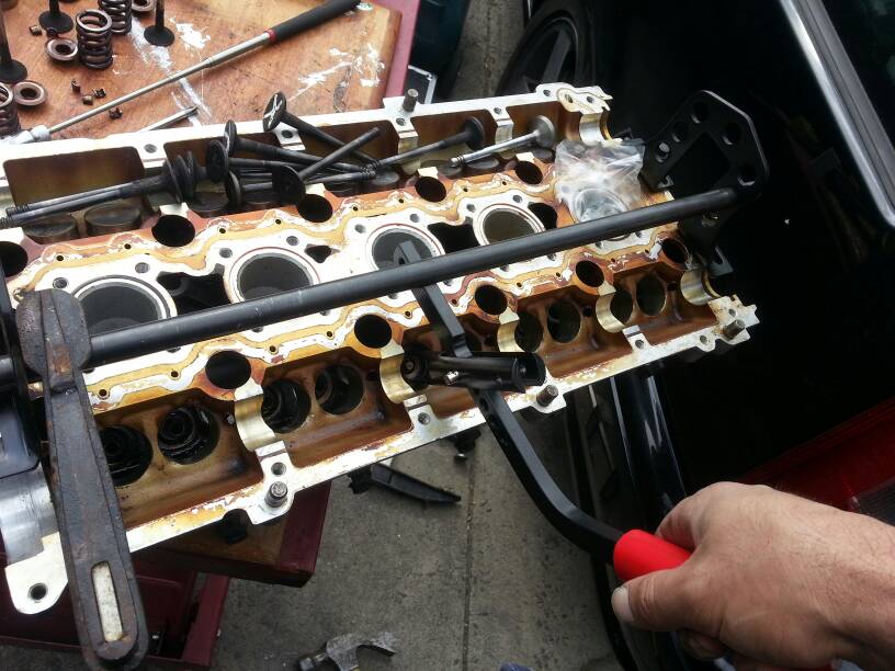

This one did the job on my 98 V70R: Well made and practical: https://www.amazon.com/gp/product/B00355 ... ge_o03_s00
- y8ysytyn.jpg (73.65 KiB) Viewed 1028 times
- 4eraqada.jpg (81.42 KiB) Viewed 1028 times

Precopster ,thanks for the pics. Your cleanup in the second pic is awesome. Also, the use of the Grip Clamp is noted. What was your reason for your rebuild ?

Actually the first pic is the donor head being robbed of valves and the second is of the head I found in the rear of the V70R last year that had some smashed valves. The head was servicable after about 10 valves were smashed by a seized idler pulley.clifford06 wrote: Precopster ,thanks for the pics. Your cleanup in the second pic is awesome. Also, the use of the Grip Clamp is noted. What was your reason for your rebuild

BTW, the valve spring compressor I got on loan at Advance Auto was cumbersome to use. I would recommend using the type pictured by Mike (precopster).
