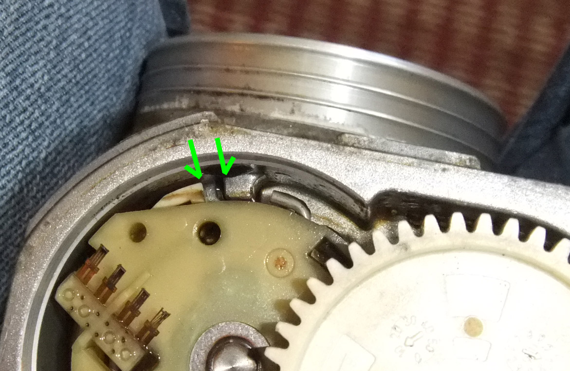

Yes.abscate wrote:Nice troubleshooting and it sounds like you've nailed it. Can you get some pics of the offender?
For those still paying attention to this thread,
See picture attached.
I can now explain what is happening, with conditions for resulting DTCs "LTFT Rich" and "Low MAF", Drivability symptoms, and likely reason(s) why the ECM didn't spit the ETA specific DTC until after ECM adaptive values were reset.
As the internal gears wear they no longer mesh cleanly but instead develop a tendency to bind, sticking the throttle plate mechanism at certain positions (roughly 10 degree increments as it corresponds to physical spacing of the gear teeth).
They bind under air loading (engine running). Not necessarily during KPII/engine off (sweep test looks good).
Attached pic (green arrows) shows that the throttle plate doesn't always return to it's idle/closed position (sometimes it does, sometimes it doesn't!) In addition there's increased resistance and a tendency to stick at those same positions while opening. However, it will near consistently close to the stop if you hold it open then allow it to "snap" back by the return spring, such as kicking/releasing the accel pedal quick (symptoms may easily be misinterpreted as a leaking/stuck injector when it happens at startup, ah hem, I went down this path)
DTC: "LTFT Rich" Occurs at idle or part throttle cruising. In these conditions you're either sitting at idle stop or (while cruising) flirting in the neighborhood at times. But the plate wants to stick open at approximate positions 15% and 25%. Too much air, lean: DTC LTFT rich.
DTC: "LOW MAF" Usually occurs on cold starts, sometimes while cruising and under light acceleration. Resistance to opening of the throttle plate-> not enough air. Poor econ. However under hard acceleration the stepper motor overcomes the physical resistance, past the first few teeth that are worn, and delivers appropriate higher end torque with proper A/F.
I suspect the ECM is performing some pretty crazy workarounds with fuel metering and ignition advance to deliver the requested torque. Result: poor highway econ, atrocious part throttle econ. Hypermiling doesn't work: I discovered I actually got better stop-n-go mileage by accelerating hard, then snapping back on the pedal when reaching the desired vehicle speed. Yes yes! I now know why.
What I am not sure about: The gear attached to the throttle plate is actually two pieces incorporating the return spring. I can't tell if about 5 degrees of play between them is by design or due to physical wear as the play is spring loaded. If it's a wear issue then I can say a brand new ETA has the idle position set with the plate about 3 degrees from fully closed, and the wear over time adds around 3-5 more (droney idle/vibration absent of issues above?). I was seeing some unusual/crazy fast cyclical readings off sensors, specifically the MAF at certain RPMs (Play= throttle plate "fluttering in the wind"?). I will be able to assess this better when I receive the new ETA in a few days as I can examine for this play before installing on the car. It may be by design, and for reasons I'm not aware.
Why ETA specific code not set until after adaptation was reset? Analog POTS. Pots of this nature may have a tolerance +/- 15% or more and are affected by temperature drift. ECU has to account for this normal variance...so...over time it learns/interprets a consistent part open reading as closed, and uses these values. The ECU *should* catch when changes that are commanded don't physically occur raising the possibility that somebody hath designed the ECU program to hide problems that might result in warranty/recall work. My opinion is it's probably a little bit of both.
Contactless sensors also have angular variance, so an updated sensor design doesn't necessarily solve the problem of (with absolute certainty) knowing the true throttle plate position short of a contact switch (at idle stop, at least).
Note the VW/Audi TDI emissions fiasco vehicles also run on Bosch management. I would imagine Bosch being very protective of their ECU software code. VOLVO and VW/Audi may not even be privy to much of its inner workings. I'm not sure it's appropriate for regulators to pin TDI emissions fault solely on VW, just as I'm not sure I'm willing to pin this solely on Volvo, because so much of the rest of the car is so very very solid.
