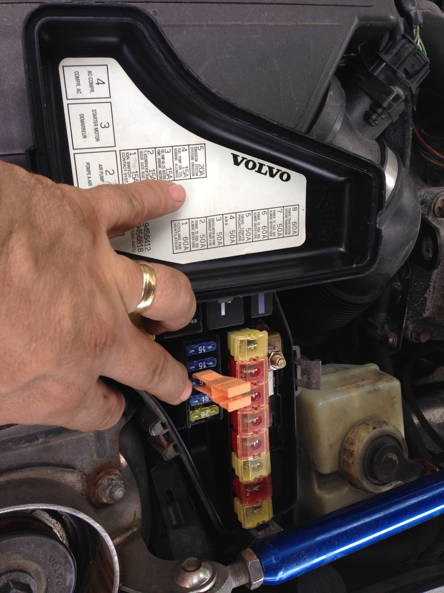

It's the first of four hidden under my ring finger, ouch, gotta get that ring resized...
Somebody at Volvo was sleeping when they labelled that fuse box, but Hades, my car has a 1998 vacuum diagram pm on the hood, so I should be thankful they at least got the parts right

I checked all the relays- all are clean and shiny. I pulled the 15 amp fuse for the fuel pump/coils. I did a voltage check while cranking and it registered a little over volt which I found a bit pecuilar, but on the '99 S70 the same test yeilded over 2 volts. Really not sure what that means, if any thing. The ignition switches from the two '99 are different, so not able to do a swap there. A quick once over on the switch- seems to be functioning normally.
