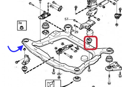

Manov...you cant hit that mount in The ground, it's above the subframe.

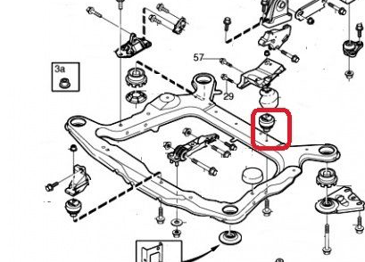

Hy
Here is where I think I have touched (blue arrow).
Manov
Manov
