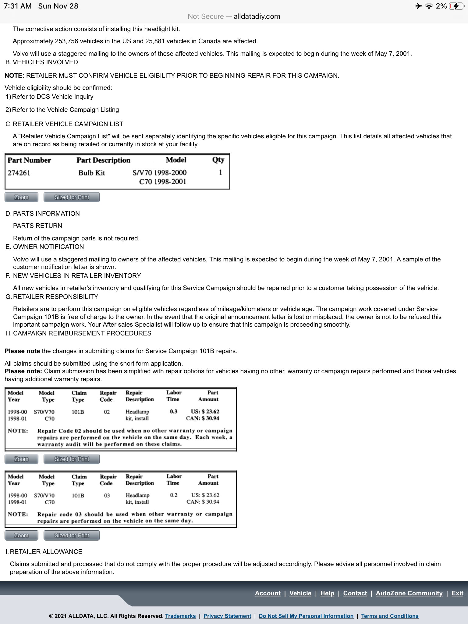

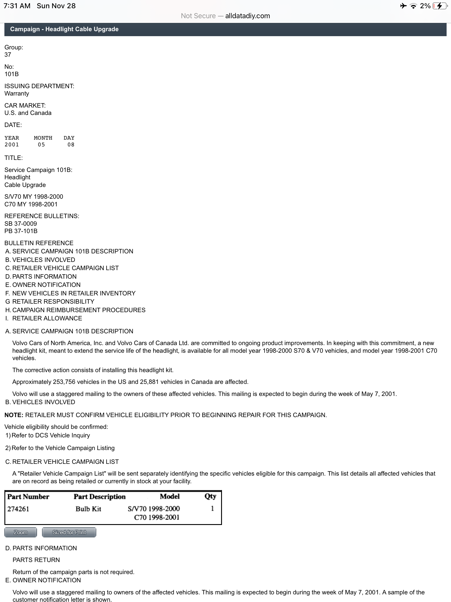

Should have added, this was probably addressed with the TSB 101B adding the headlight pigtail to P80s dated 2001abscate wrote: 09 Nov 2021, 04:06 PSA by the way. Open up those headlight twist covers and inspect your headlight wires periodically

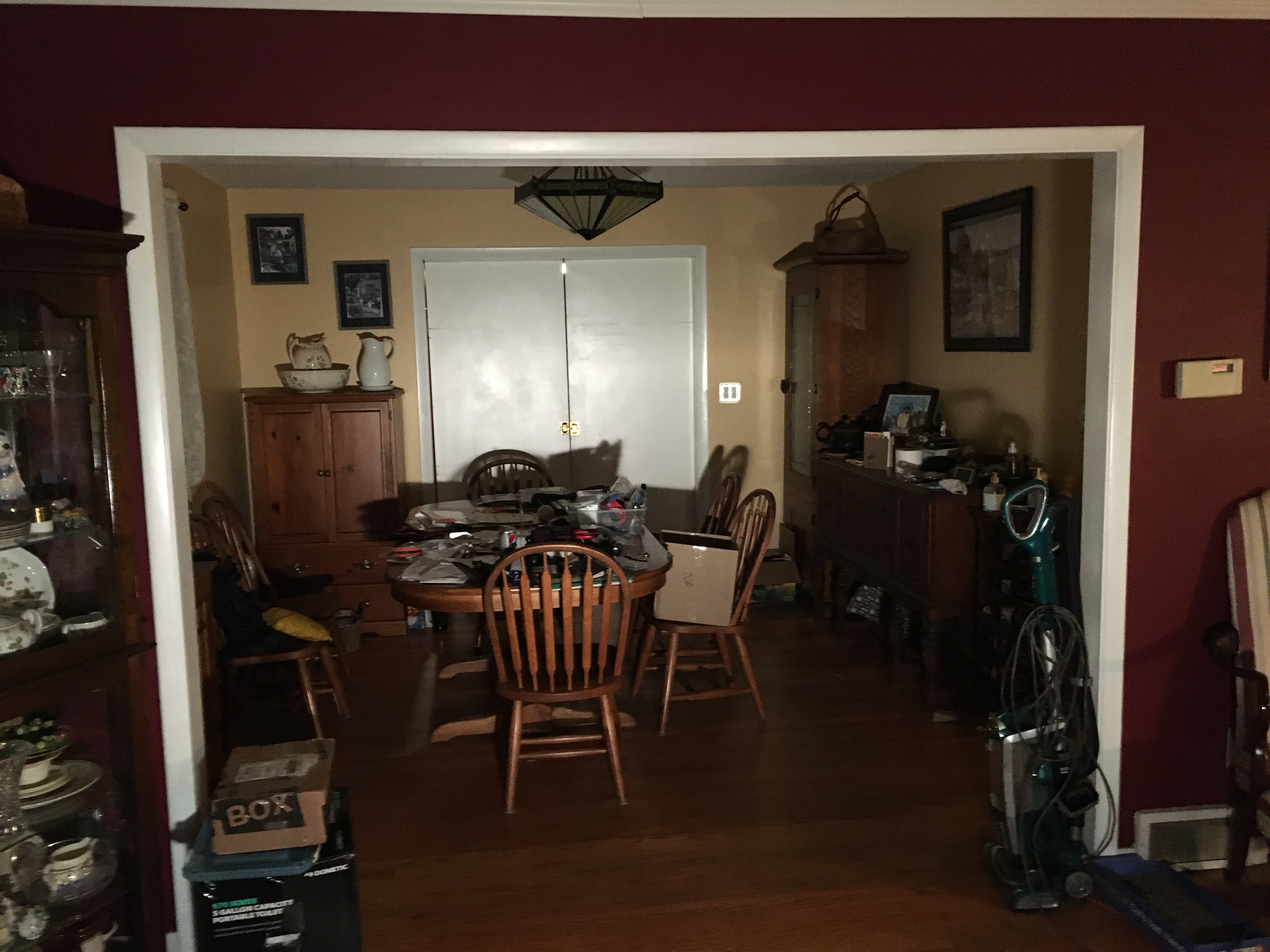

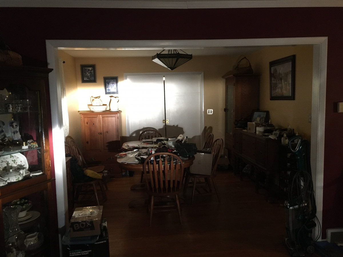

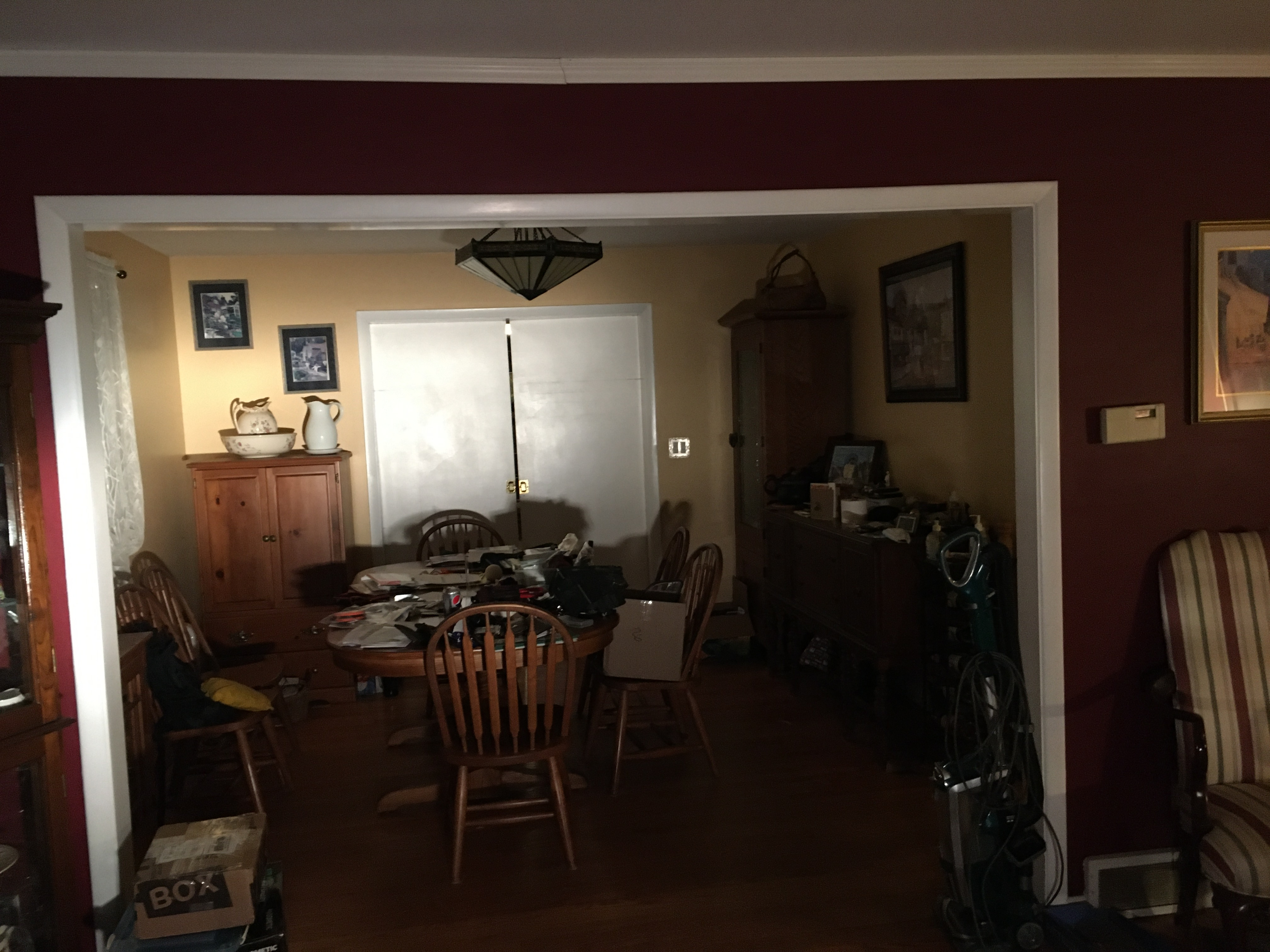

Very early look at the data comparing a dull reflector , a 3m taped reflector , and a new TYC LAMP. all measurements with same battery and bulb. Exposure on integrated aperture priority , shutter speeds indicate approximate light out out was
25% dull
75% taped
100% reference TYC
Conclusion. You can improve your light output by a factor of 2-3x by taping a dull reflector

These are coarse measurements. What is apparent is the taped reflector is redirecting the light into a spot much better than the dulled ones

Which photo is which headlight? The top photo is nice and focused while the other two are diffuse, perhaps detrimentally so.
