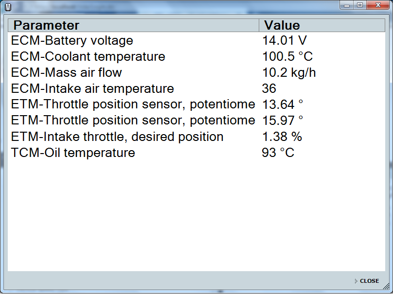

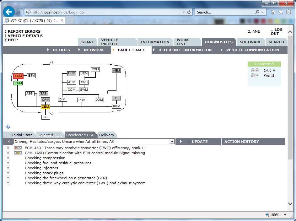

Meanwhile... after a 30 miles test drive, it looks we're done here:
Posts: 35267
Has thanked: 1497 times
Been thanked: 3809 times
Sweet. Don’t sweat the cat efficiency until you’ve run it a bit
