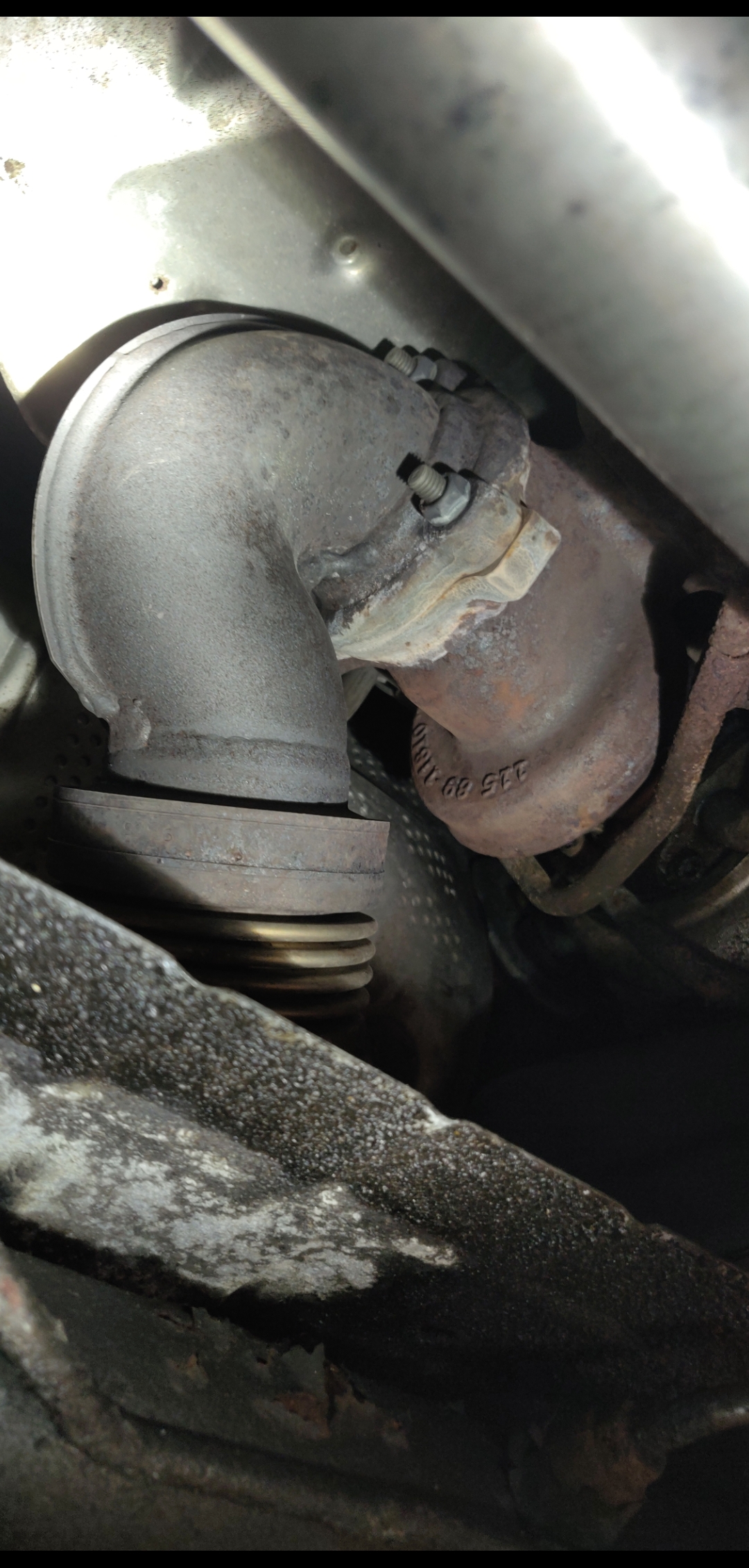

Here is a good shot of my downpipe flange. Looks normal?

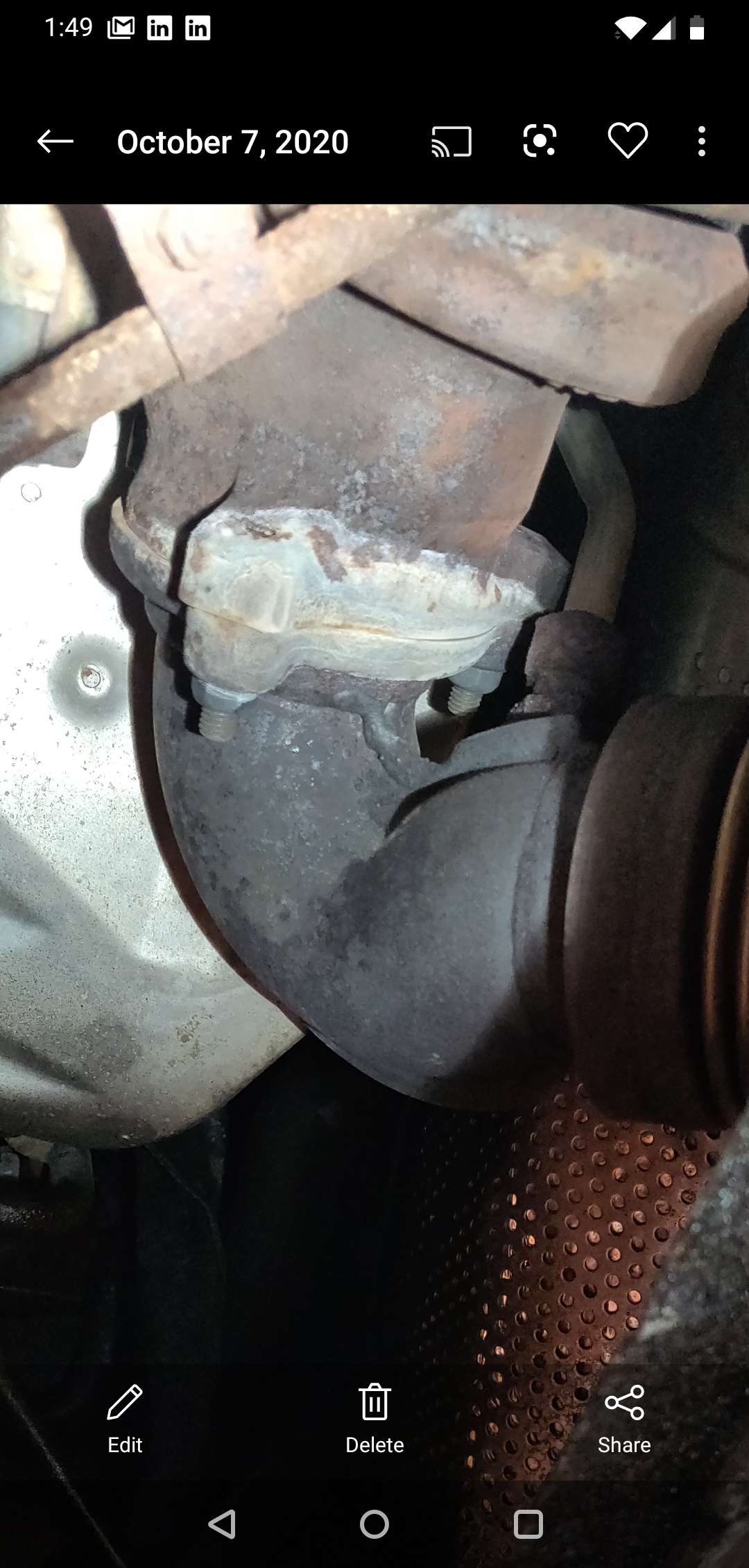

Another angle.....does it look like the gasket is missing, or is it just me? Looks like now gasket and some smootchhh stuff slapped on there, no?
Turbo exhaust block to downpipe, with the STRAIGHT FLANGE, 1998 volvo V70 turbo, automatic, NOT awd, and Low Pressure Turbo.

- Posts: 36145
What are the hexagonal shaped things around the threads on the manifold?
I’ve never seen those before.

abscate wrote: 11 Oct 2020, 12:02 What are the hexagonal shaped things around the threads on the manifold?
Hahaha yeah....they look kinda like they are made the stuff from deeez
Deeeeeeez nutssss! Hahahhaa
Just kidding, I hate it when I fall into that joke. Lol.
Yeah, they look new. The gaskets I got came with new hardware as well, I have not gotten them installed yet.
So what are you saying, should I tighten those up? I havent got a wrench on them yet. And, maybe the gasket just needs to be changed...
