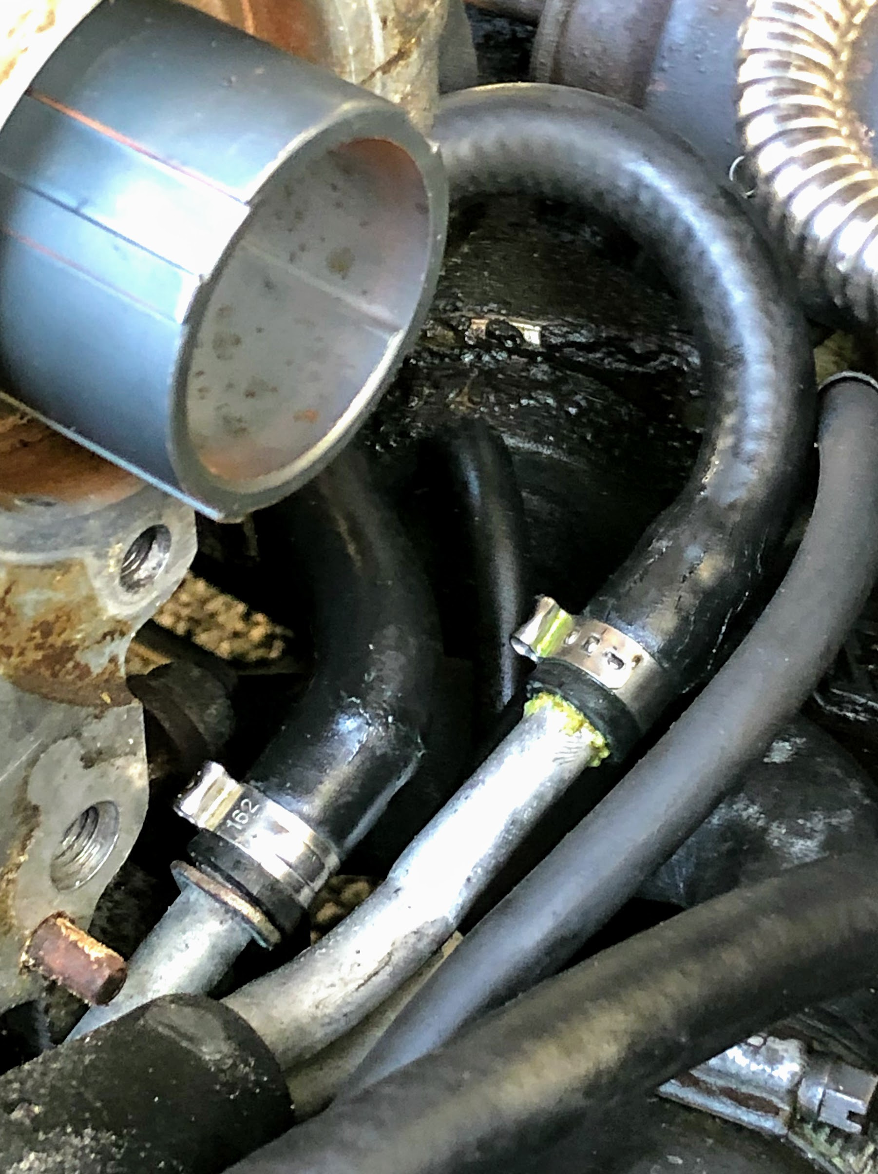

I picked up the hose today, and I can get it to bend into roughly the right shape without too much effort, but it definitely wants to snap back into a straight-ish line. I'm a bit concerned that the strain of keeping it in a bent position over time might be an issue for the integrity of the hose (which I'm assuming is why the OE piece is molded into that shape in the first place). Maybe it will soften up a bit once it's got hot coolant going through it?

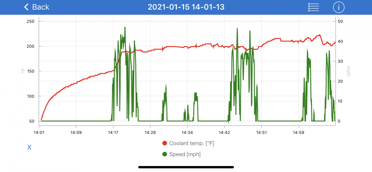

I got an IR temperature gun and took some readings last night after having driven the car around a while. I parked the car and idled it in my driveway with the heater and AC turned off, and also with them turned on so as to trigger the engine cooling fan. I took readings in various places and here's what I found:abscate wrote: 13 Jan 2021, 08:08 It actually runs at lower temperatures
The thermostat on a turbo car is nominally 87F and 90F on a NA car. Thats a nominal difference, though.
If you used fresh coolant when you did the radiator, I doubt you plugged it. You can use one of those cool IR temperature guns to check the temperature onthe radiator to make sure it is uniform, then get one of us to do the same to compare. I know you hate gathering data before making a decision.
- Reading taken off the top of the thermostat housing tracked the ECT within 1-2 degrees F (195F in this example).
- Readings taken off of other various metallic surfaces on the engine head and block were pretty close to the ECT as well.
- Reading taken off the upper coolant hose was about 20 degrees F cooler than the thermostat temp (175F) which I expected since the rubber is insulated.
- Reading taken off the lower coolant hose was about about 20 degrees cooler than the upper coolant hose (155F) WHEN the fan was running, but was about the same as the upper coolant hose when the fan was NOT running.
- The readings I took everywhere else were quite steady, but the readings I took off of the radiator were all over the place. I took the readings off of the radiator fins, shot between the fan blades while the fan was stopped. I'm not sure it's really a reliable measurement. It was bouncing anywhere from 115F to 165F and everywhere in between, whether or not the fan was running. I'm wondering if this is due to the multifaceted and reflective design of the radiator.
Conclusions and/or questions:
- Is there a better way to take a reading from the radiator?
- Since the hoses before and after the radiator were both showing a similar level of heat, my assumption is that the radiator is not blocked and coolant is flowing through it.
- How much, if any, is the radiator expected to cool the coolant if the engine fan is not running and the car is stationary? I get that the point of the radiator design with the multitude of metallic fins is to have as much surface area exposed to the air as possible so as to dissipate heat, but it seems like without the cooling fan, or without the force of air as the car is driving, at best it's keeping the temperature at equilibrium. With the engine constantly running and reheating the fluid, and no force actively drawing heat away from the radiator, it doesn't seem like there's that much opportunity for it to cool down.

In Northeast winters it is not uncommon for me to idle with the hot engine and never hear the fan come on. The radiator has enough passive convection and radiation to cool below the threshold for fan turning (about 97C?) in my experience. I’m 99%confident on this.

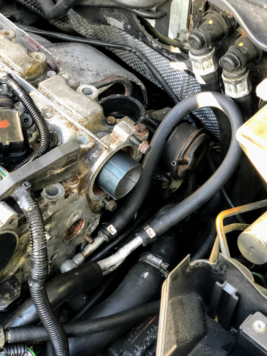

So far so good! I was able to disassemble things to the point where I could get to the leaking hose. Here's a photo of everything at maximum disassembly:
Removed strut tower crossmember, charge air pipe, top engine mount, side engine mount carrier plate, fresh air pipe, moved fuse box and battery cables out of the way, also removed camshaft position sensor outer housing which I wasn't expecting but was easy enough and made access and visibility much better.

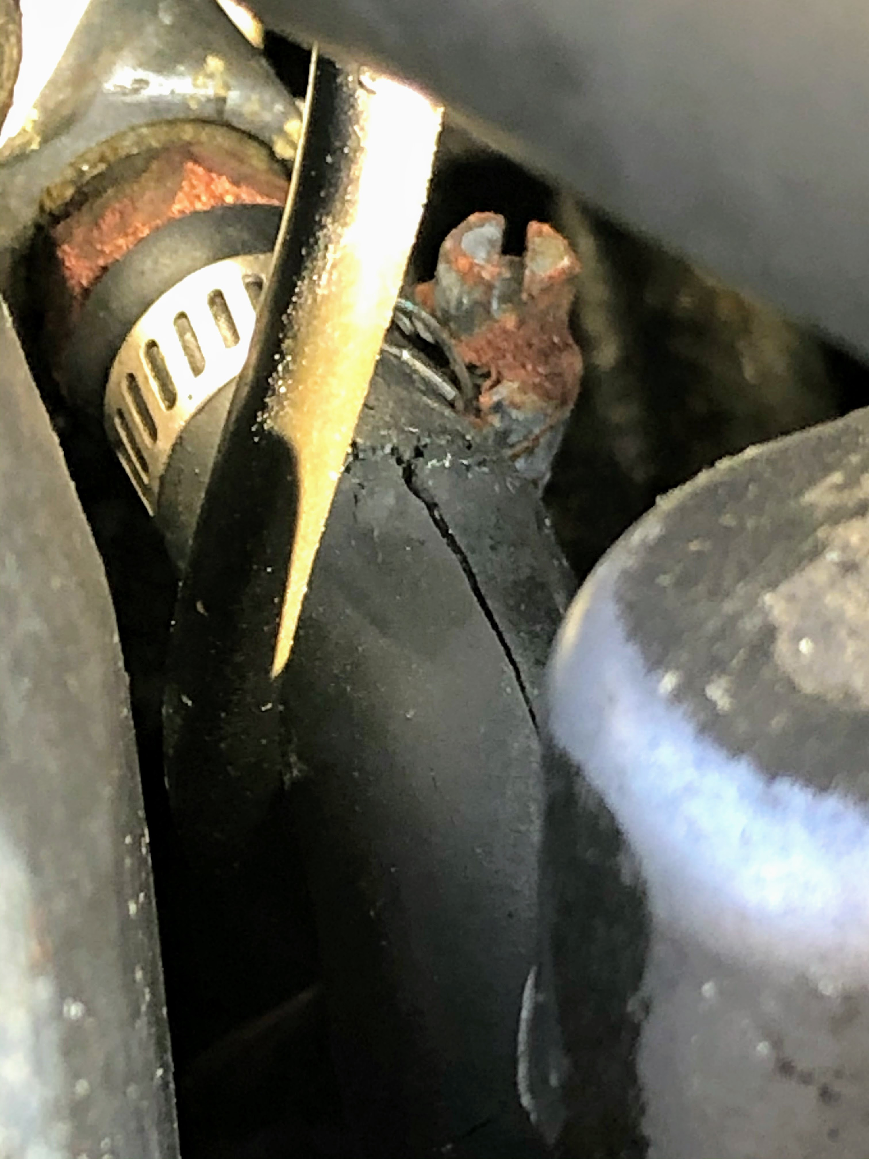

Here's what the bad hose looked like:
Both ends were badly cracked. The end going into the block was practically ready to separate on its own. The rubber had gotten incredibly rigid. This feels like really bad quality to be in this condition after just over two years. I definitely would not recommend the IPD aftermarket PCV hose assembly. I checked the other end of the hose, the one coming from the thermostat assembly into the banjo bolt on the intake manifold. Here's how it looked:
Pretty bad, huh? Again, this is just past two years since it was installed. There doesn't seem to be much, if any, leakage coming from this hose YET, but I'm not holding my breath. I definitely wouldn't recommend IPD's aftermarket PCV hose assembly, based on the low quality I've seen in multiple instances.
Here's how the new hose looks installed. It's much longer than the original, but I was able to route it so it wasn't in the way of anything and I didn't have to bend it too far. The hose is a Gates "safety stripe" heater hose and seems like very good quality, so I'm hoping it will last for a while.

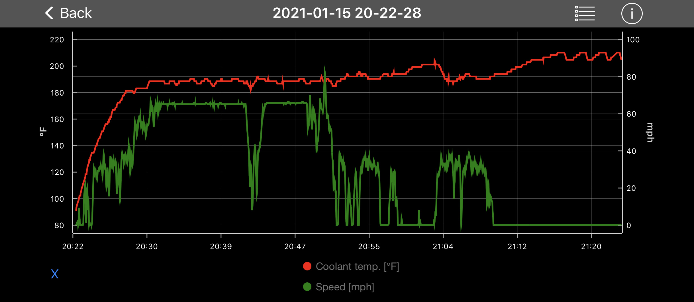

Did a highway drive last night, followed by city driving, followed by idling. No coolant loss, although by the end you can see that the last bit of idling caused the ECT temperature to rise into the 200F+ area and settle into a a roughly 205-210F heating-cooling cycle. I'm wondering if this temperature at idle is cause for concern.
But again, no coolant loss, which was the initial issue I was trying to solve.
