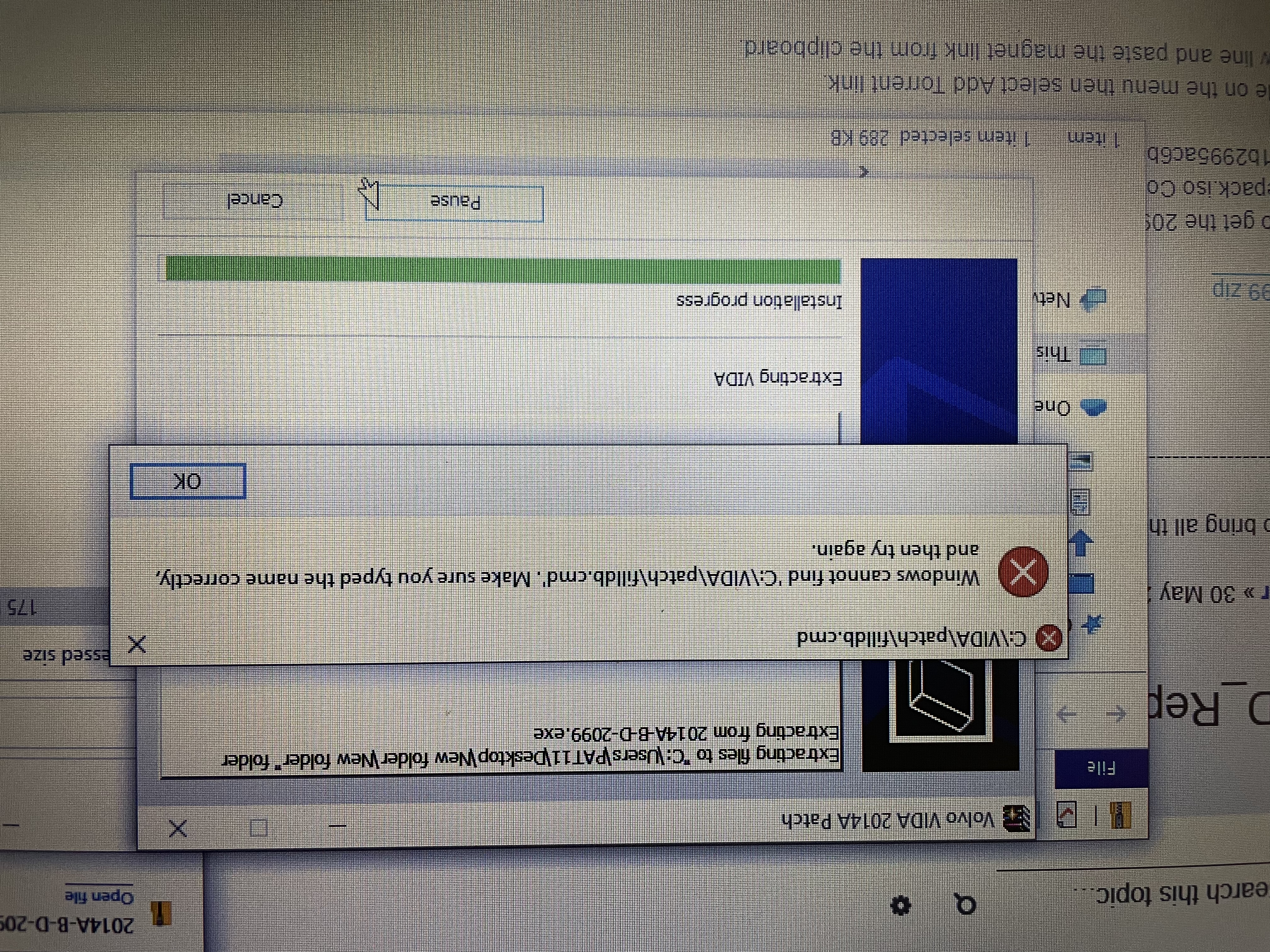

The complete message is windows can’t find %VIDA_HOME%patch\filldb.cmd
Make sure you type name correctly and try again
So I keep pressing continue I see for lines of extraction and I get the same prompt again I keep pressing continue till the page goes back to the download page where I have the patch.
I’m not sure if that’s clear enough.

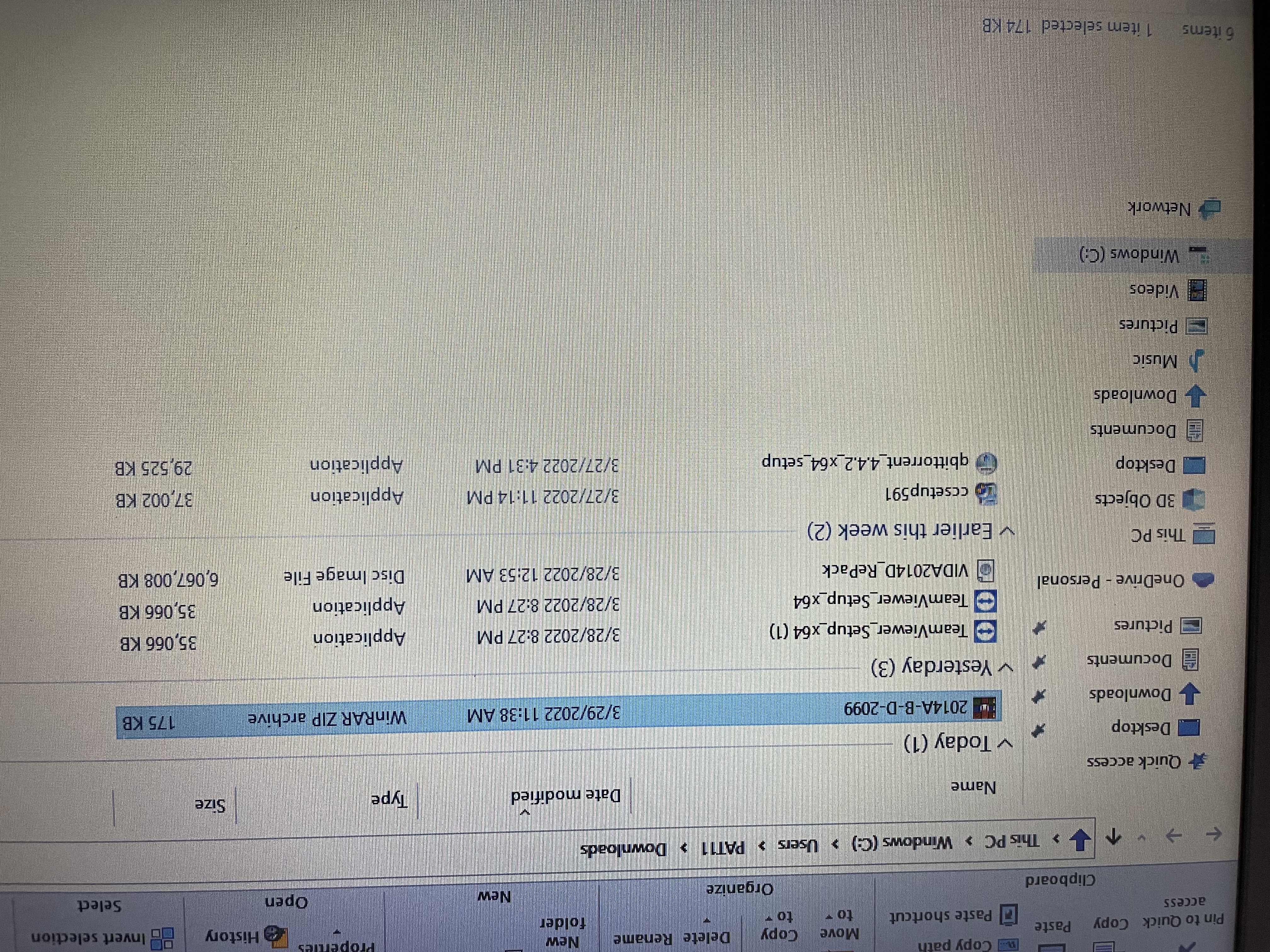

I followed those instructions too and still gets stuck when is getting the files.
Following your post Rick says that is not necessary just delete and download again but I get no progress.
I even downloaded winRAR to open the patch to see if that would help but I got same results.
Thanks to you and Rick for the help.
Thanks for the link.

Hey guys,
It’s me again, sorry to keep bugging you with this but I erased everything and did a new install of 2014 repack, the problem I have now is when I run script 3 (patch) I get the the prompt windows can’t find C\Vida\ patch\fill.cmd
So instead of making progress with a fresh install it got me stuck earlier in the process this time.
Guidance will be greatly appreciated.
Thank you.
Thank you.

Robopat wrote: 29 Mar 2022, 17:23 now is when I run script 3 (patch) I get the the prompt windows can’t find C\Vida\ patch\fill.cmd
Use the windows zip decompress to unpack the 2099 zip file. I suspect WinRAR is not unpacking the zip correctly.
I downloaded the 2099 patch again. It unpacks correctly with the windows zip decompress and the patch runs correctly. I even ran the patch without unpacking the zip using the built in windows zip features.
The only thing you would need WinRAR for would be to edit the patch. Which there is no need for.

Hey Guys,
It’s me again, as I explained earlier I erased everything and downloaded the 2014 iso and 2099 patch.
The problem now is I was able to download and install script 1&2 but when I try script 03_patch I get the command
I’m at a lost here.
I tried to extract with windows zip as you suggested but the script doesn’t have that option.
I have windows home will that be the reason I’m having all this issues?
Thank you
I’m at a lost here.
Thank you

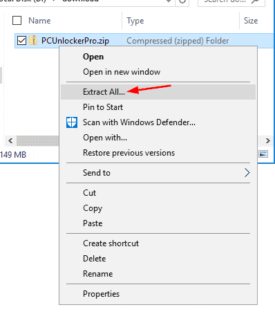

Are you right clicking it and extracting?
Like this?
Like this?
