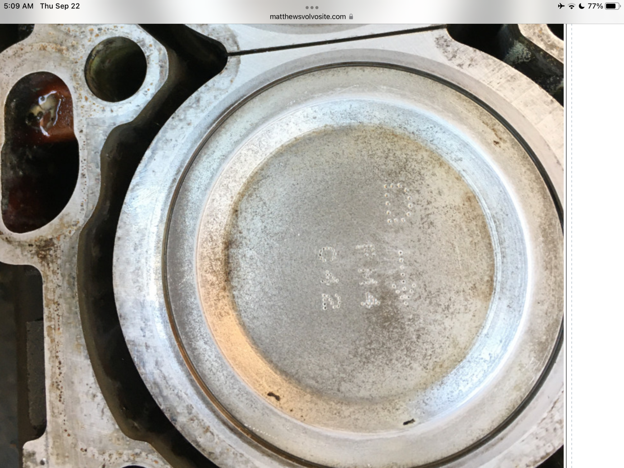

I imagine that you can't inverse a piston and you can't "mix"them when disassembling. What do these inscriptions on the top of the piston ?

It’s like any area of expertise with many details. If you tear into an engine you will find many paths and problems which will be different in on every engine, there isn’t a standard set procedure to rebuild and engine. Just learning how to use a micrometer to get reproducible measurements down to 0.025mm or less is an expert skill.
As DIY we can rebuild an engine but we need to go slow, about 5x slower than an expert, and stop, ask questions along the way, post pictures, and then figure out the good answers
It’s always much faster to source a good used engine and swap it in.
For you, Mon ami, see if you can find a blown bad engine for free, get it into your shop, and do a tear down.
I don’t know the Volvo codes on pistons but there are usually marks for…
Piston weight for balancing
Piston bore size for oversize block
Arrow to guide piston direction ( piston is slightly offset from pin so it is already to be pushed down by power stroke
Date code tracking ?

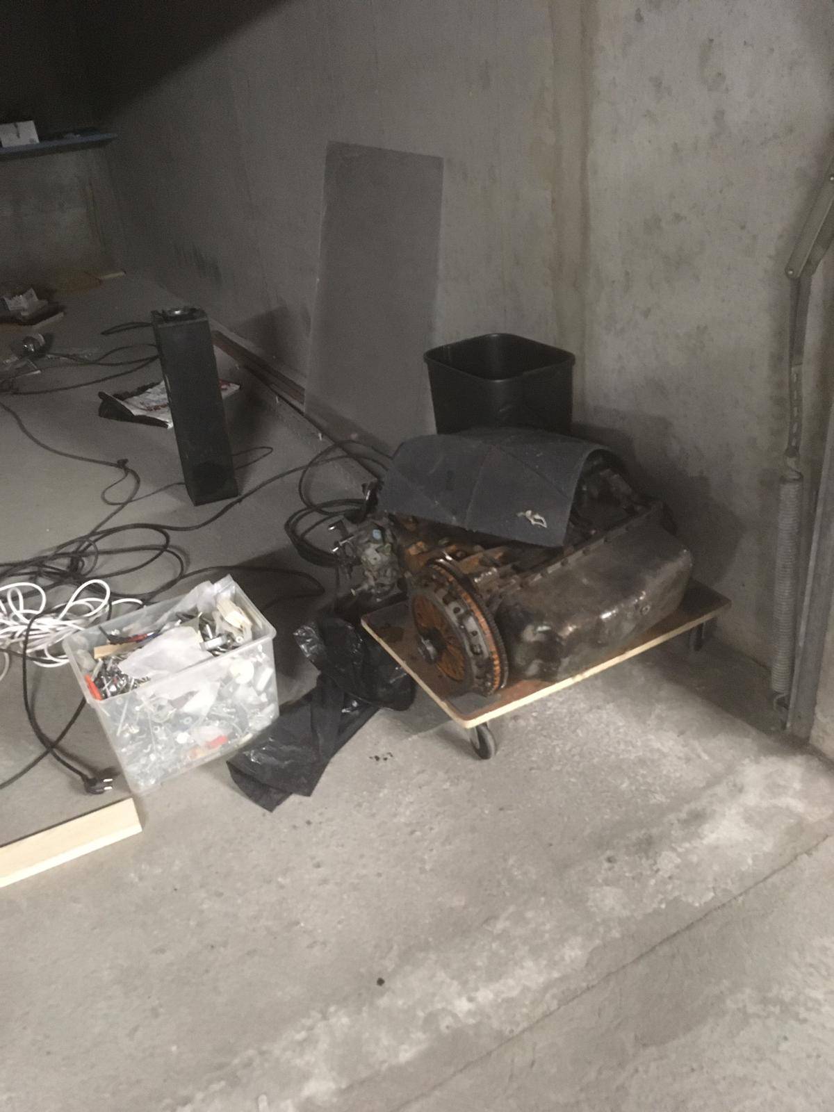

I've just picked up a abandoned engine in front of the building i work in. It's in my workshop. Your idea to find one is exactly what i'm gonna do : i will post pictures (in the right forum on MVS) and ask many questions.
Merci beaucoup abscate to share you knowledge. It's a gold mine for a guy like me.

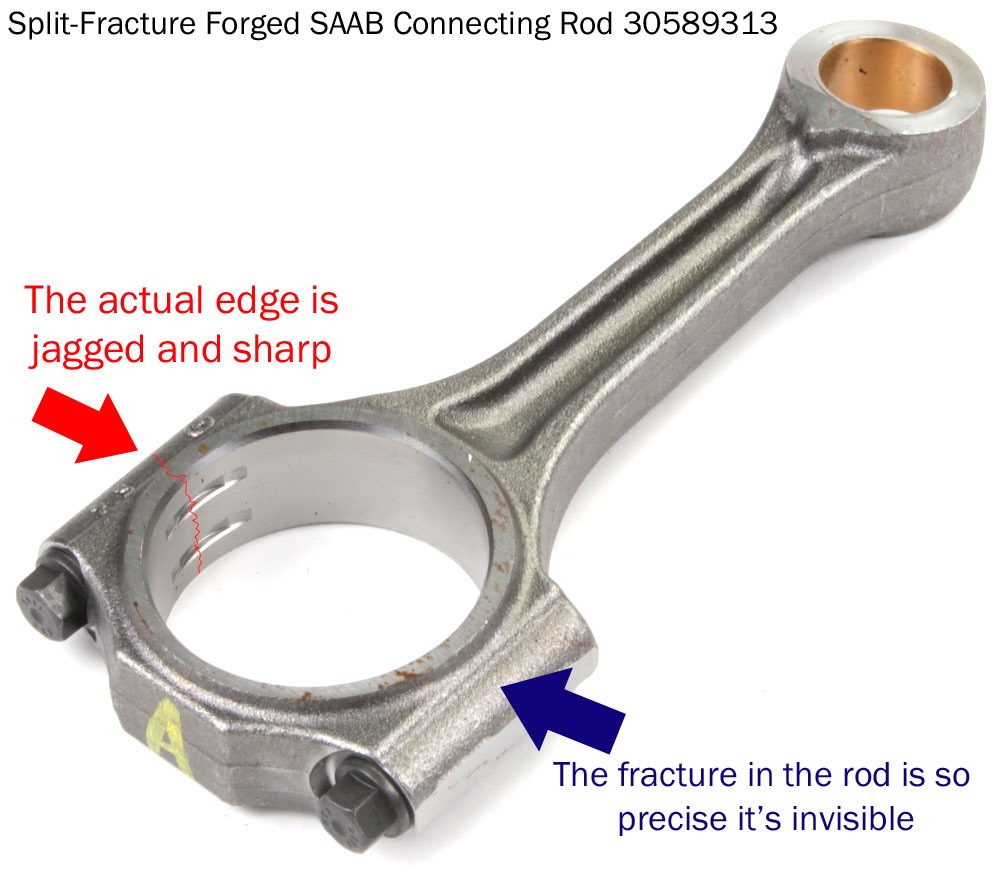

Here is a wierd Volvo thing
The connecting rods are 'cracked' - this is hard to translate to French - maybe pour craquer?
Instead of machining two halves of the bottom of the rod they are frozen cold and then 'shattered' into two pieces that precisely fit but have a jagged edge. If you mix up the rods you are really in for a big expense of all new connecting rods.

abscate wrote: 22 Sep 2022, 06:57 Here is a wierd Volvo thing
I didn't know this! Are they put in a press to snap them right where they want it in the center of the rod bolts? Is there a weak point cast into them so they break there? Fascinating!

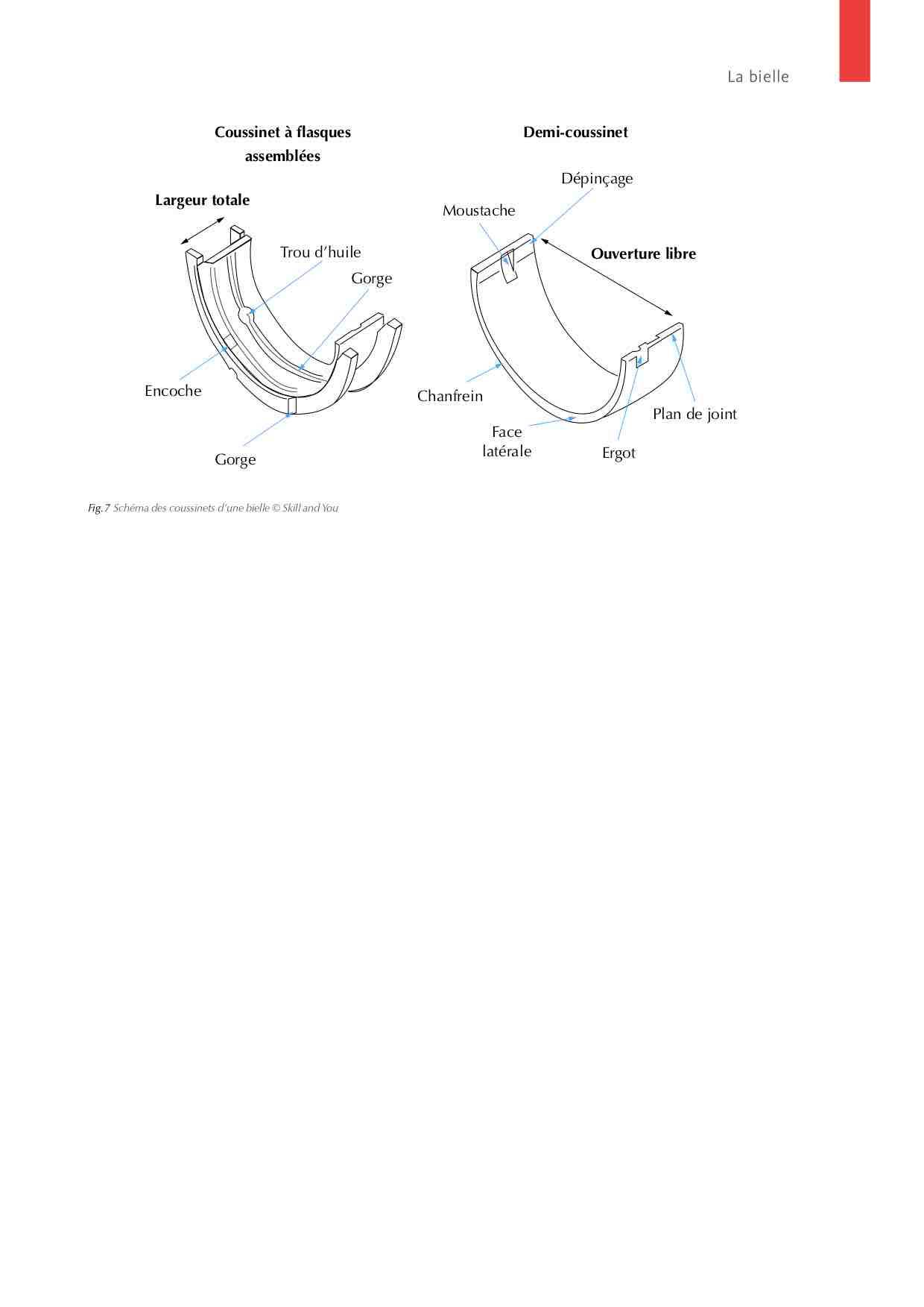

I've seen that in a (french ) lesson...
