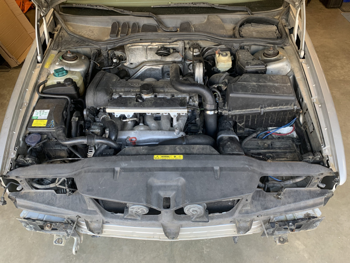

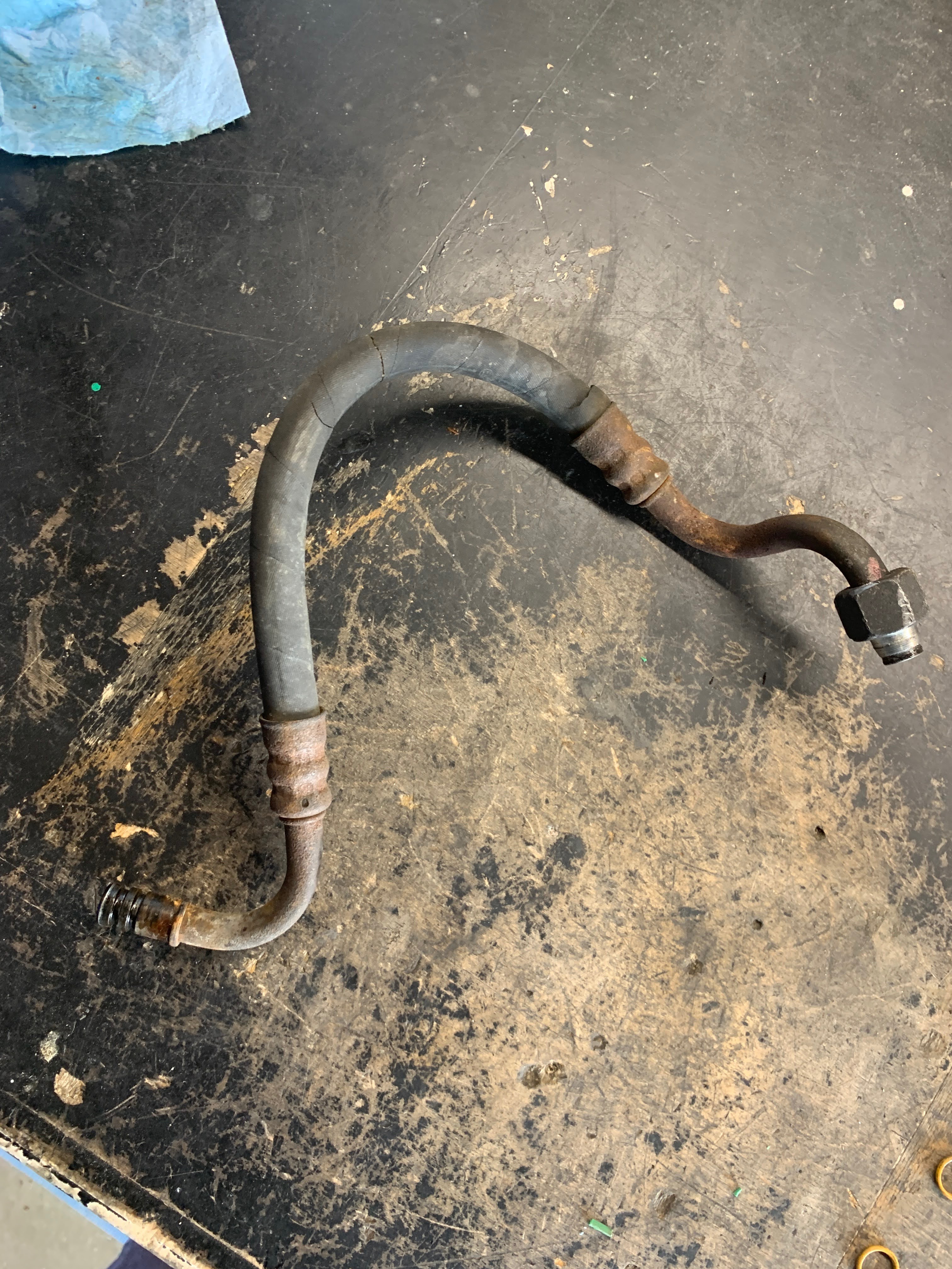

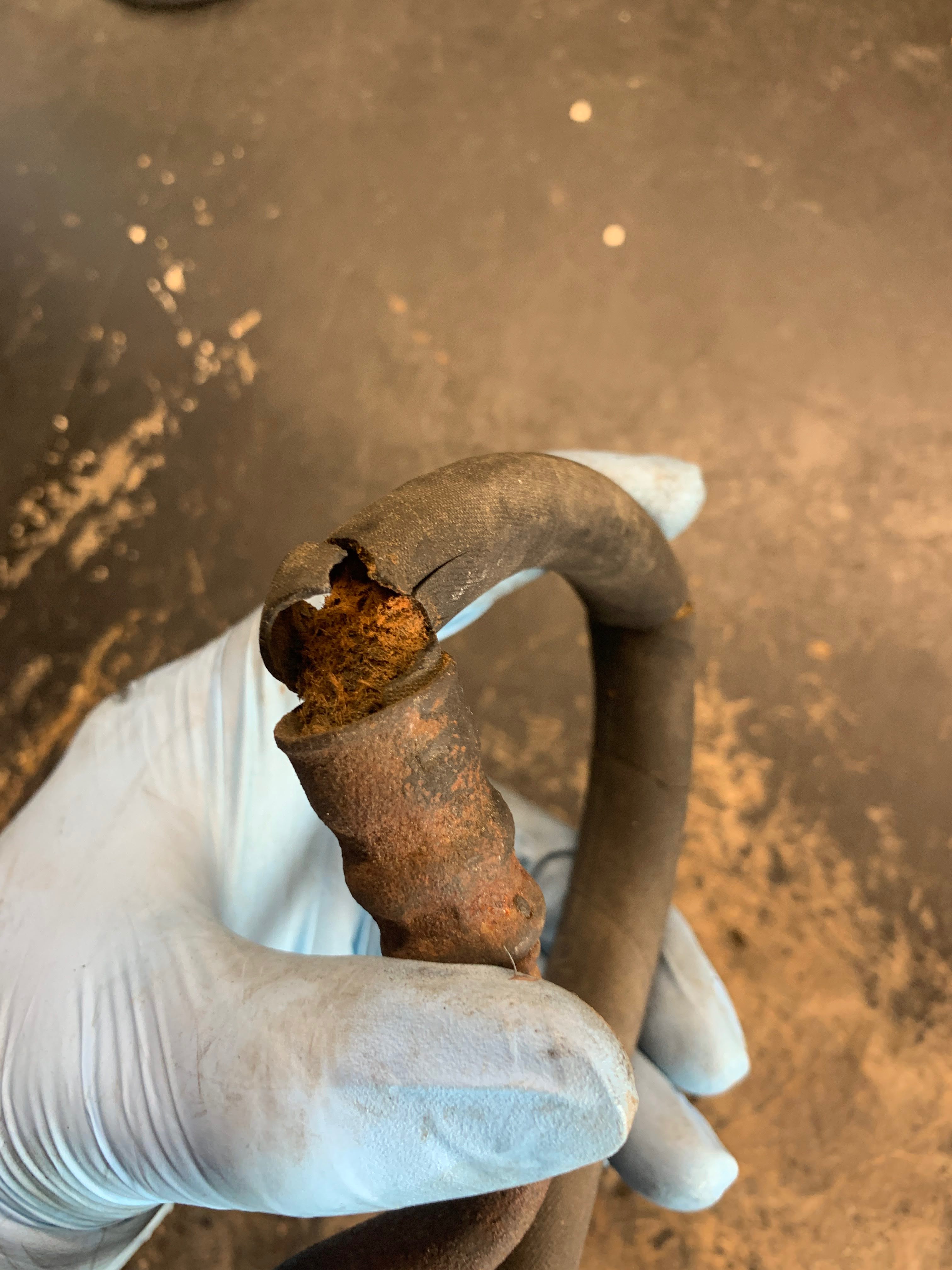

Replaced a transmission cooler line on the S70 before installing the replacement core support. It was BAD. Deep O2 sensor socket worked wonders to get the pipe fitting off on the transmission side. Had to soak it in PB blaster overnight after my adjustable wrench couldn’t crack it loose. Funny, I’ve grabbed two of these from the junkyard recently and neither took this much effort to break loose.
The car is looking much more complete now too. I just need to get a good pair of headlights and I can move onto the mechanical stuff, which fortunately isn’t very much.
I also swapped out the leaky, swollen power steering reservoir for the updated 2005+ P2 style reservoir. SOOO much nicer!

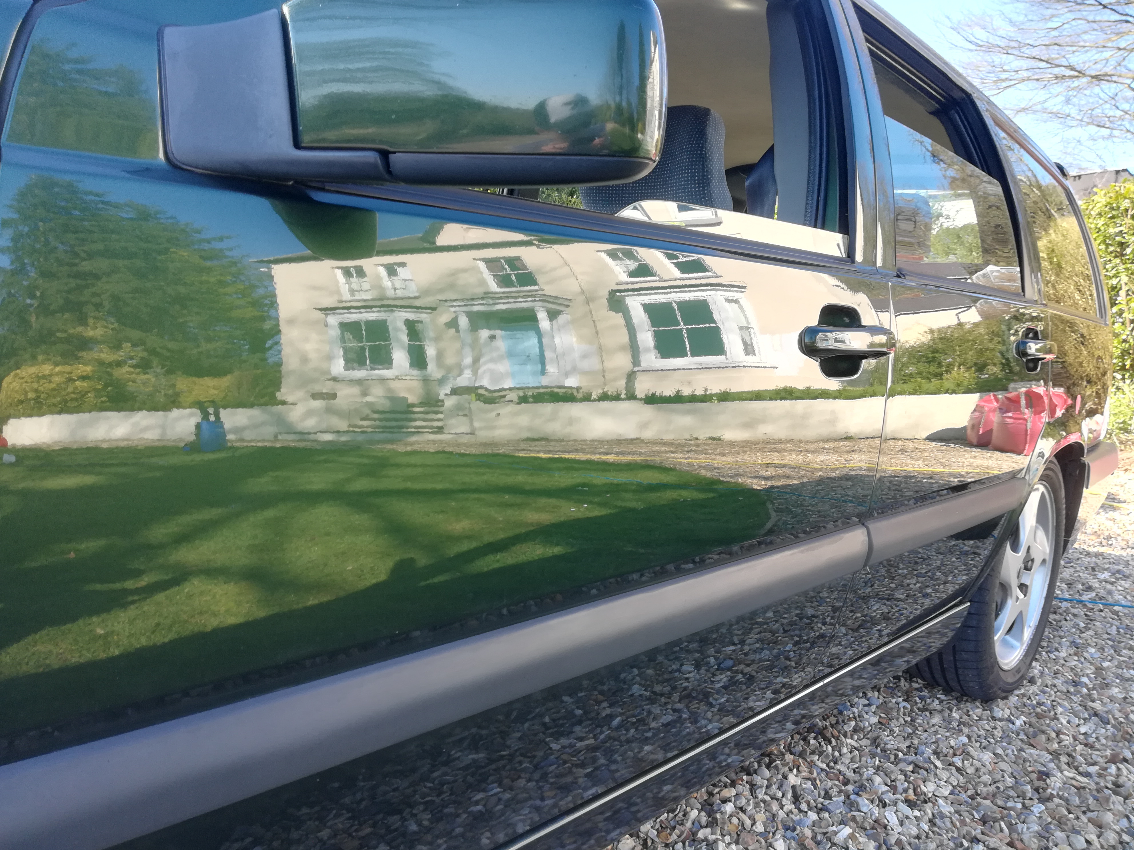

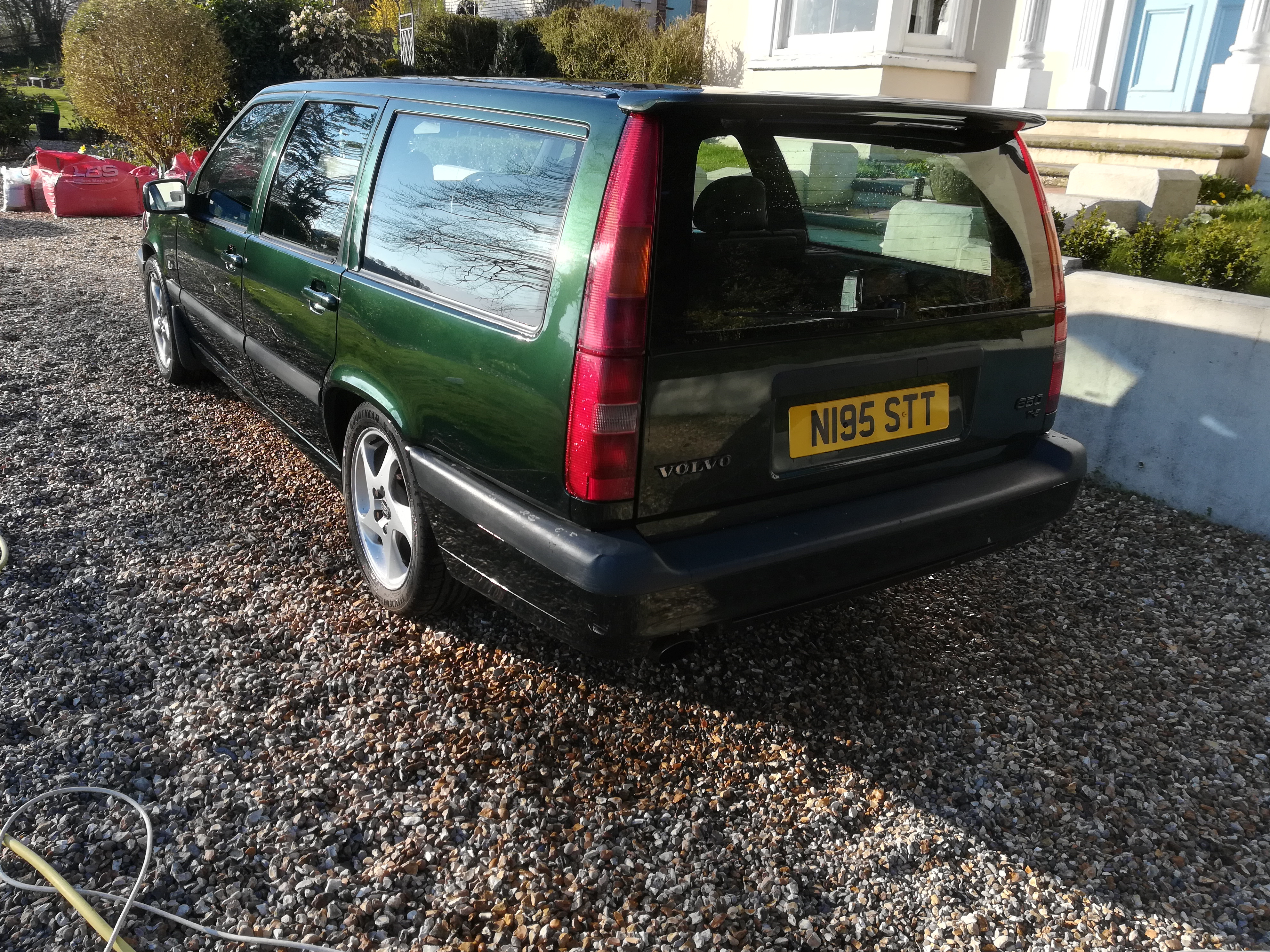

Someone at work very kindly scraped a bag down the entire length of the car, which motivated me to give the car a quick polish. Just a single stage affair with Megs 205 and a white HexLogic pad. 3 passes for the most part, 4-5 on the scratch. Came out pretty well, scratch is mostly gone but needs wet sanding in some places.

Nice for a 96!
We tried paint correction for the first time on our 08 C30 early Jan. Afterwards I saw the video below and will be mindful not to over correct on our next car.
C30: Washed then clay barred, DA with orange pad and Mothers Aluminum Polish, DA with black pad and Griots, Alcohol wipe and Avalon King Ceramic Coated entire car except rims.

Beautiful 421 green. ,British Racing Green, or ,gwyrdd rsving Cymraeg, according to google translate.
