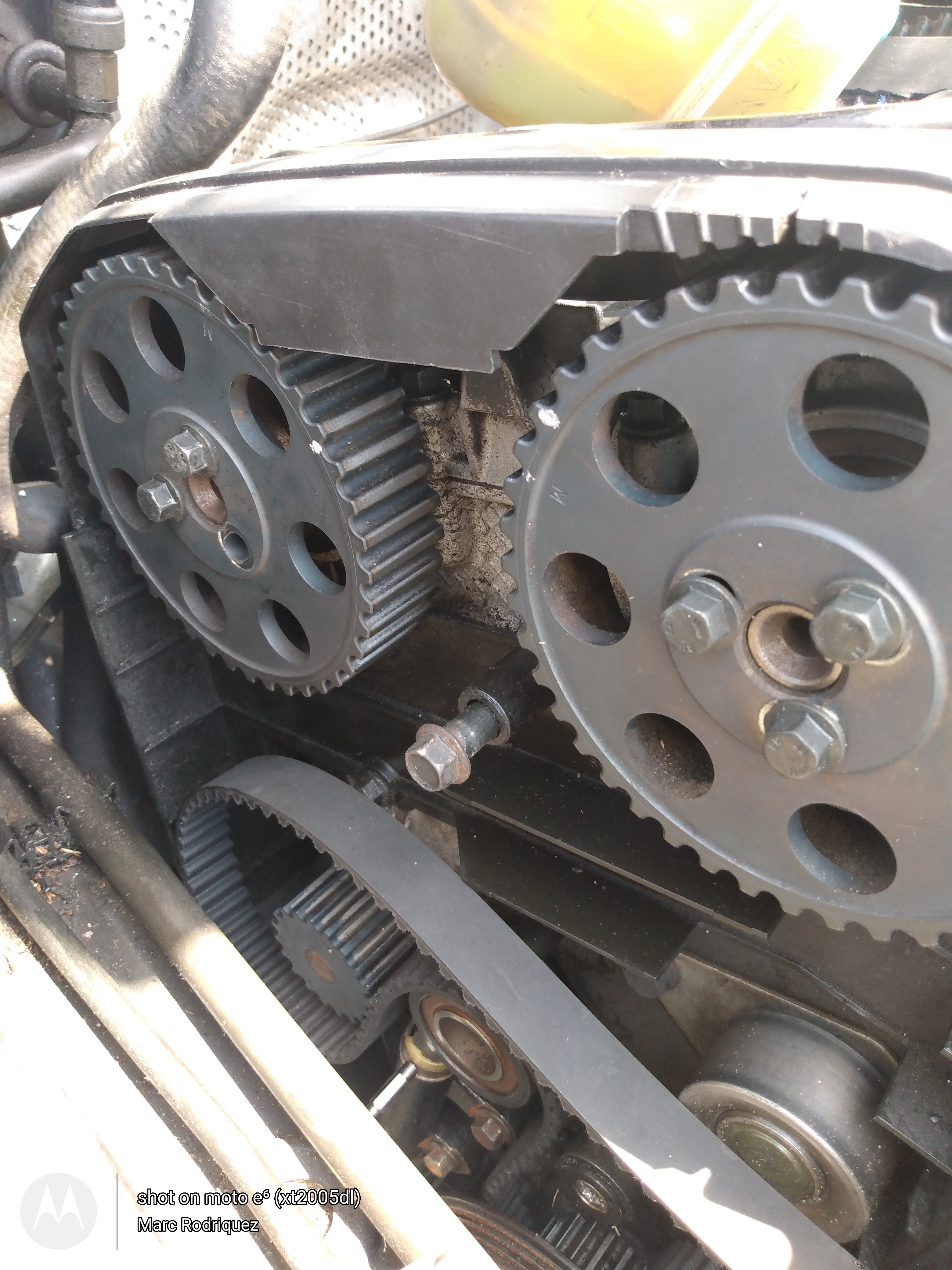

I'm f***ed. One of the exhaust cam bolts snapped as I was rotating the cam to line back up with the marks.
Is this a brick now?

mdr1220 wrote: 27 Jun 2021, 13:10 One of the exhaust cam bolts snapped as I was rotating the cam to line back up with the marks.
Take the pulley off and back out the broken bolt with Liquid Wrench and Left hand drill bits.
The idea is to get the Left hand drill bit to bite and turn the bolt not cut it. A Left hand drill bit turns and cuts counterclockwise. You turn a bolt counterclockwise to remove it. Once the bit has enough bite in the bolt it should turn the bolt rather then cut it.
The Liquid Wrench is to lubricate the threads, reduce the friction and keep from burning the drill tip. Go slow on the drill.

Will PB blaster be a good substitute? This is what I have at home.

mdr1220 wrote: 27 Jun 2021, 15:07 Will PB blaster be a good substitute? This is what I have at home.
Are you sure it's actually even seized in there? What were you doing when it snapped?
