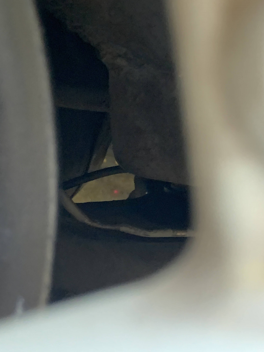

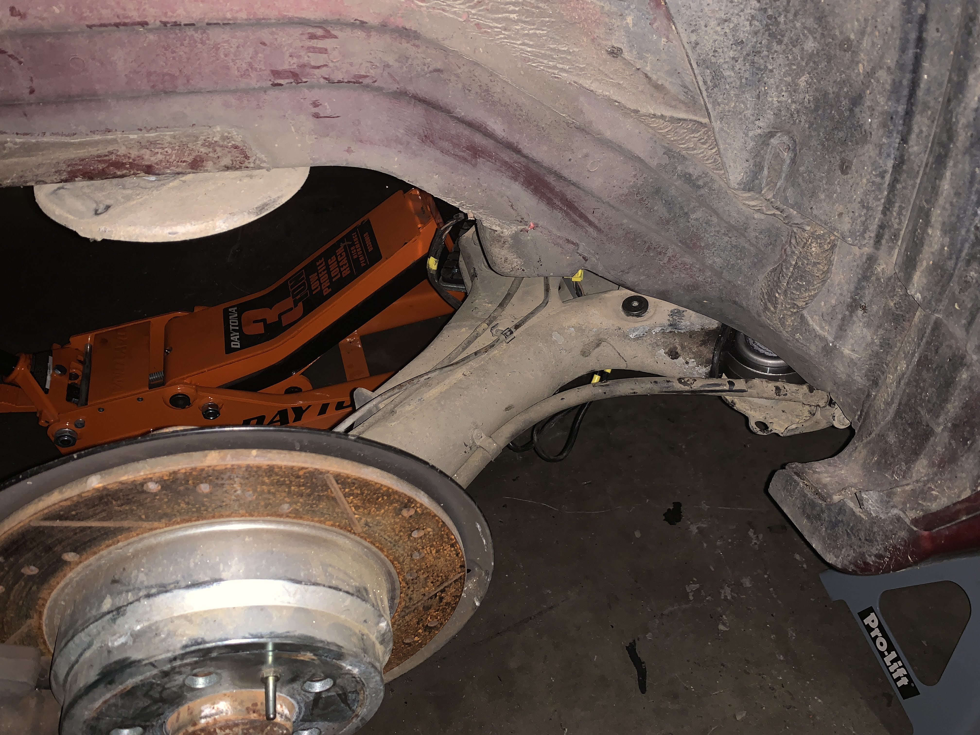

Changed the oil today and then went on to investigate the noise I'm hearing in the rear end over bumps. Turns out these brackets need to go! I've flattened my right rear brake line. It doesn't look like the delta link has contacted it on the left side, but the brake line is obviously hitting on the right side.
It's hard to see in the pic, but you can probably see the flat part. You can probably tell the bracket I'm referring to is the one right above the brake line. These are not present on FWD cars. Time to break out the grinder!
