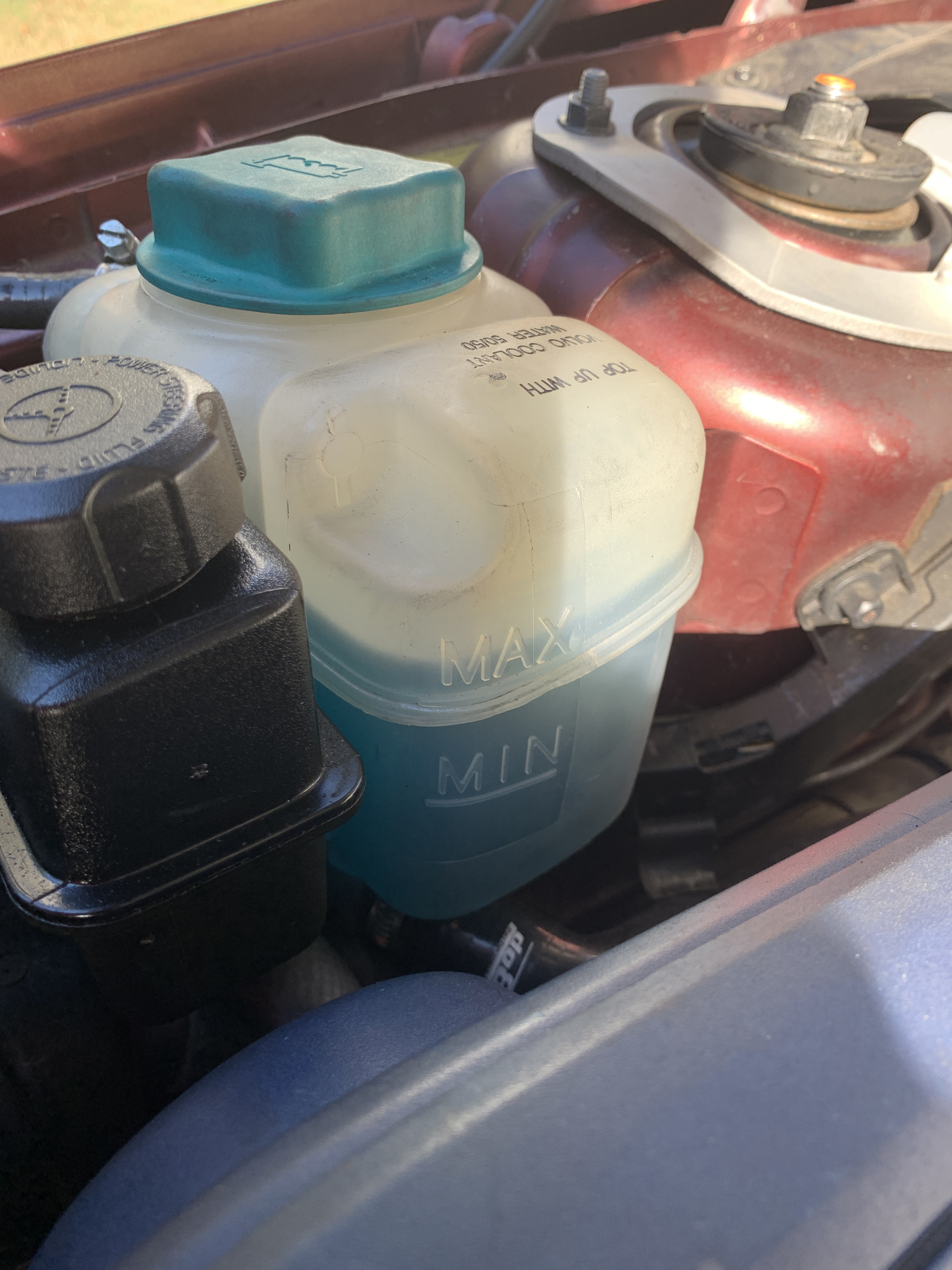

Changed my oil cooler hoses since they were likely original, also I wanted to do a flush on my cooling system. Ran a gallon and a half of clean water through before filling with BMW blue coolant. Same stuff as the old Volvo blue coolant, so might as well use the BMW coolant. Plus it’s easier to keep the whole fleet on the same stuff. I had Zerex G05 previously. No issues with it, I just like blue :D
I also replaced the turbo oil drain gasket and o ring. The o ring was leaking a little bit. Nothing major, but it was easy enough to replace it while I was down there.
