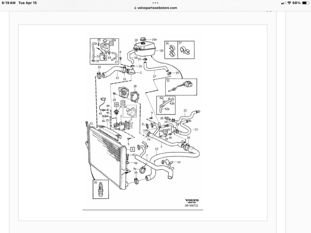

Could you add a red arrow to these for the education of the masses?
- Posts: 36162
- Has thanked: 1611 times
- Been thanked: 4075 times
Two M6 bolts slide into that pipe where the yellow arrows point..,
Tough to access.
Tough to access.

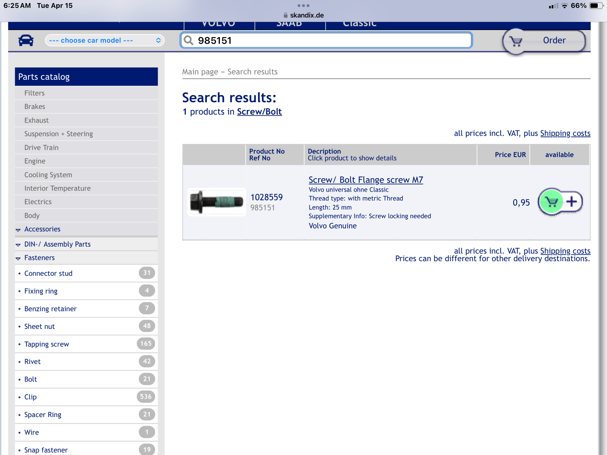

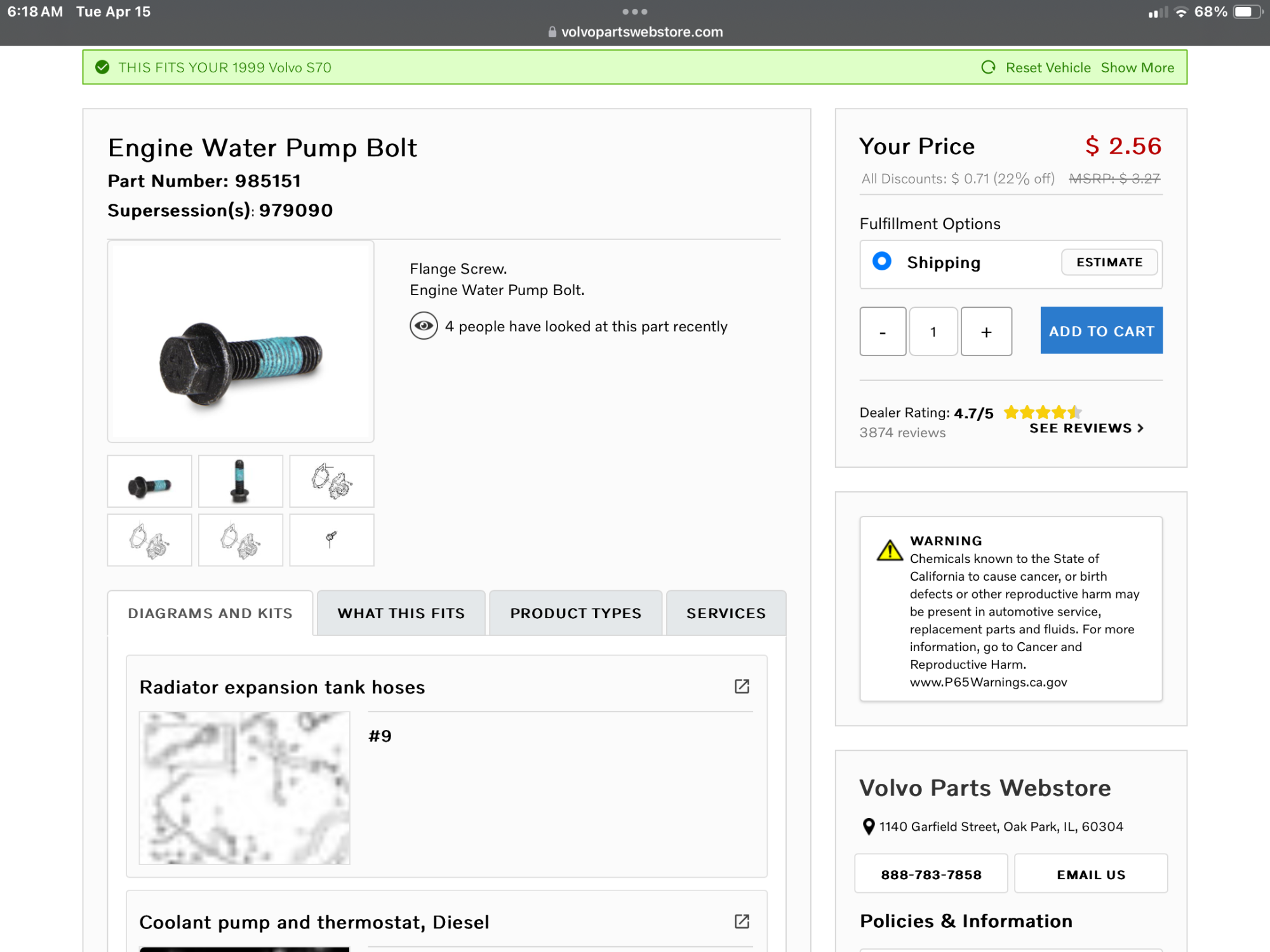

You have to use the right bolts as the holes are blind , so too long a bolt won’t seal.
I’ll double check but I think they are the same as water pump bolts.
Confirmed. Part number 985151 fits both the water pipe 2x and water pump 7x
Skandix tells us M7 x 25mm length
Part #9 and #29 below

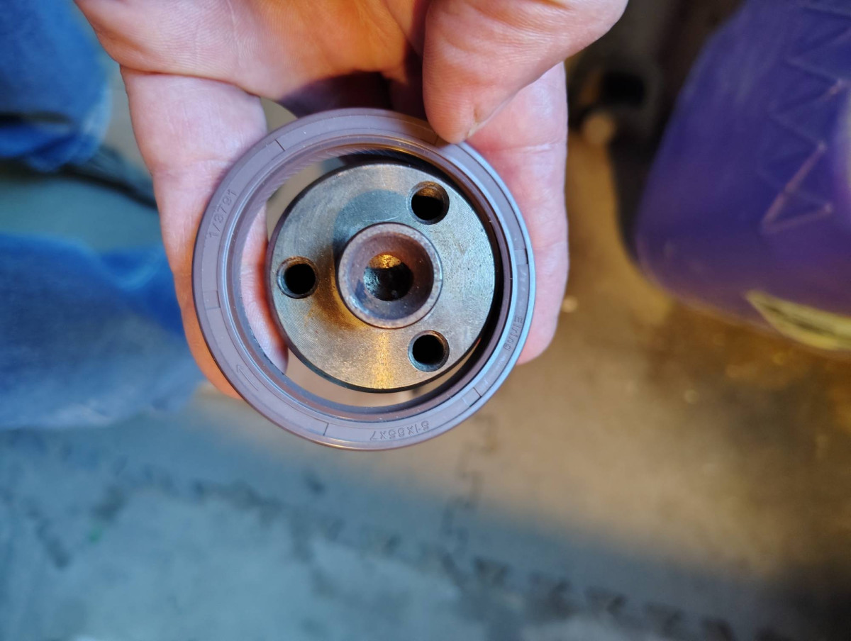

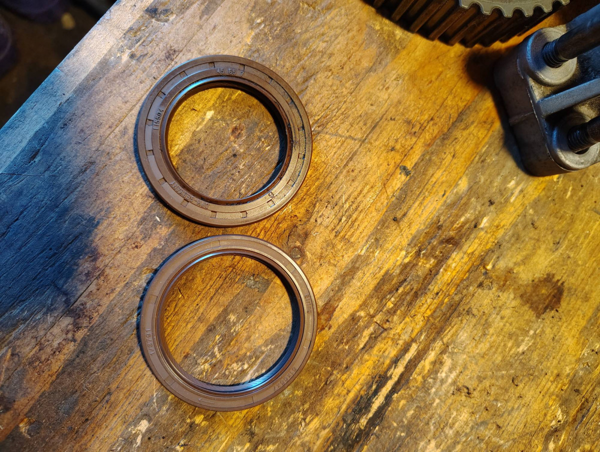

Hit a little bit of a speed bump today. I think this will leak.
" Confirmed Fitment " front camshaft seal # 32402269 ( Elring # 135151 ). Near as I can tell, I ended up with # 9458309.
I checked the size of the original : 45x65x7
Size of what I got : 51x65x7
So is this just one of those '99 things ? It wouldn't be the first time I have found a couple of listings for the same part with no reference to vin #.

Your GLT has VVT exhaust so it takes a different size cam seal than the rest of the P80s
I’ve got those too. Did you get your water pipe gasket?
